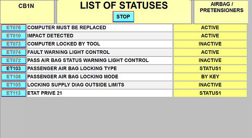

Hey Gaz,
I have uploaded a bunch of photos to this address: http://www.flickr.com/photos/80743382@N03/
If you can take a look that would be great.
One thing that I did notice that I may have overlooked is this.
Surely this ecu (the replacement) shouldn't be stating that computer must be replaced and that an impact has been detected?
Thanks again
Alex

Its a borneo1 vehicle so no tech sheet available. I actually miss the simplicity of these vehicles.
You're showing an impact listed which is why you can't do anything... its scrap pending the crash data being removed.

So much for this being out of a "undamaged" vehicle then.
Should be a simple case of sending this off, getting to get the crash data cleared, then all should be good to go?

Yeah because scrap yard owners and ebayers never lie do they?
Have the unit re-virginised for around £25 or buy another from a car in a scrap yard that you can see has no bag or inertia reel deployments.
