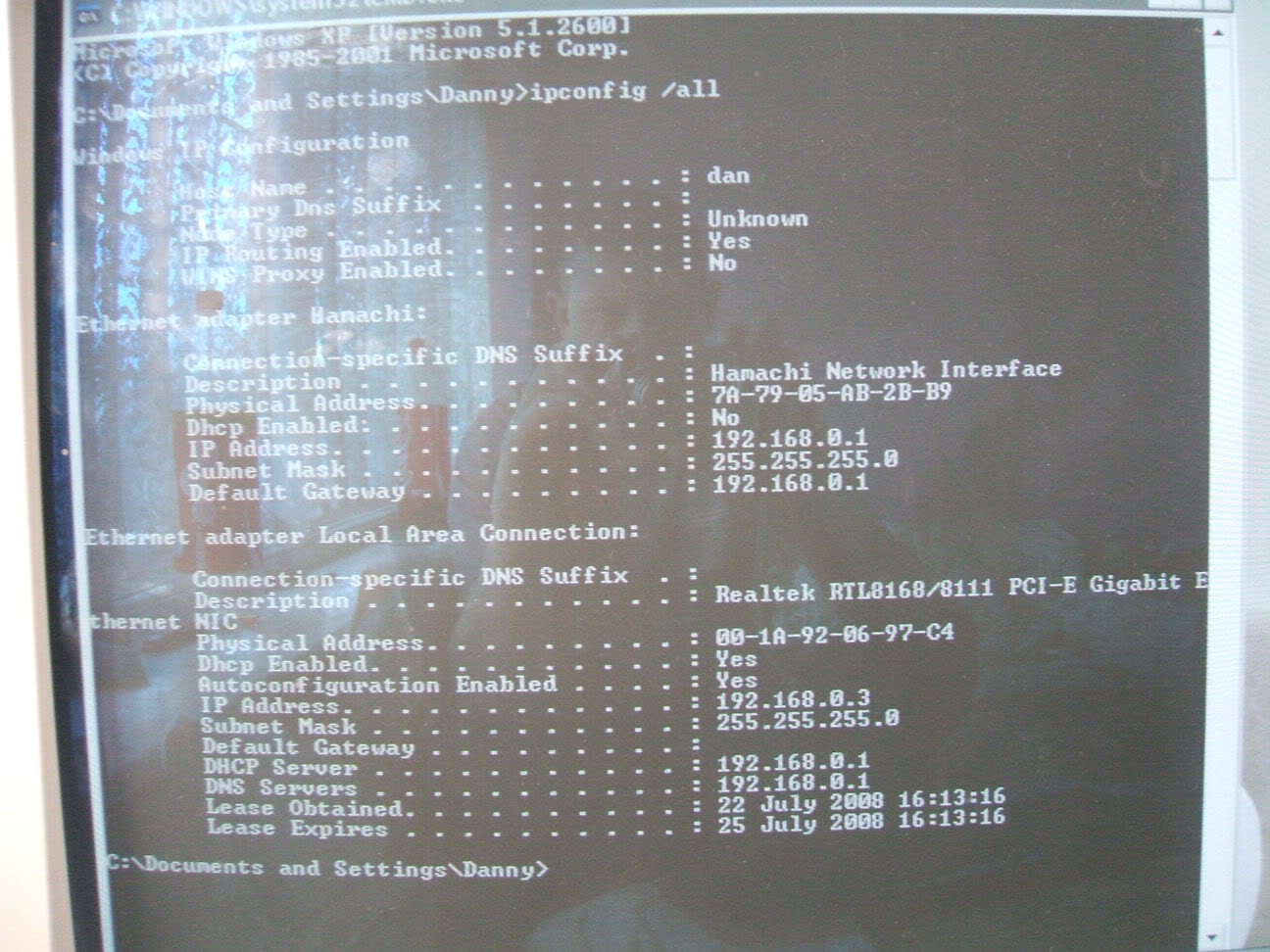

this is what ive got typed in to the pc atm
IP 192.168.0.3
Subway 255.255.255.1
Gateway 192.168.0.1
DNS Primary 192.168.0.1
comes up connected but aint sending/receiving bytes

He can't access the internet from that PC hence this thread.

Try disabling / removing that! It looks like your computer is routed to go through that connection and not direct to your router.
The Hamachi Nic has ip address 192.168.0.1
The other nic, the realtek one, has it's dns as 192.168.0.1, therefore pointing to the hamachi.
Disable the Hamachi card and if your router is 192.168.0.1, it'll work ok.
disabled hamachi and the internet works now, woop, cheers sheen and sargey. (and daz n griff for trying x)
