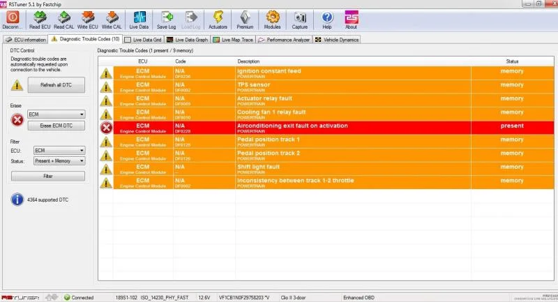

Received my RS Tuner today and read the faults (the car is going into limp mode, showing the electrical fault and emissions fault) and could do with some assistance on how to address them all!
  '04 Clio 1.4 16v

The limp home mode, it does it all the time regardless of the weather or engine temp. The rs tuner can't seem to wipe the faults or read any engine parameters, I'm not sure if that's because it's still locked? I'm waiting for the unlock code.

Cleared the faults, waited until it faulted again and read them and it's showing inconsistency between throttle tracks 1 and 2. Guess that'll be a fault in the loom somewhere then.
