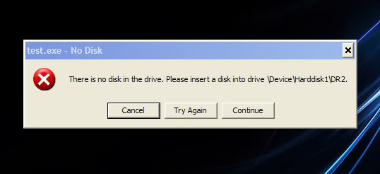

Hello,
This just started today, It pops up on startup, and I cant get rid of it ! If I do make it go away, it pops back up in a matter of about 30seconds !

  Liquid Yellow 182 FF
lol, I just had to find text.exe and I closed it, problem sorted, just need to remove the b*****d
any idea on how to get rid of this thing, its pissing me off now. Some people say its not a virus on a PC forum im part of, and others say it is?

Ive removed it from my starup, also, Ive ran registry cleaners, ran the disk error check , defragged. I am using F-Secure 2008 atm, and I have done a scan and it found and removed 3 viruses, yet this thing still comes up.
