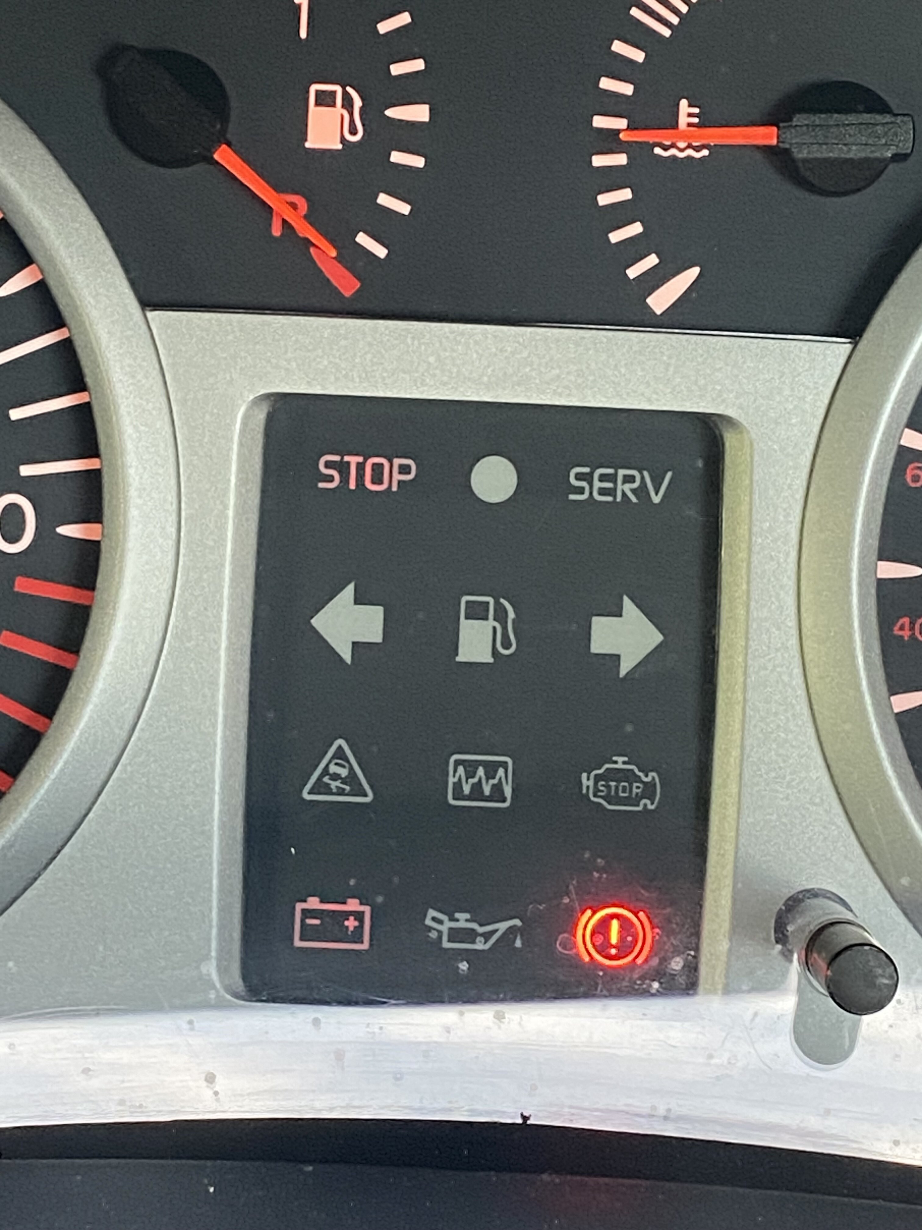

After starting her up in the garage I noticed that I had a dull flicker on the dash as mentioned above, worse when the lights are on and the dash goes back to normal when rev’ed

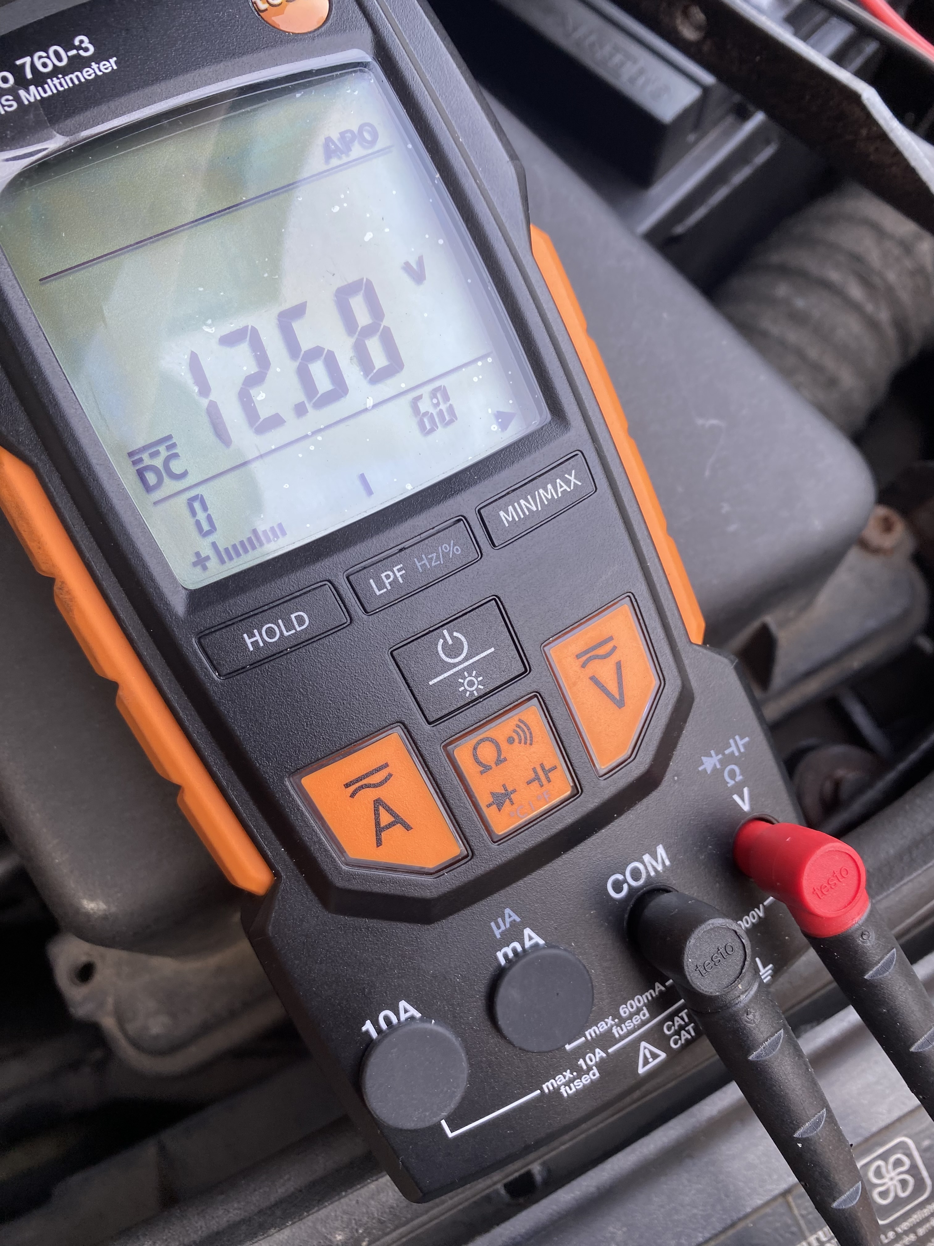

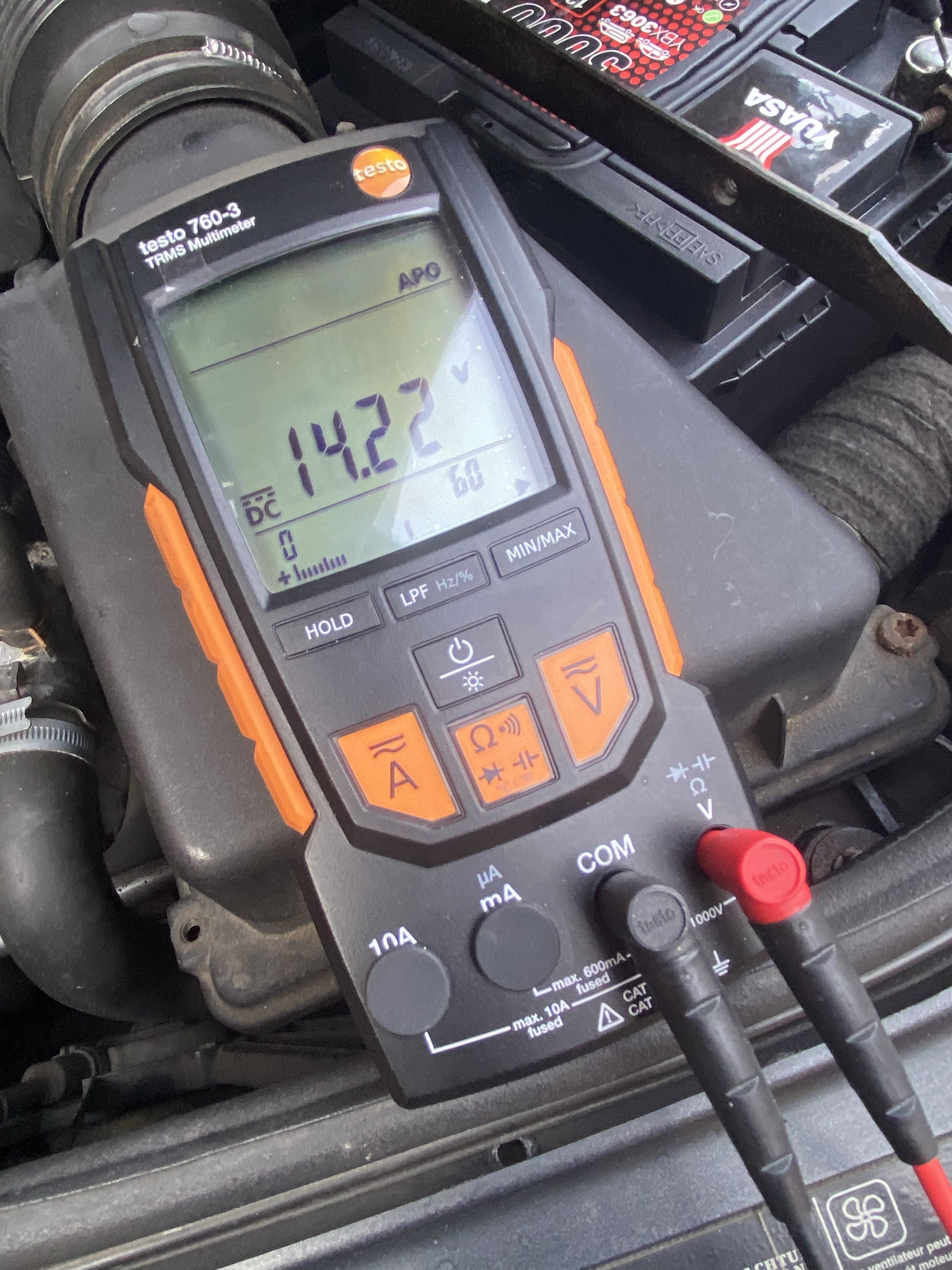

Got the multimeter out and she is reading 14.2 dc when running
I have included a couple of photos

Not sure if you got this sorted, but my 182 was doing the exact same thing and I struggled to find the problem. But it turned out to be warning sign that the alternator was slowly on its way out
