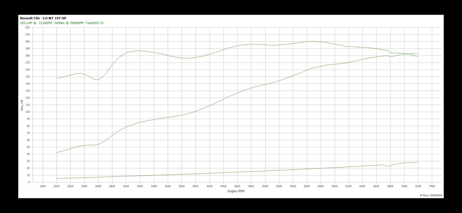

Fair play. For reference, here’s a dyno plot of mine.
You can see the big dip low down. The reality is it’s probably even worse than that, as the plot is smoothed.
If there’s no fault codes it’s very unlikely that you actually have an issue.

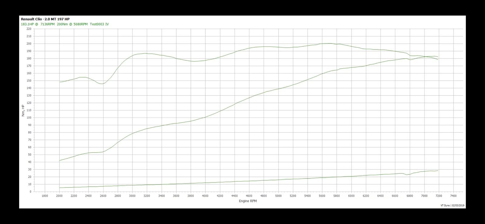

Quite pronounced, that.. good visual.. no fault codes so perhaps you’re right - just doesn’t feel right at all. Will look at joints/seals on sensors as suggested. Cheers!
