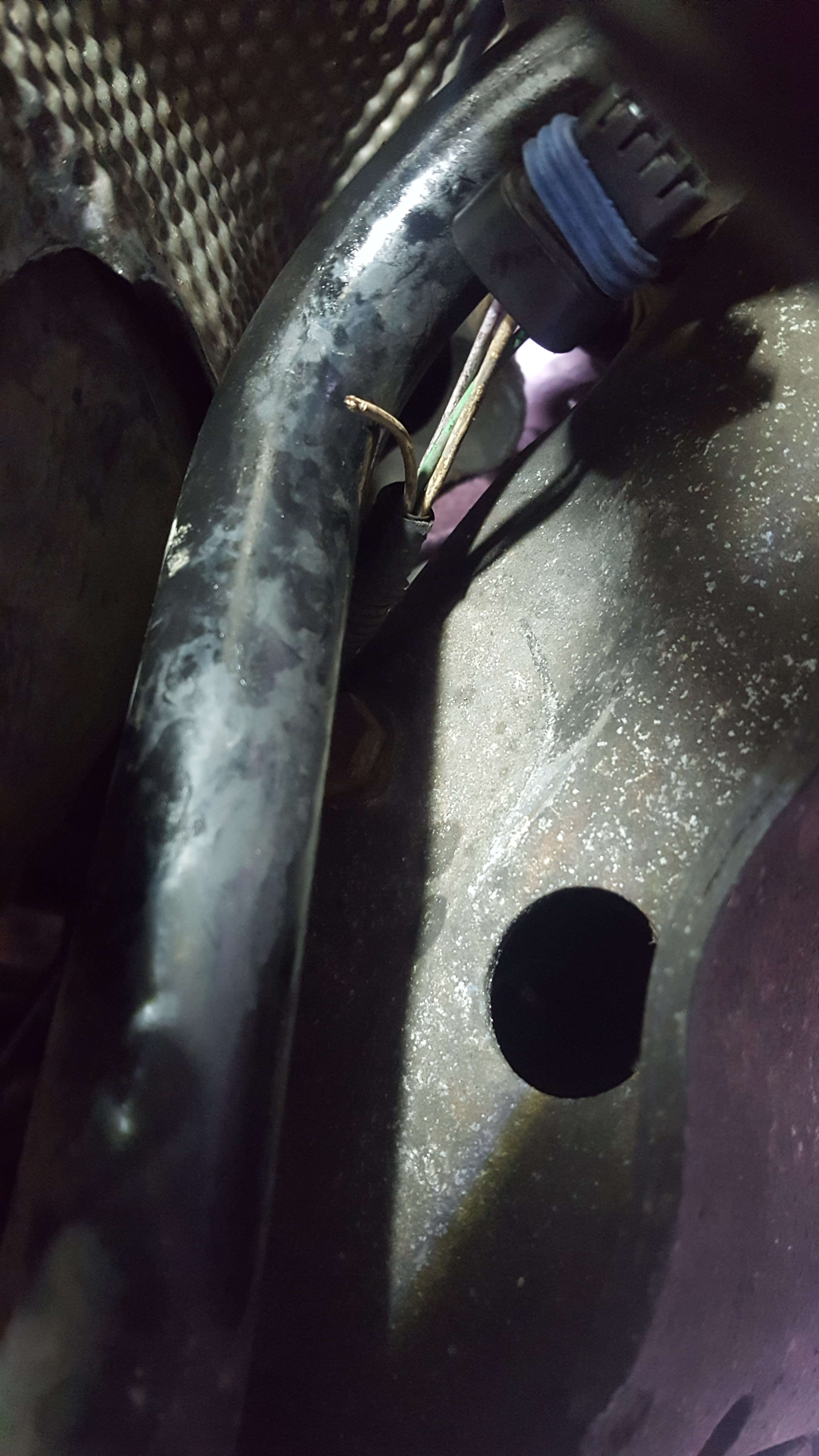

Looks like heres my problem.. ☹
Broken wire to plug on loom side.

Just a little update.
I repaired this broken connection earlier by bypassing the plug and soldering in a length of wire. It's definitely a bodge as I ended up soldering with a lighter, as wasn't at home with my iron.
Took it out for a short local 2 mile or so run afterwards. Definitely felt an improvement but still some hesistancy although 50% better at this point.
Gave it a quick boot hru 2nd and it's back to missfiring again. I bet i managed to disconnect my bodge. 🤣
