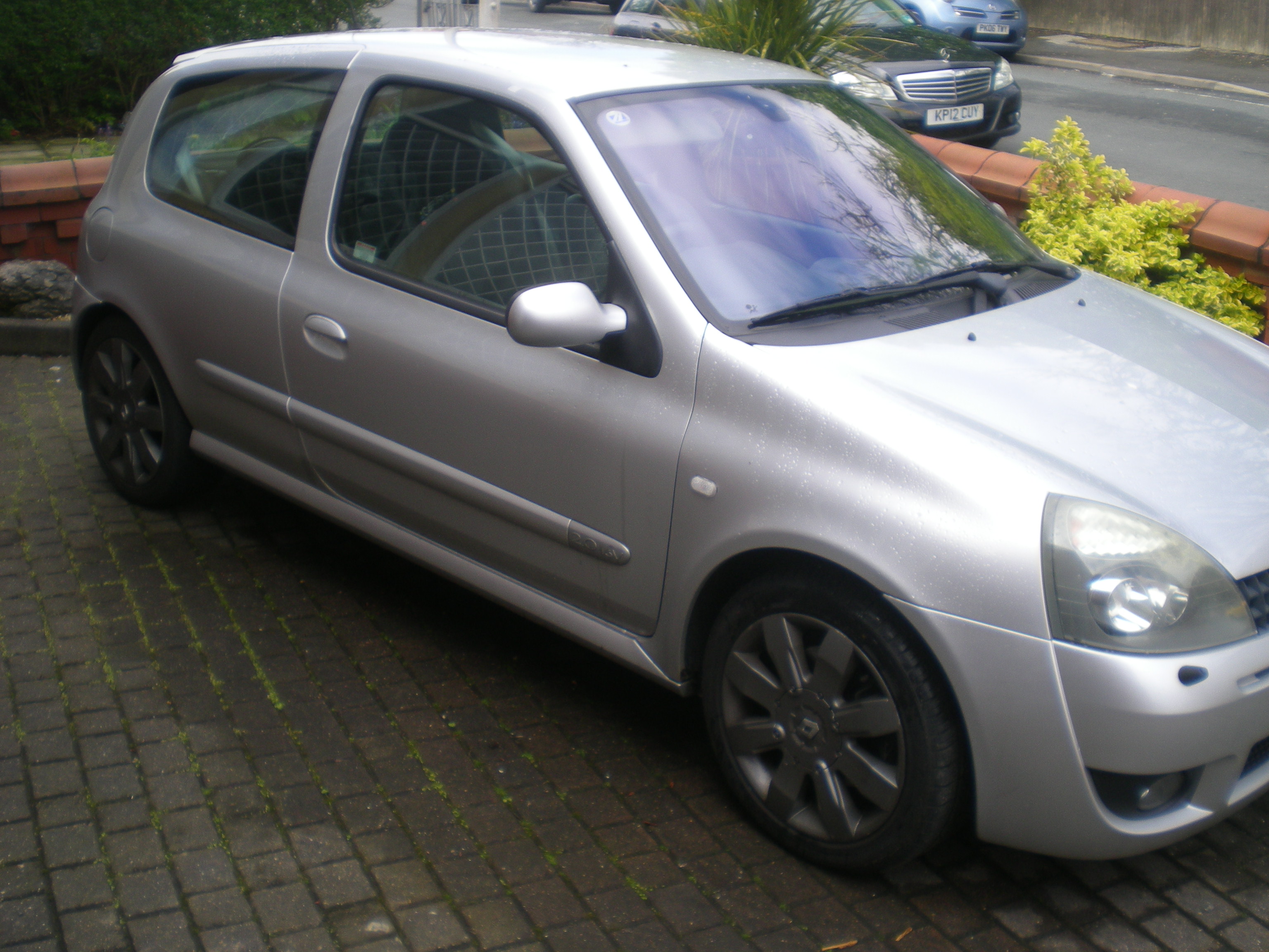

Welcome to the forum pal! What colour is your 182? I've been seeing a new BG around alot recently, given the driver a few waves but nothing back so far!
  182
Thanks for the welcome mate, silver in colour and i bought it off a lady owner in Thornton. :smiley:
