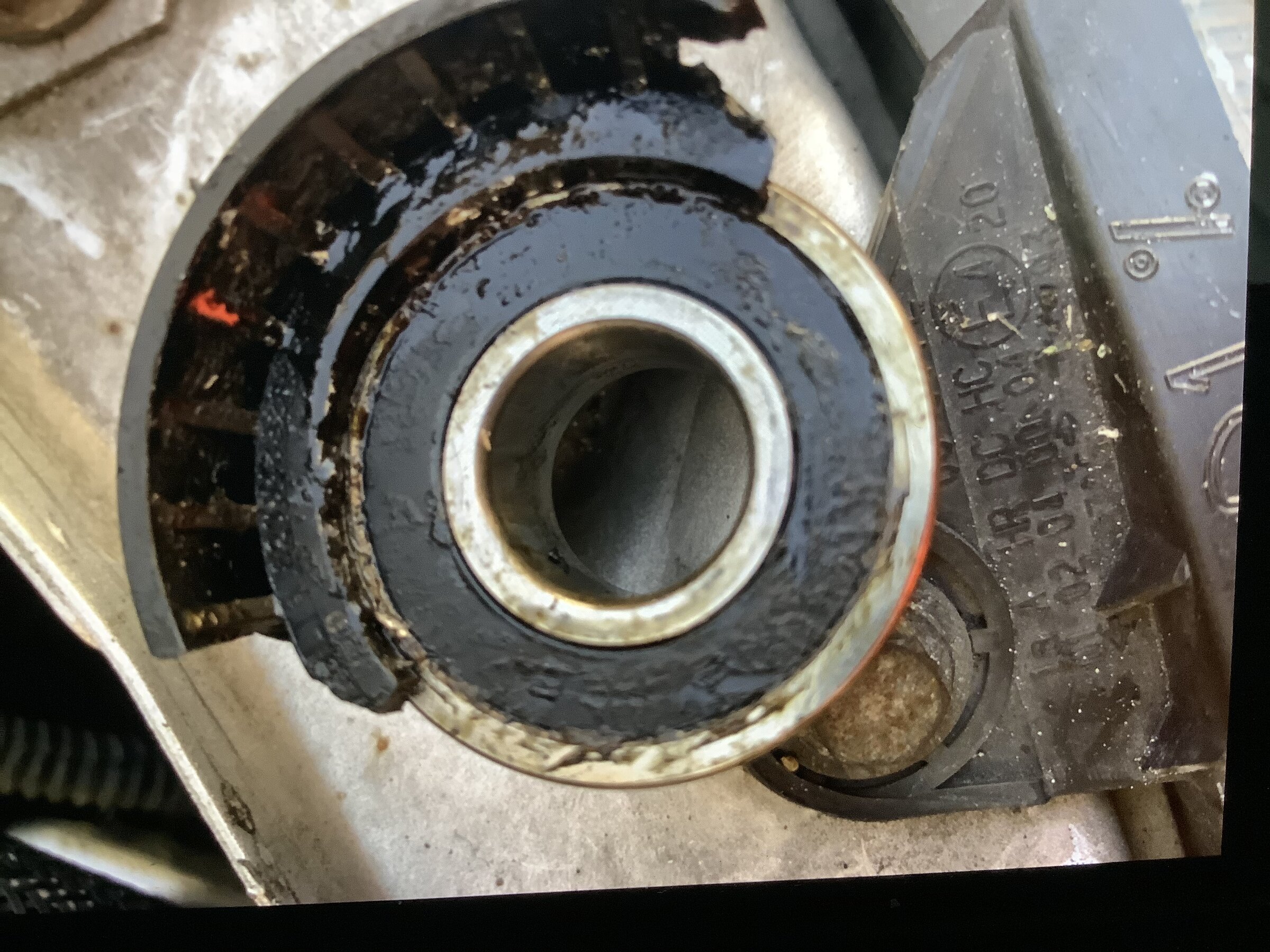

  Clio 182, Mercedes,
Ok so striped everything down and here is the guilty party 🙄 so tomorrow night I’ll be lapping in the new valves 😂
