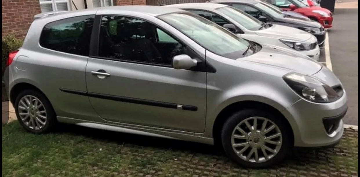

rennoob Car renault clio Aug 31, 2020 #1 i have a 1.2 turbo 07 Clio just wondering what can be done to this little best also will the club front bumber fit

YorkshireKyle Not all gingers stink of piss. But I do. ClioSport Club Member Car 535d & Monaco 172 Sep 1, 2020 #2 Lower it and put some wheels on. Then shoot for a bit more power, the 1.2 D4FT in these can push 140bhp with a few simple mods

Martin_172 ClioSport Club Member Car 182 RaceVan / 197 Sep 2, 2020 #5 182 injectors and down/up/across to EFI parts for a remap for 140hp. Add a front mount intercooler and decat if you want to push towards 150hp
