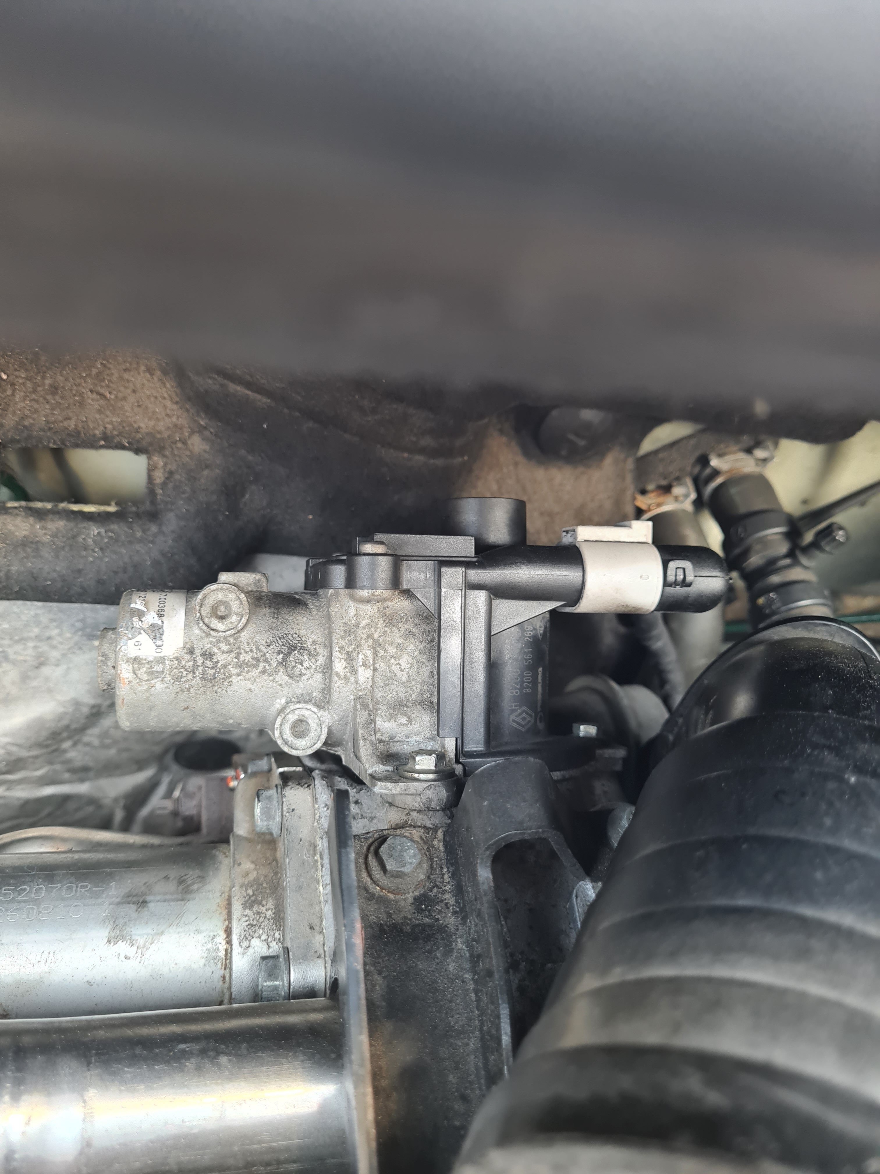

It happens when the car is off. For example. The car was off for 4 hours. I go outside and the noise is still present.

@Olliebeal just swap your ECU relay and the heated screen relay around. My sisters MK3 used to keep the ECU energised with the key off because the relay was fucked, never drained the battery because she was always driving luckily. One day I borrowed it and wondered why the boost solenoid was still humming after 45 mins 😂 I've got a spare fusebox for one here too if you need that

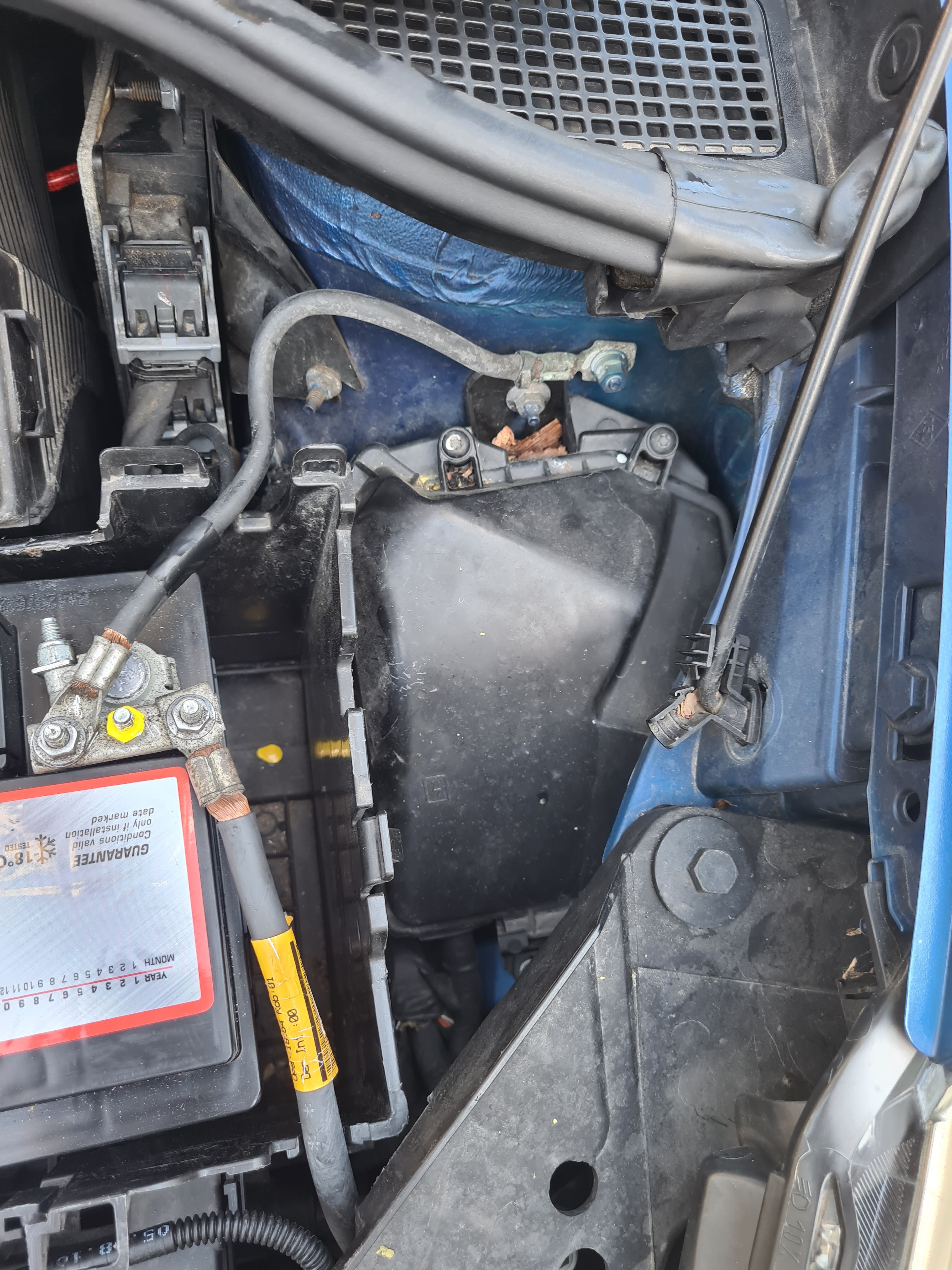

This isnt a video but the noise comes from the egr in the first picture and a clicking in the black box on the second

The humming will stop with the key out. The relay is stuck on rather than clicking off so the EGR will still be getting power with the key off

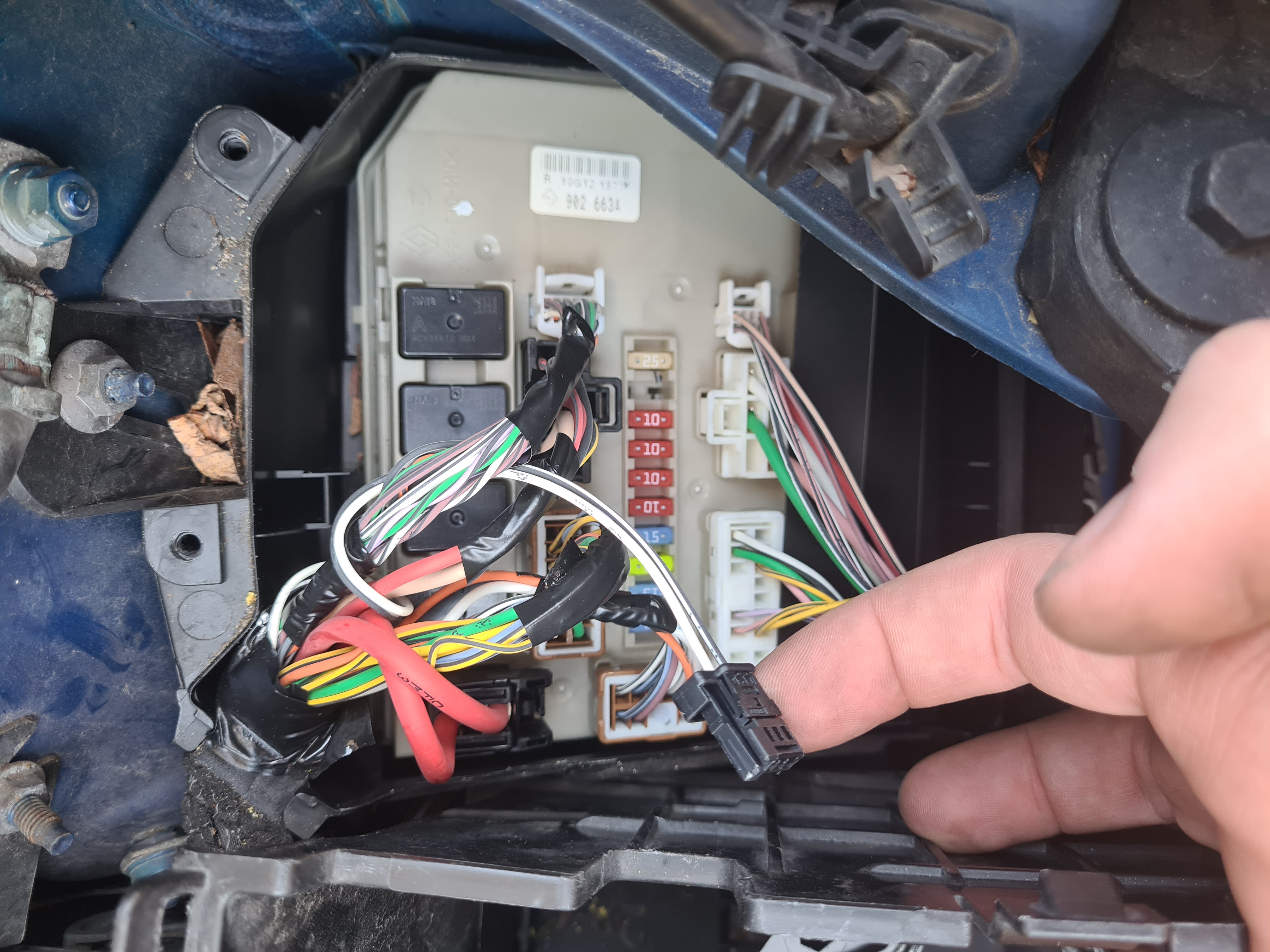

Ive got into the fuse box. This connector is loose with no where for it to go what relay is it
Aye that's normal I'm sure they just made 1 loom for every K9K MK3
You want to pull out those black relays until you stop hearing the buzzing noise from the EGR then replace the one that's buggered mate
