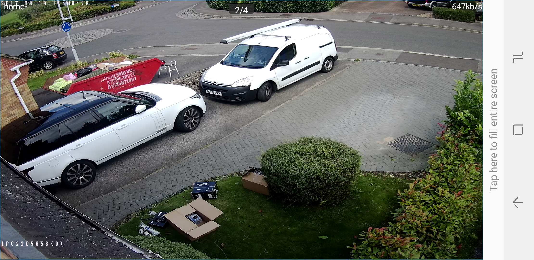

Just had them fitted. Very happy with them.

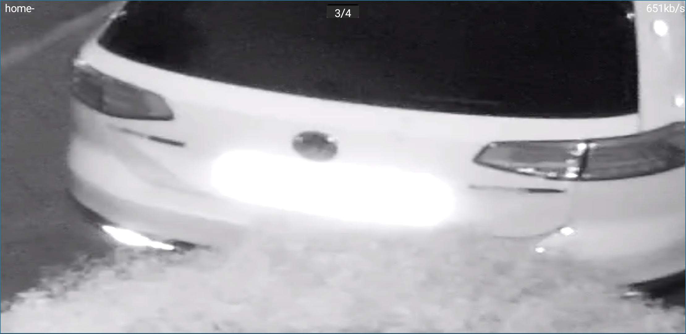

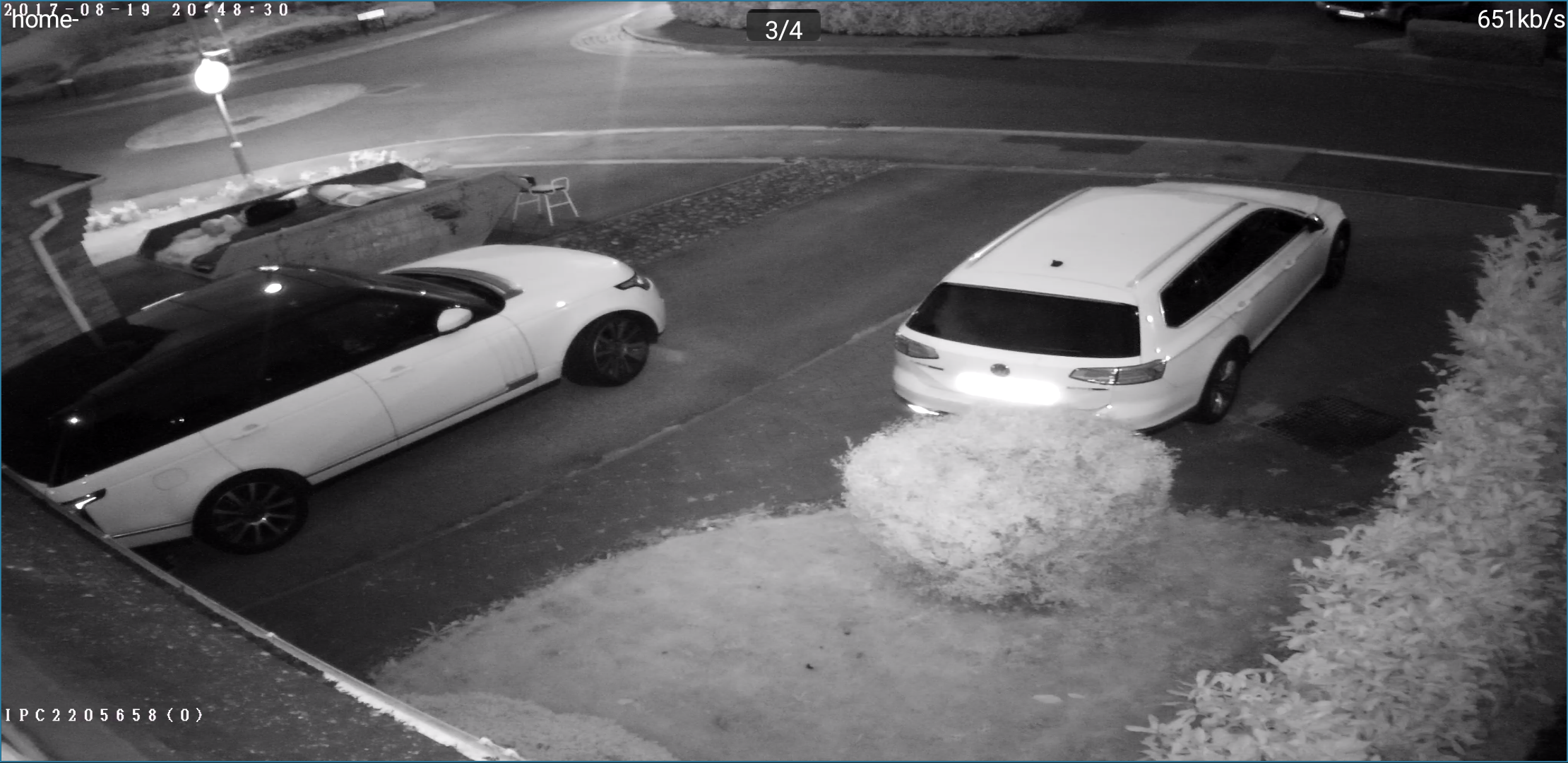

Has someone been naughty and put that spray stuff on it that makes speed cameras not pick your numberplate up? Dont knkw how thatd even work though without a light source nearby or wether that stuff even works at all.
Herr Flick
aka Herman Ze German
Number plate is reflecting infrared from the cameras, common problem
A problem that can be sorted??
I have to say, I'm not very impressed with the night view. Could make out my face in the back garden or driveway. Seems a combination of lack of quality and over exposure.
Mr Trailer Man
I'm guessing the angle of which the IR light is hitting the plate is the problem.
Mounting the camera lower down looking more straight on to the plate would probably help.
Might be able to tweak a few things in the settings, things like wide dynamic range.
  182, SQ7, Trafic
Unfortunately not!
They don't seem to be as good as hikvision ones at night, I'll try get a picture
