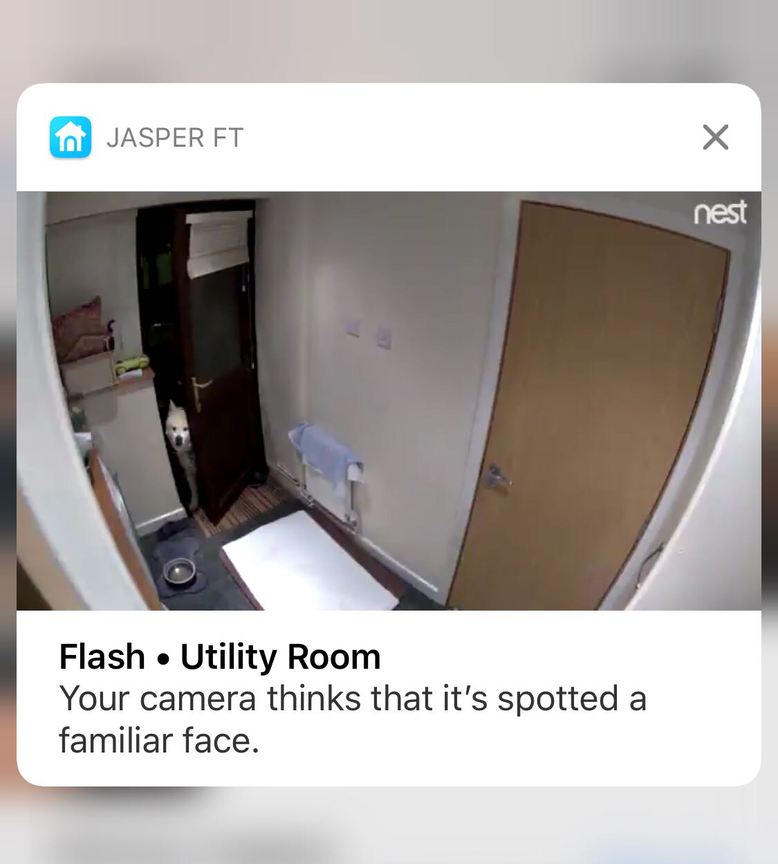

My friend has installed a nest camera, and I’m sold.
The simplicity of setup, I.e buy a camera, screw it to the wall a get power to it, and the ability to have alert zones on your phone (you draw boxes on the screen of the cameras view and setup alerts when you’re not home for certain areas), have sold me on it.
I don’t even mind the yearly fee given how good it is

A friend of mine works for nest and has shown me it. Feels expensive for what it is but when you consider the tech, plus cloud storage and how scrolling through previous footage is as easy as it is and like you say - not having to f**k about with your own hard drives before it works is a compelling package.

It is expensive, but I think as you say, simplicity and the quality of the UI is brilliant. You can tell in seconds any time someone has stood on your door step for example and even talk to the amazon delivery man. It’s epic!

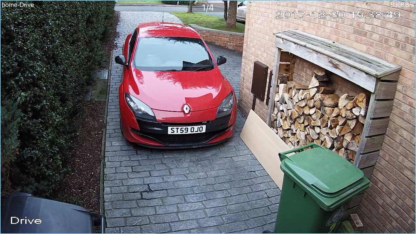

I’ve got HiKvision 4K at mine running 4 cameras. It’s a good bit of kit, do occasionally get connection issues via the mobile app and did have a camera s**t itself last week as well to be fair. But overall I’m pleased with it and you can get issues with anything.
