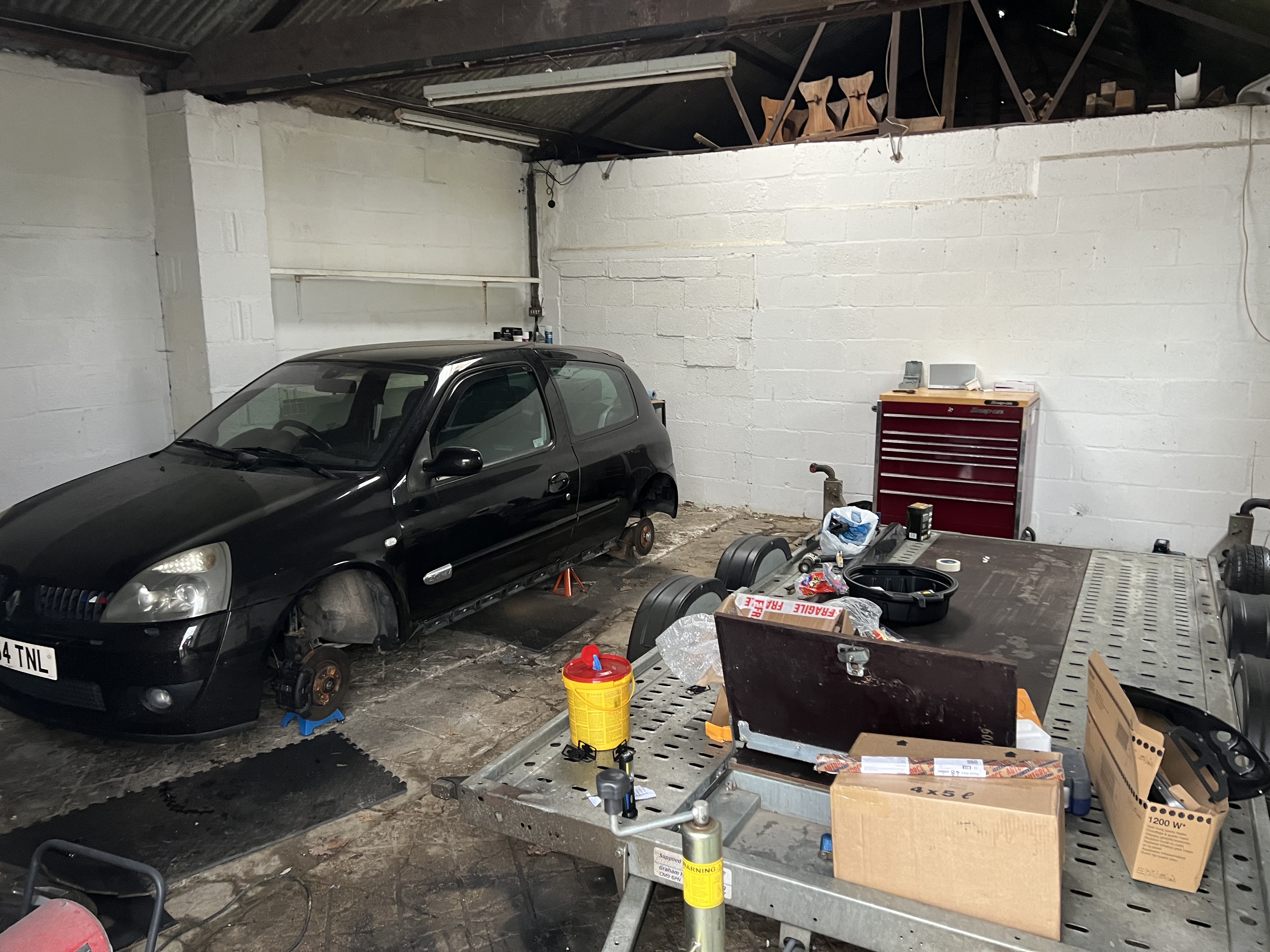

So a week or two ago, I managed to secure my self a little run down shack to tit about with cars. I am a serial car buyer, and I think it was going to become a problem for my neighbours at some point (although, they've never once had a problem with it). Also, laying on my drive in the freezing wind and rain was getting a tad boring.

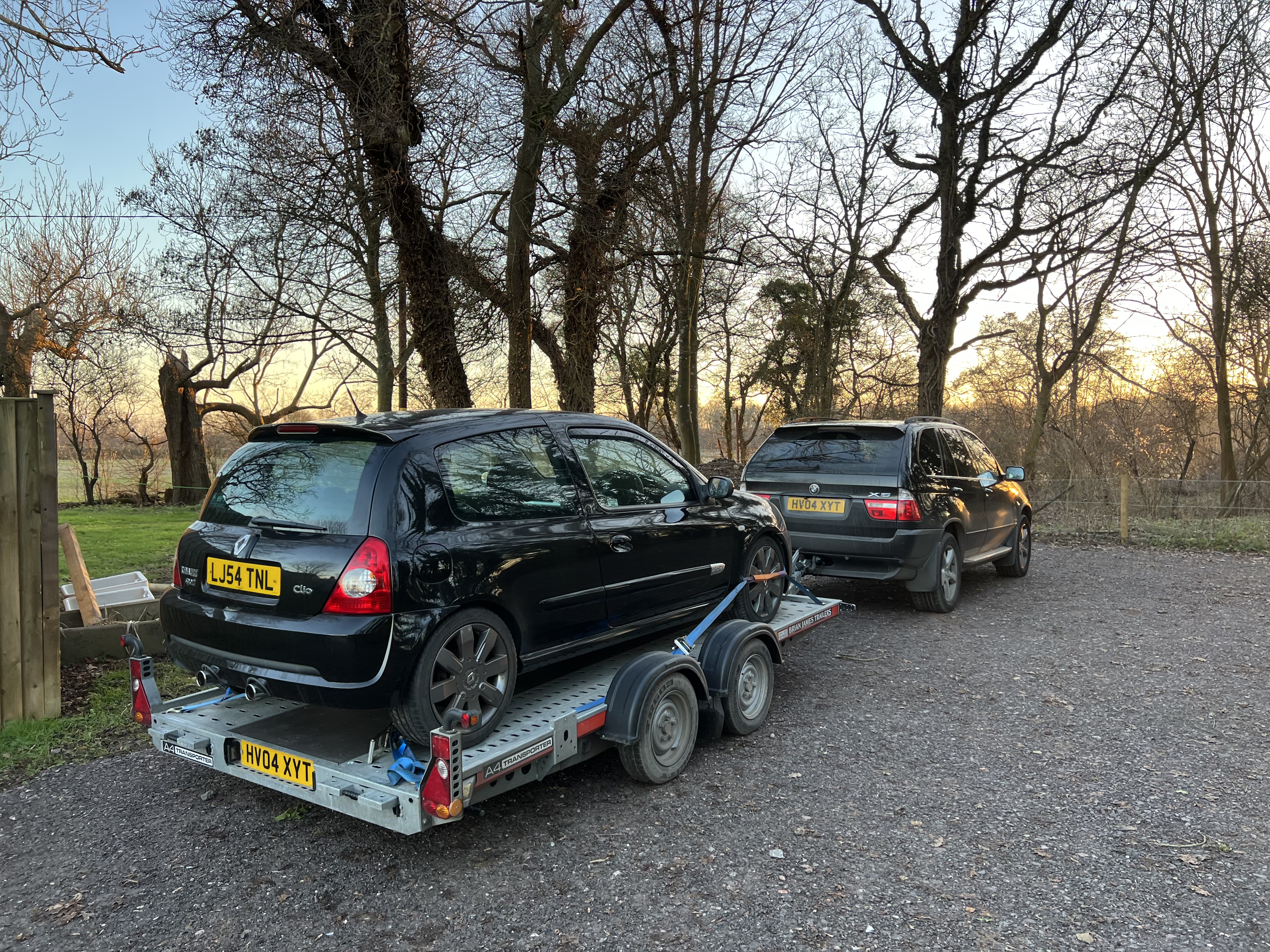

Anyway, as soon as I got this unit I knew what I wanted. A tow car, a car trailer, and a track car project. So as soon as I had the keys...

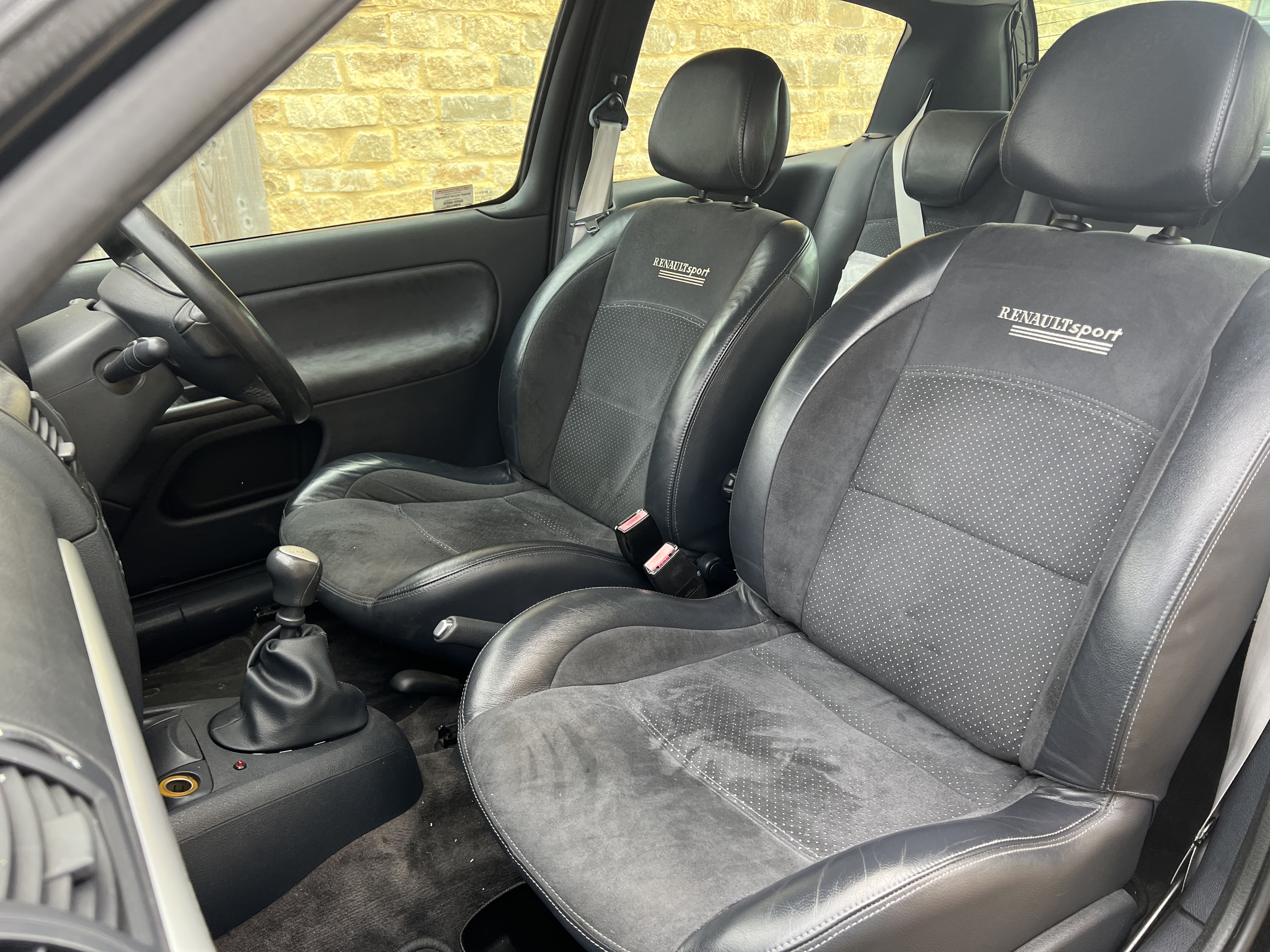

Not only was it cheaper than anything else, it was (on paper) really appealling. 89,000 miles, 4 owners and a stack of history. Mostly standard bar some springs, the exhaust and a panel filter. I just assumed it had some big hidden issue, the MOT ran out back in October and at this point the chap just wanted rid.
Obviously it needs Belts, an MOT and a few bits tidying up. However once I got it back and started tearing into it, I realised I COULD NOT use this as a track car. Its by far the cleanest I've owned, and dare I say it cleaner than anyone I've clapped eyes on in many years!

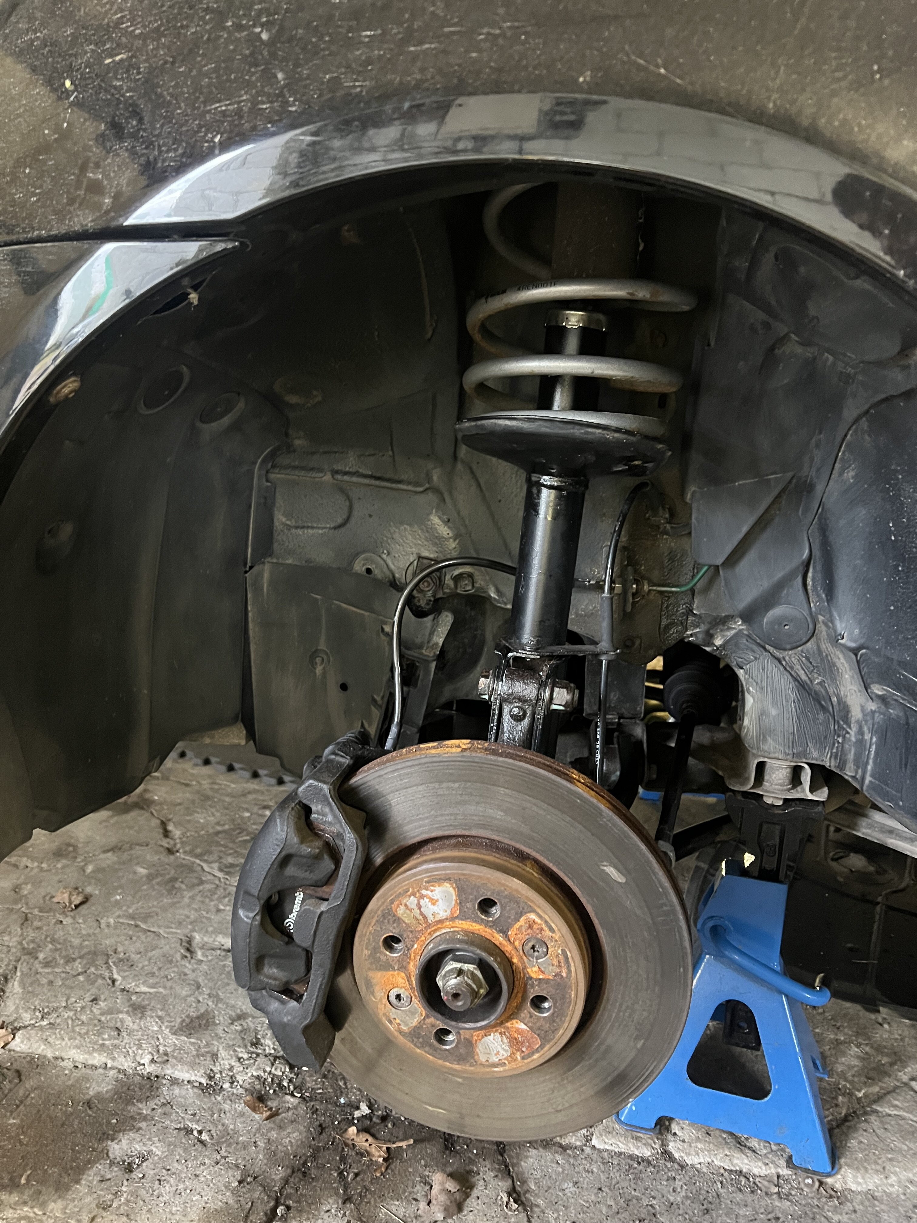

Then, there was the brakes. Had basically new pads all round. So I stripped those back, painted the calipers up and cleaned/re greased the pads. All working mega now!

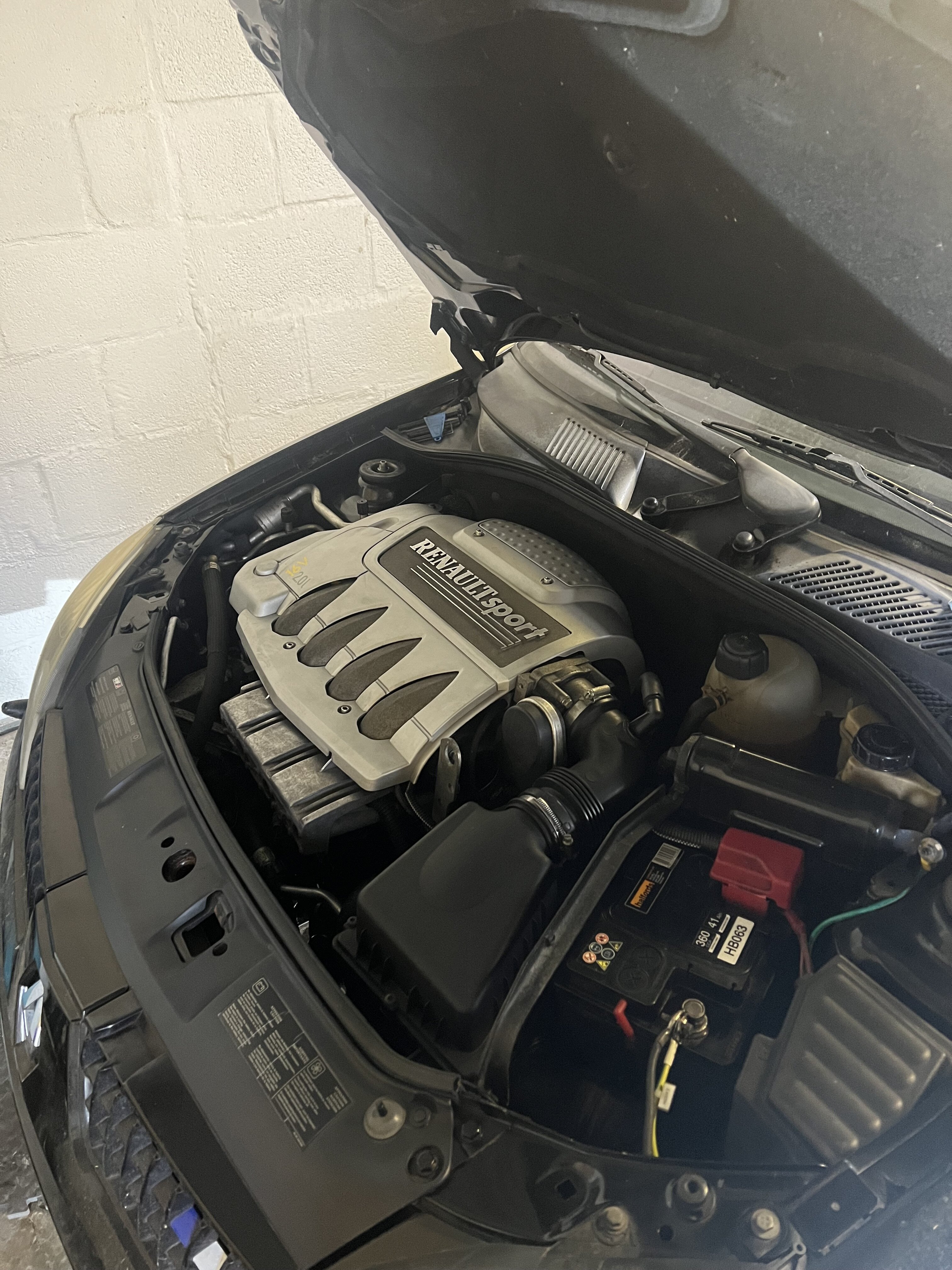

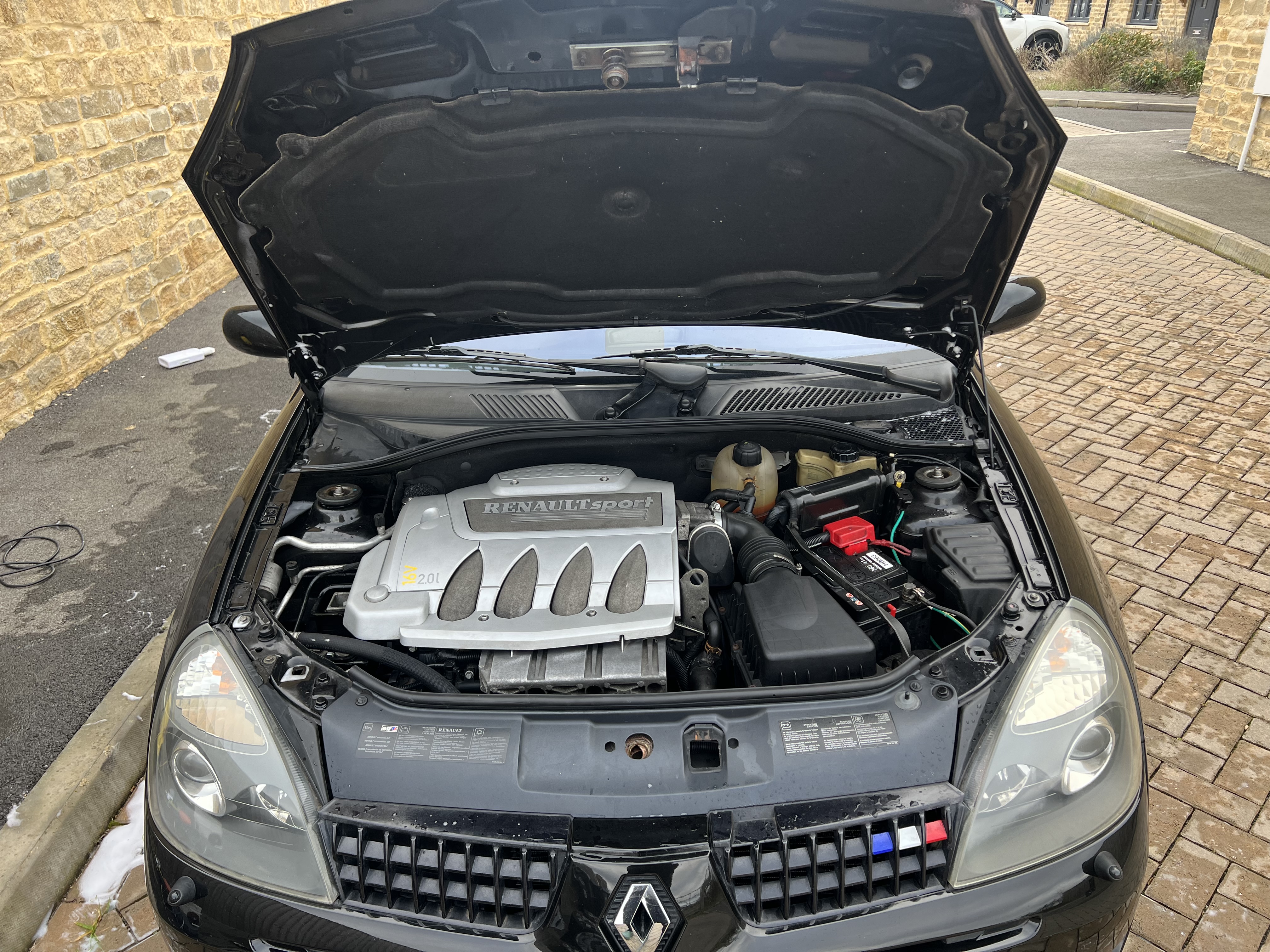

After a service, gave the engine a literal wipe down. No products, just some big wipes and a microfibre.

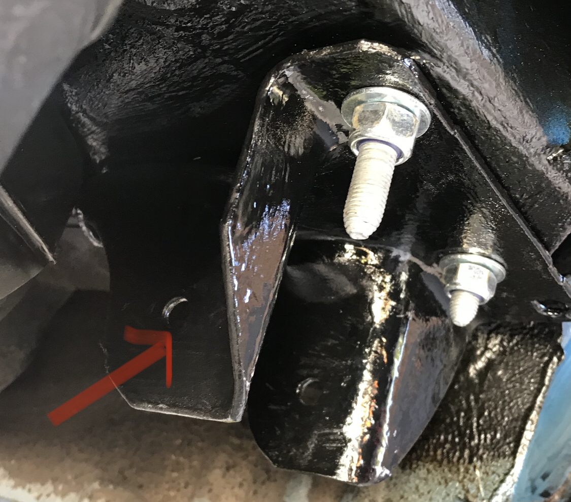

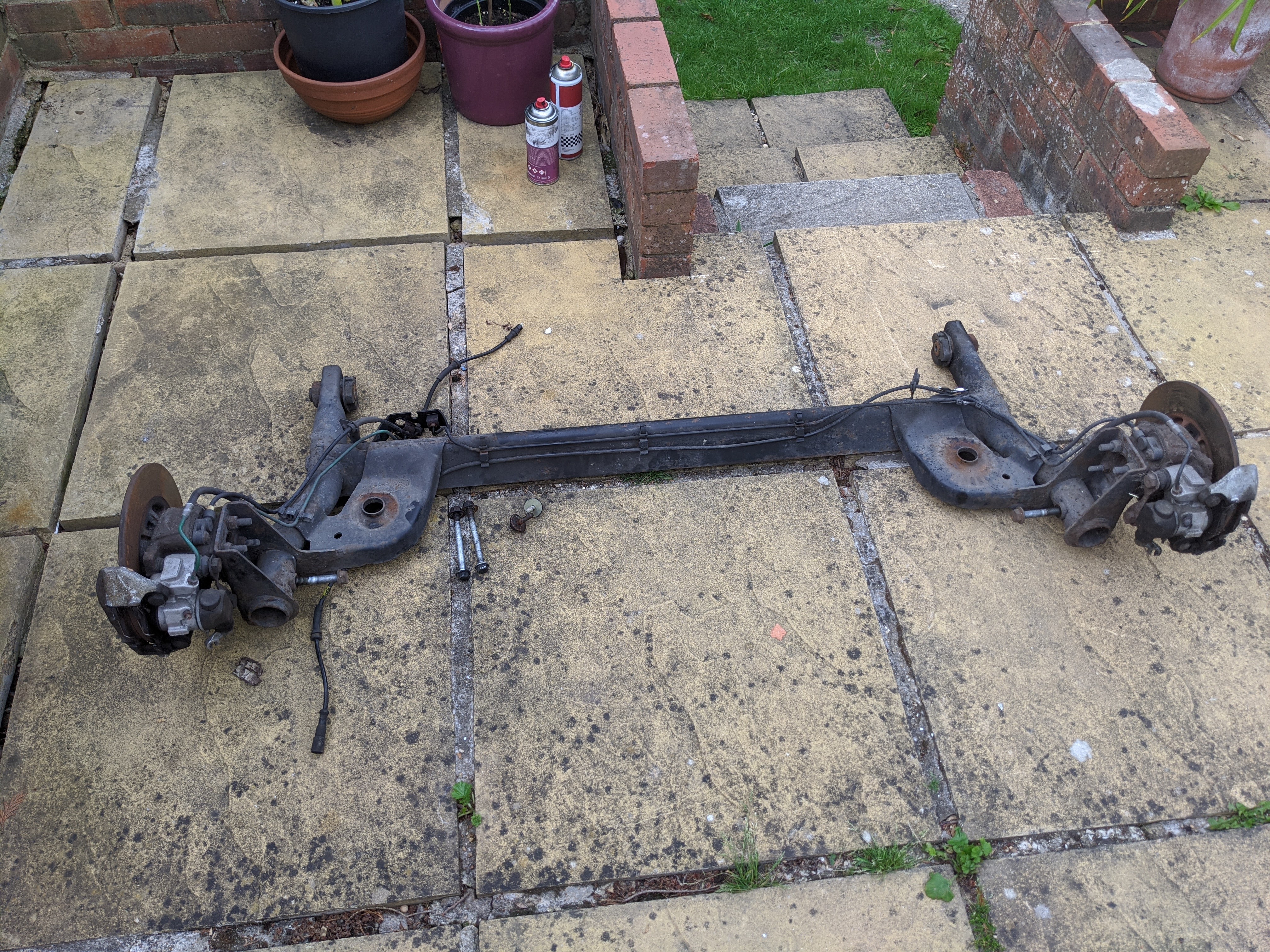

If you are serious about sorting rust you need to drop rear beam and tank. My car looked very similar condition wise to yours and I found quite a bit of surface grot around the rear beam area. Especially the stupid cavities by the rear upper spring mounts.
Rear beam is out within 30mins, such an easy job!

Yeah, thats probably going to be what Im doing on Monday. I got it soaked with the rust converter first, but I'll drop both and get all those areas. I also want to paint the rear beam which will be way easier with it on the floor.
Did you pull out the two long bolts to drop it?

Ive got some pictures in my project thread I think. I removed the two bolts and left the brackets in place which were in good shape.
I didn't want to bugger about with captive bolts spinning but I'm pretty sure you can access them from inside the car.
Having bean out lets you check brake lines properly, the ones that go between the shell and the beam are often done and it's a great opportunity to replace the rear beam bushes.
If you don't already have one I really rate the Milwaukee die grinders because you can get into all the tight spaces with them. Rust converter is alright but would still recommend grinding off any rust before you use it. They often leave a thick hard latex later after converting the surface of corrosion.
Doing the rear end was very satisfying because all the parts are easy to clean up and everything is nice and cheap.

Thanks for the tips mate!
I have a load of air tools from when I was on the shop floor. Pencil and die grinders too. So my next workshop purchase will be an air compressor!

Oh and does it affect the alignment of the rear at all? That'd be my concern, putting it back on and messing up the alignment somehow.
Touring_Rob
No, especially if you leave the rear hangers on.
It's very straight forward and honestly takes under an hour.
Up on axle stands
Rear wheels off.
Exhaust off from cat back
Brake lines clamped and undone at the flexi Handbrake cables disconnected at calipers ABS sensors unplugged
Undo shock absorber bottom bolts
Lower jack
Pull springs out
Undo long bolt each side of beam where the bush is.
Pull beam out and give ones self a pat.
Worth pulling the whole cat off if the car is outside, buying brake line clamps is far better than letting the master cylinder drain out
Highly recommend epoxy mastic 121 or similar if not having things powder coated.

Rear beam bolt on the driver's side won't come out with the tank in the way, will it?
I'm sure I had that issue with the two beams I've done 🤔
The bolt is like 100mm long.

Yes it’s doable as the bolt goes in and out this way.
Personally I’d drop the brackets as well so I can get at the grunge, but each to their own.

Sorry you are right, forgot that part.
I just dropped the corner of the tank enough for the bolt to come out, with rear bolts from tank undone there is just enough room.
Better yet drop the tank, which is also easy and gives you access to more of the rear cross member.

That’s with the tank in. I always add the brackets first, lift the beam into place, then insert the bolts and bush. I think 🤔😂 Only done 4 of them but you’ve got me thinking now 😂
😂 I can't picture how it would come out. Same with the Mk2 Meganes, although on them I think you can cut the bolt down and then put it back in from the outside.

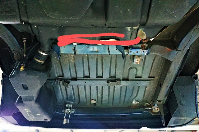

RustyMojo
Bon Jovi Officianado
They don't really rust above the tank I don't think. Mine was sound. It's just that cross member, or rather behind it which the tank covers. Mine was fine so just lashed it all in dinitrol.
Here:
They do..albeit it’s generally very light surface rust. However if gives you access to the rear cross member which does rust, also dropping the tank gives you access to two pockets (either side of the tank) which get absolutely filthy and do rust. I’d 100% drop the tank every time.

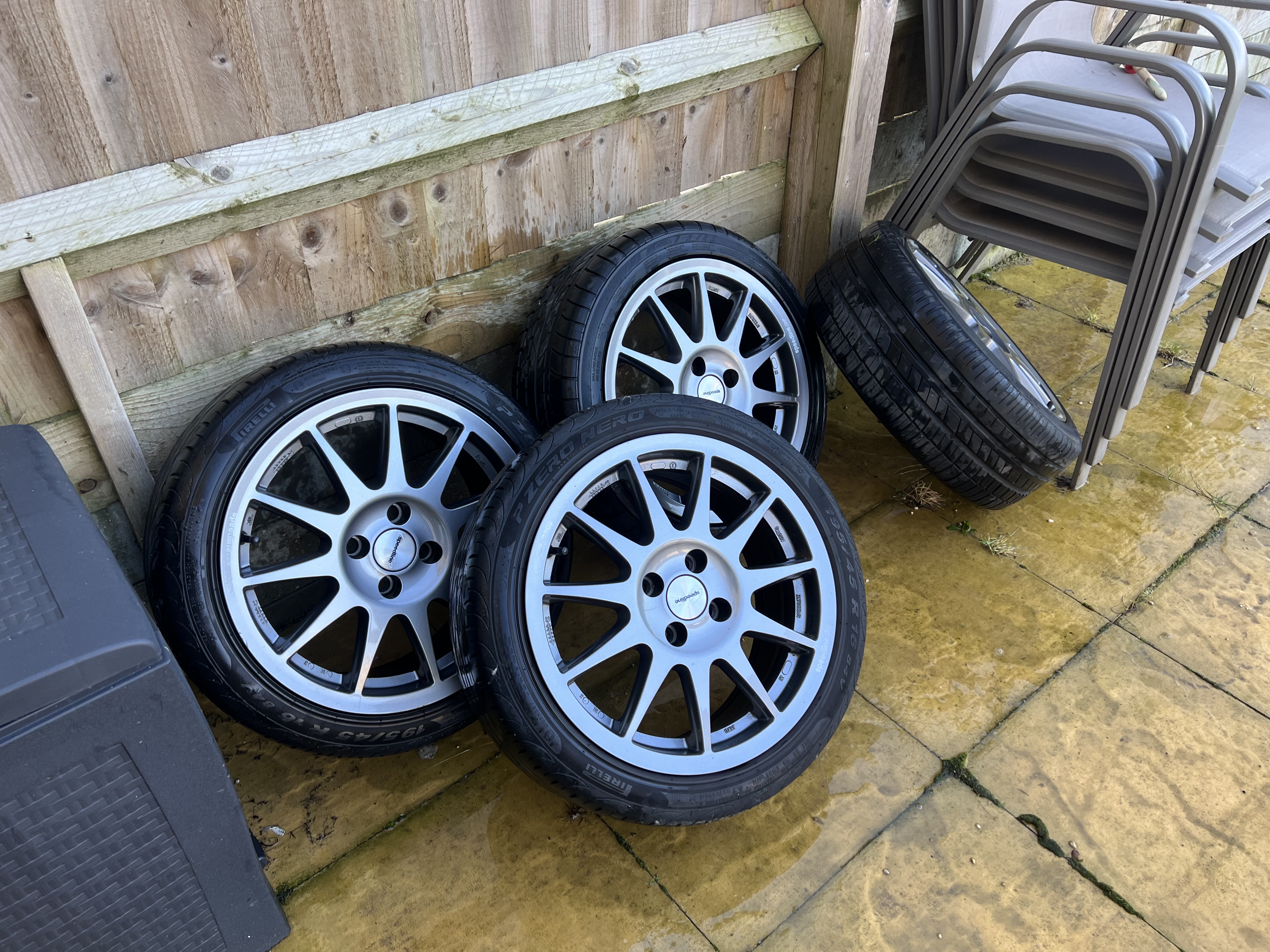

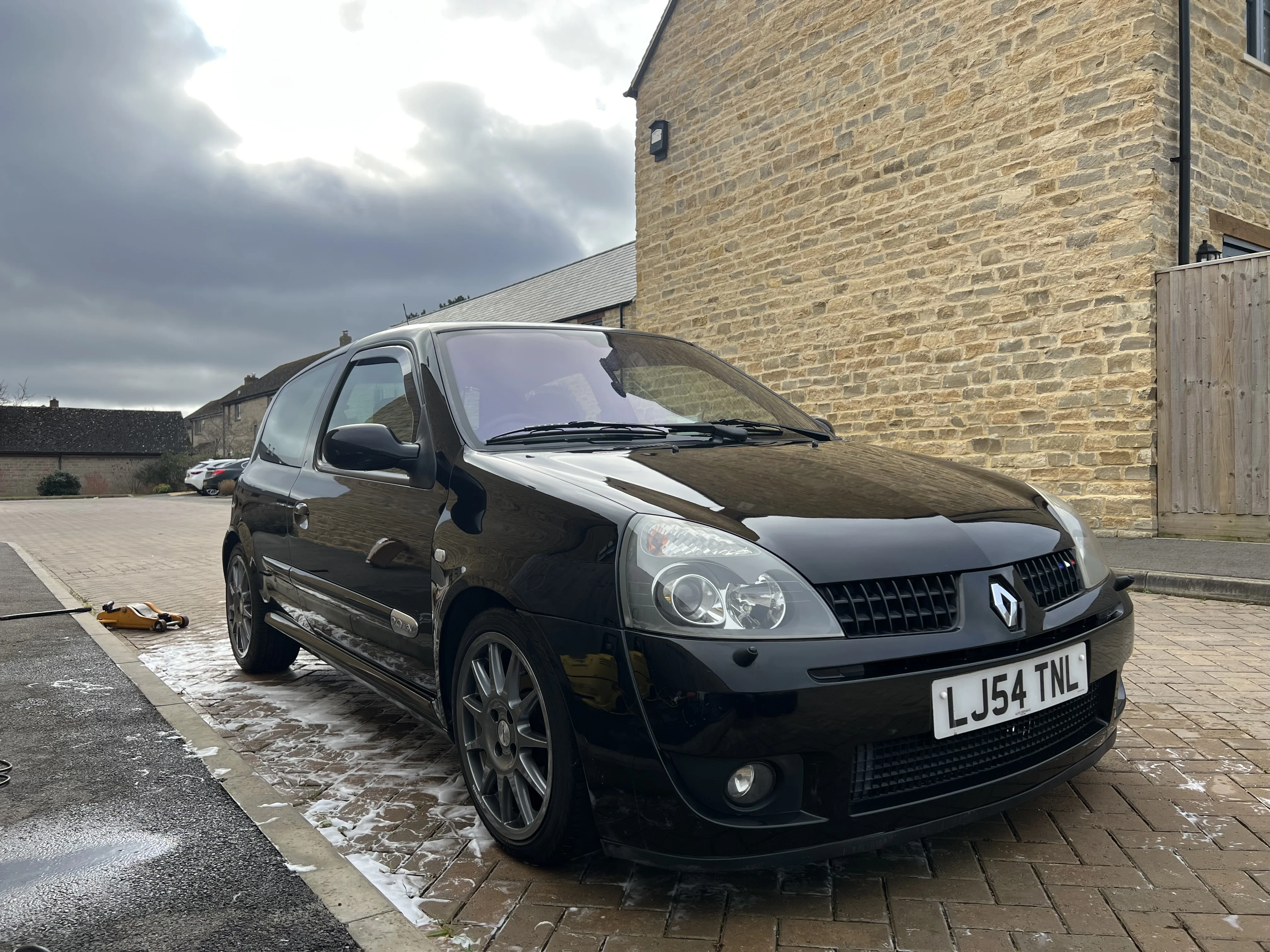

Well, this little guy has been with Beaniesport for about a week. Meanwhile I’ve picked up a 172 to actually turn into a track car.
The 182 has had all the belts etc done, new CAT put in, and thanks to an unexpected MOT fail… a pair of lower arms too.
Should collect it tomorrow evening. Bought it some new shoes while it was away 🥰
By the time I refurbished the standard wheels and fitted non-linglong tyres, it made better sense to buy Turinis
