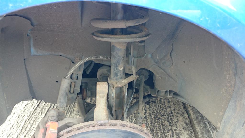

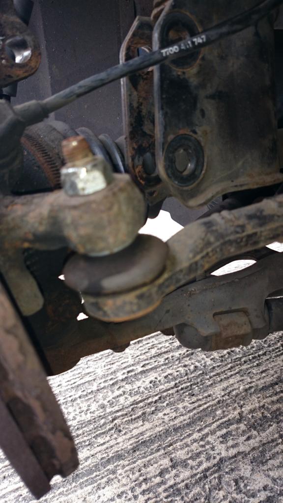

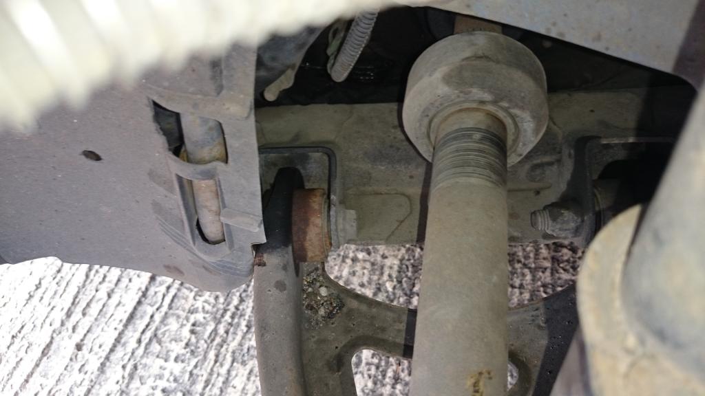

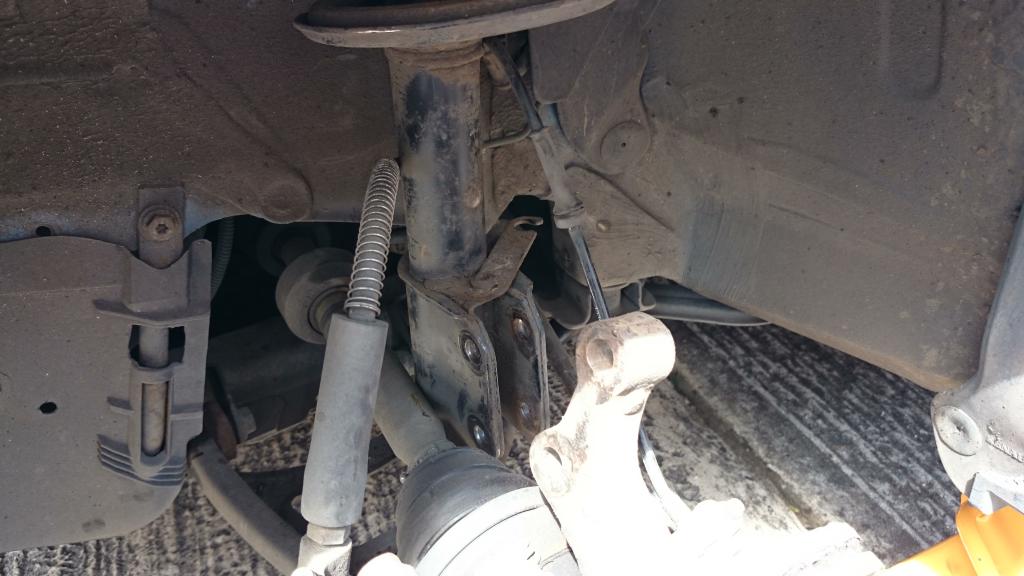

ok had the chance today for a proper play
took the wheel off and disconnected the suspension from behind the brake disk.
wobbling everything around as much as possible and could hear or feel any issues.
sprayed all 4 joins with WD40 and noise has gone.
so seems it just one of the joins

What he did wasn't a fix. It might have helped identify where the problem was if he was systematic about it, but only he will know that and it sounds like its not going to be much help in that respect. It really does sound like a dry outer ball joint to me, when the gaitor splits due to age they allow water in and the grease out - in the summer months this means a very dry joint and hence the creaking... it will only get worse.
