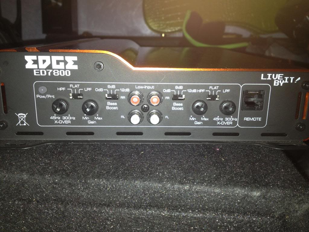

I put some velcro on the bottom of the amp and it now sits very neatly under the passenger seat, with just a little blue glow from the LED giving it away. I'm really glad I didn't go for a boot install
