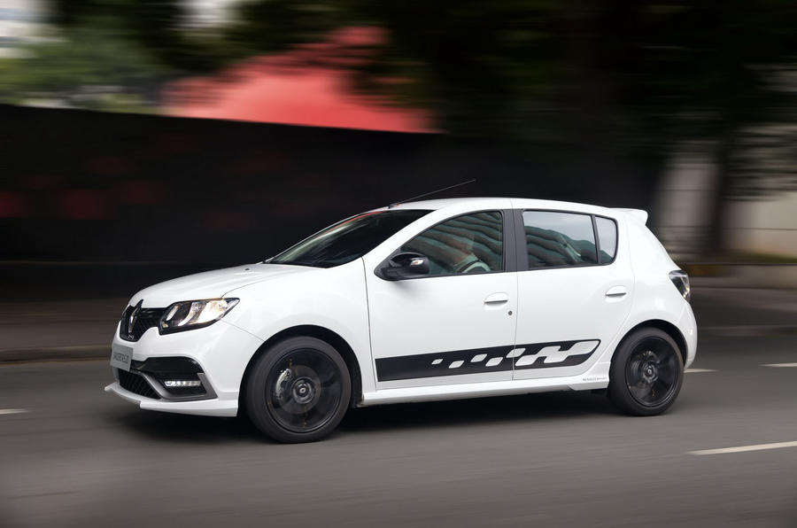

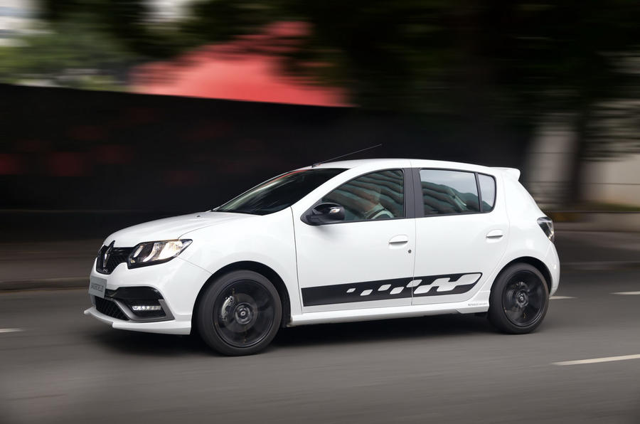

A few years ago, they did a Renault Sandero R.S. for some South American markets, and it had a 150-odd bhp 2.0-litre engine. Here it is, for anyone who cares:
Ever since I saw that, I thought it would be quite fun to do something similar over here, fitting the running gear from a Clio into one. I know it's not the best looking car ever, but I still have a strange interest in the idea of doing it at some point :ROFLMAO:
Does anyone have any idea how closely related the two cars are? I assume getting the engine and gearbox to physically fit wouldn't be that hard, but I wondered if suspension bits would also work? Anyone ever looked into it?

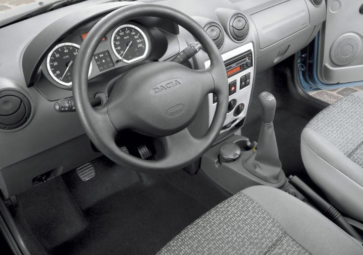

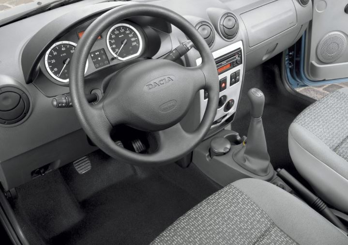

On a slight tangent but sticking with the Dacia theme I do recall the very first Dacia duster having MK2 Clio dials, indicator stalks and steering wheel
