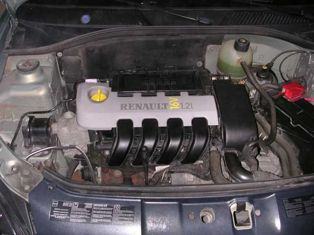

2002:

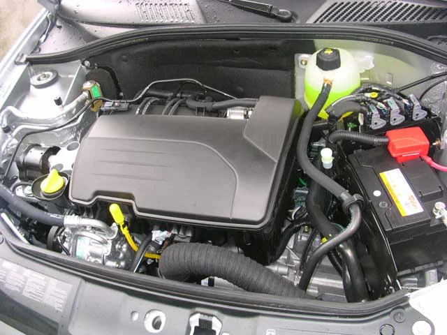

pre 2004:
different front bumper
15" version of the Mk2 172 alloys
colourcoded rear spoiler
different dials with digital screen for fuel and temp guages
new engine (different inlet manifold, ecu, throttle body) (bit quicker, more torque, less responsive) also has a different cat (doesnt have a flexi to burst! lol)
different interior
front lights have a grey surround rather than a black one (looks crap with grey)
your exhaust will fit, relocation kit wont.
Why have i got all of those changes on my 04 dynamique ^^ apart from the different engine, mines on an 04 plate but it's got the older engine????
Because Renault just slap on any old bits they find on the floor. The engines arnt made in the same factory and come on pallets, so they were problably using up whats left of the slightly older design.
I've got a 04 plate phase 3 dynamique and it has the later engine, mines was a May 2004 reg though, pretty sure the engine was changed to the newer version from March 04 onwards hence why 53 plate phase 3s and some 04s have the older engine.
for example, Al from this forum I'm sure has a Jan 2004 (53 plate obv) and it has the older style engine, he told me the engine changed in about Feb/March 04

ive got a ph3, 04 plate first registered 31st march 04, thats got the old style engine.
mines was reg'd 24/05/04
so it musta been sometime april/may the engine changed over then, or it probably did change in feb/march because its common knowledge cars are made circa a few weeks before they are registered i.e. built early Feb, not registered till late March when the customer picks the car up.
