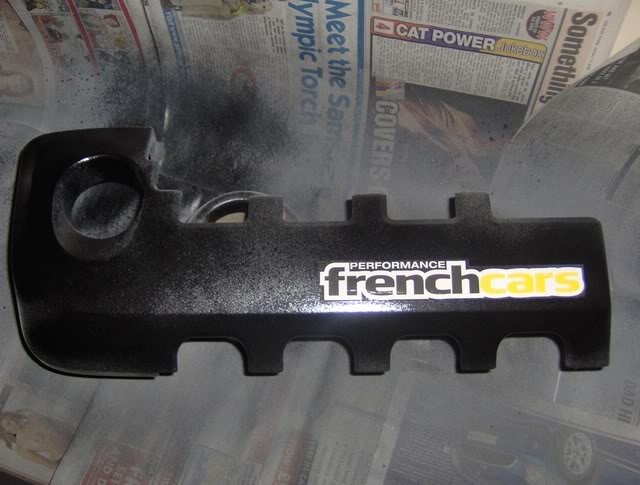

Well I started to paint it and popped a sticker on too...it needs a few more coats of lacquer still....

Are you going to lacquer over the sticker ? If it's vinyl the lacquer will melt the sticker and it'll curl up at the edges .

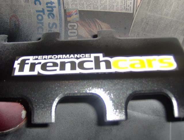

You cant see any primer in real life ..just think that was the flash..needs more lacquer there though definatly.
Iv lacquered over the sticker and it seems fine tbh...hope it will be fine, protected under the lacquer.
Ran out now so need to get to the shops in the morning:)
Your lucky then . If it was vinyl the lacquer would react with it and melt it .

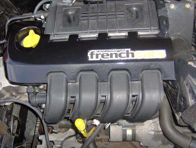

If you find you've haven't got as gloss a finish as you wanted , get some Meguiars Scratch X , it'll come up really shiny .
Thanks:) yeah I was a tad bored and hade some paint and stuff left over from spraying my sport spoiler..its only taken about 2hrs in all.:)
