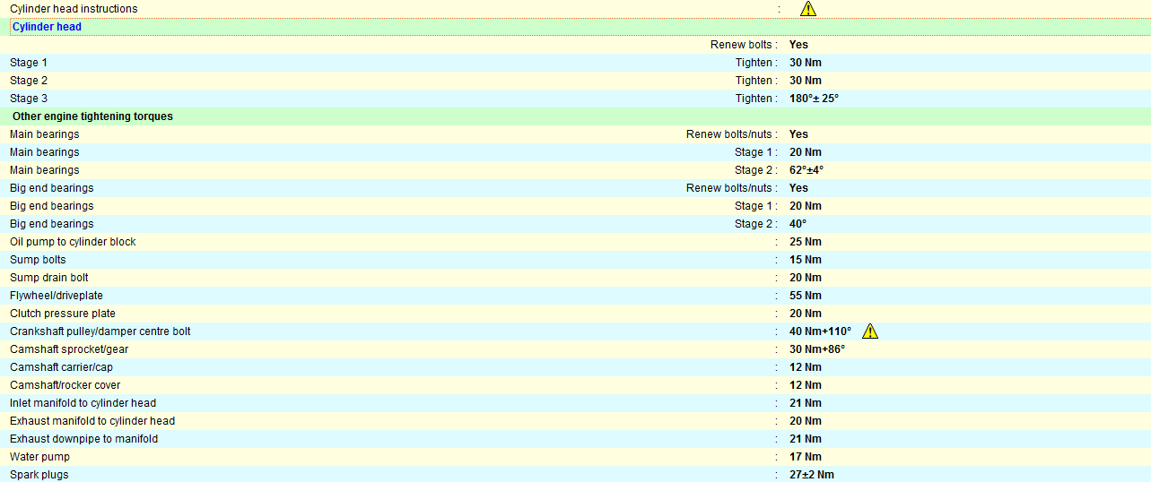

reedy107 Car 206,172 Cup,focus,X5 Feb 13, 2014 #1 find out all the torque setting for the F4R engine in the 172 ?? does the haynes manual cover this engine in the clio book ?? Ben
T ThomasBrentnall Car That shiny one Feb 13, 2014 #2 I can look on autodata for you. What part of the engine?
