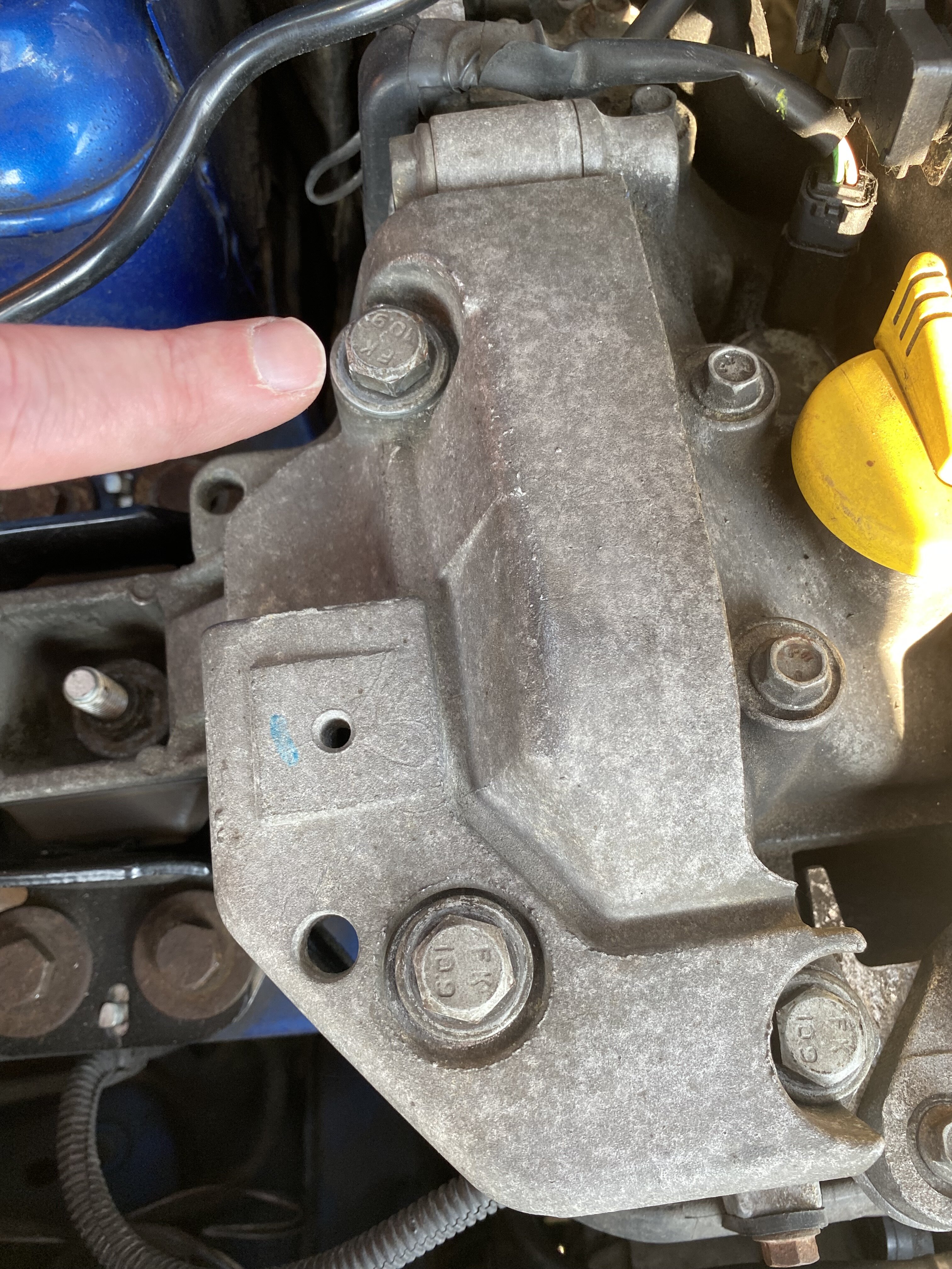

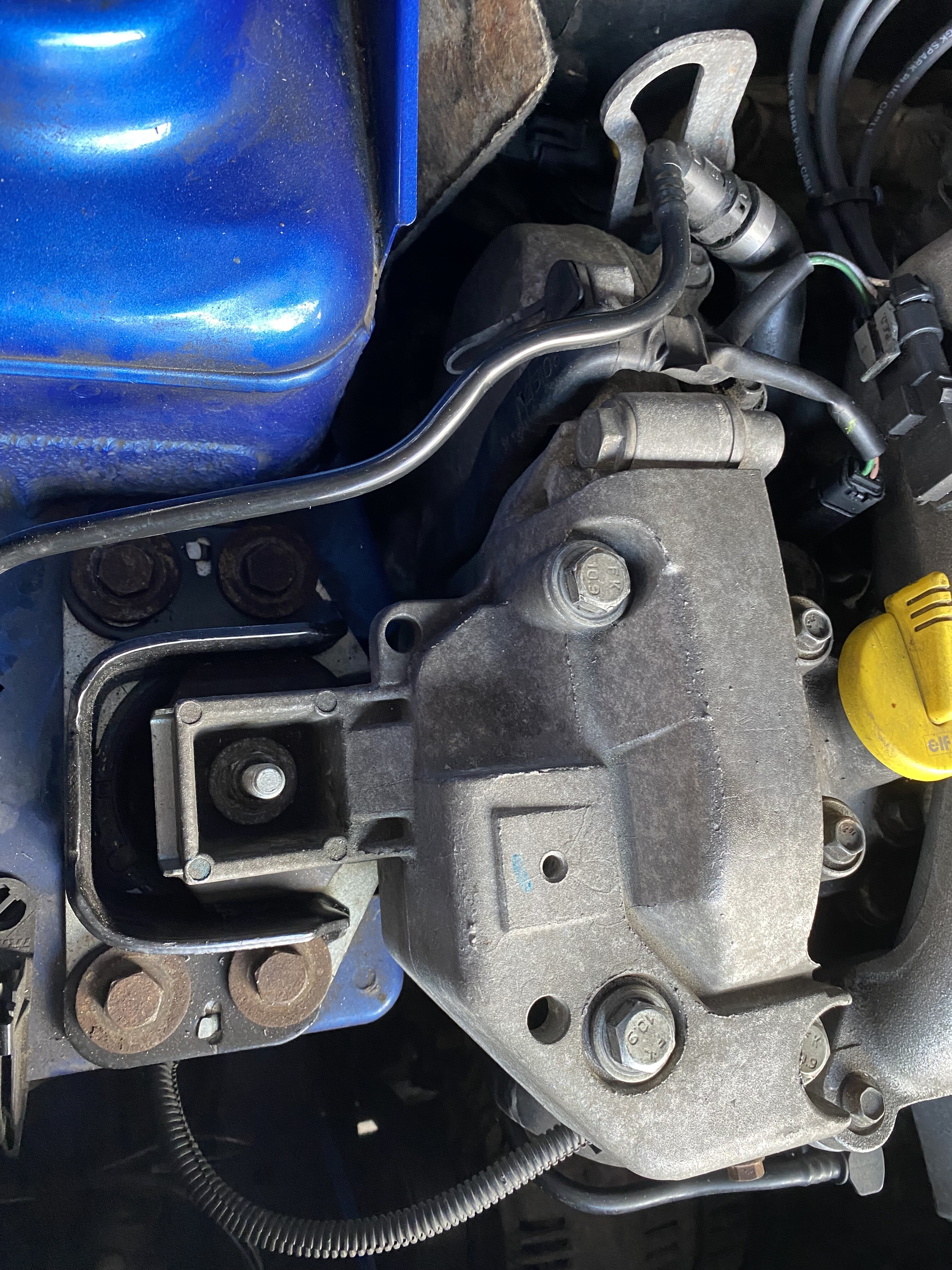

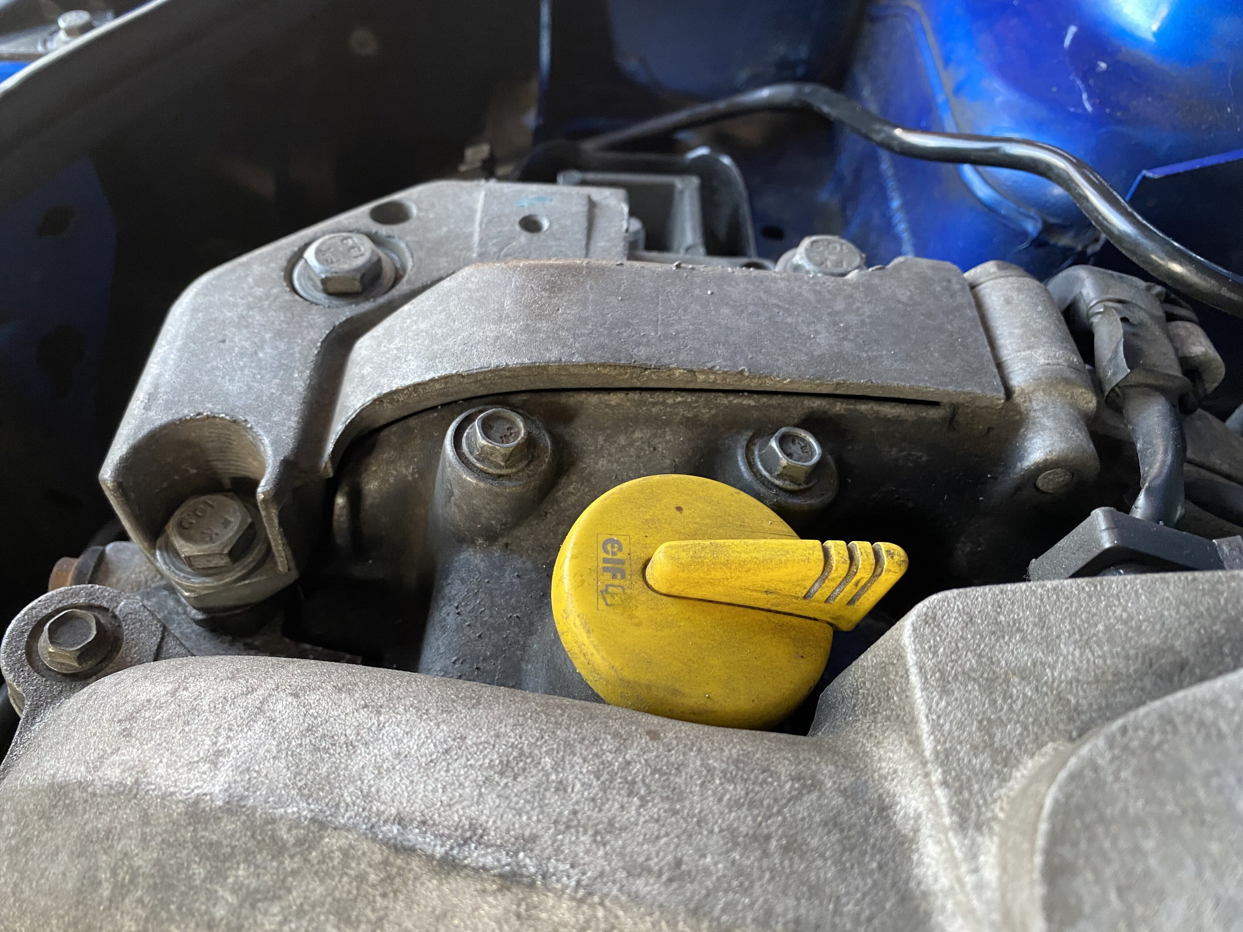

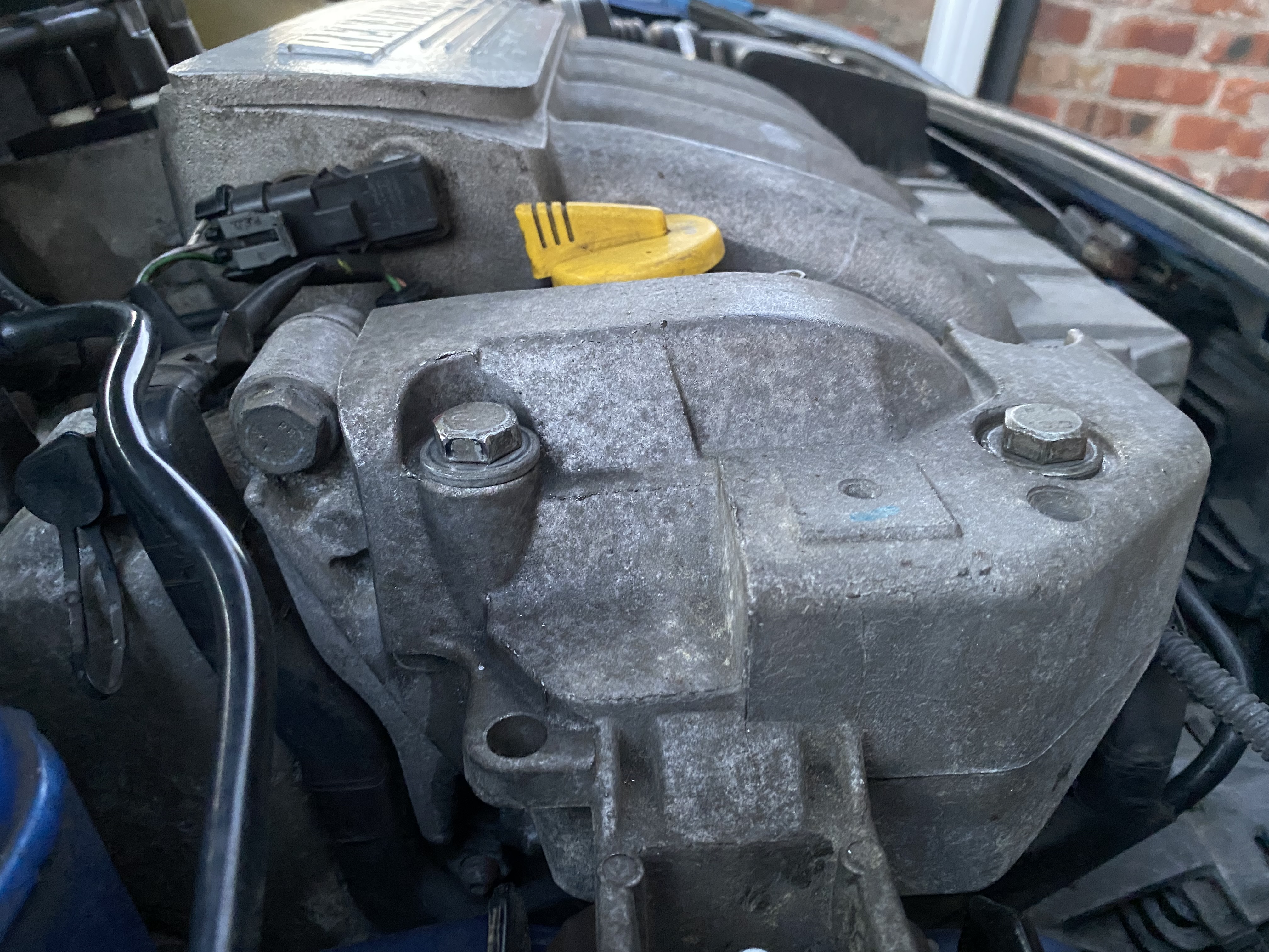

I was torquing up the engine mount bolts on the driver side and the final bolt that I went to check seemed to be loose. All the other bolts were correctly torqued. On this one as soon as I put the to wrench on I could feel it was loose. I tried it with a normal ratchet and it was very easy to turn. I took the bolt out and I noticed there was some swarf on the bolt which is obviously from the thread. The bolt itself is in good condition and there’s no damage to it.
Obviously, this needs sorting, but how urgent is it?

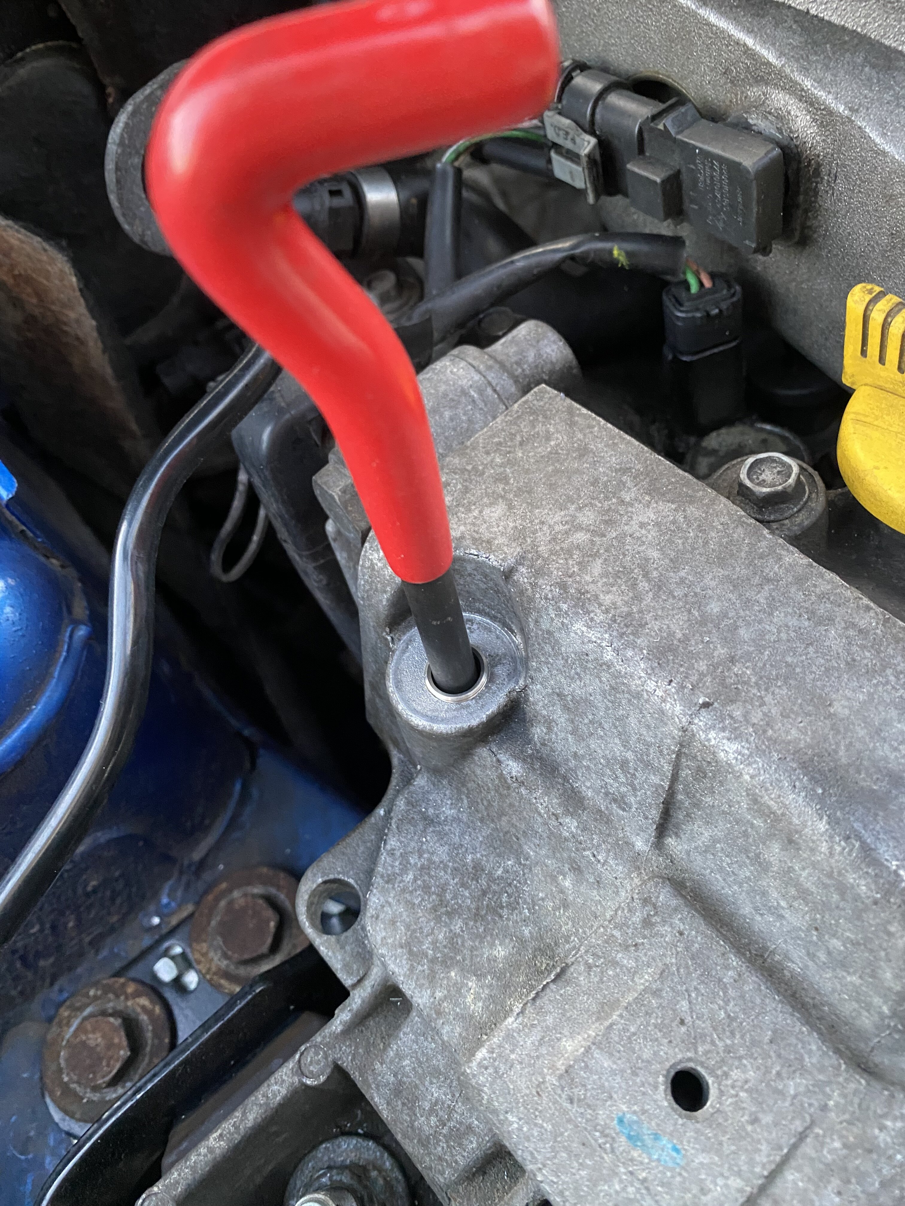

I’m just looking at helicoil kits now. Can anyone recommend what I would need exactly? I really want to get this ordered tonight and get this sorted ASAP.

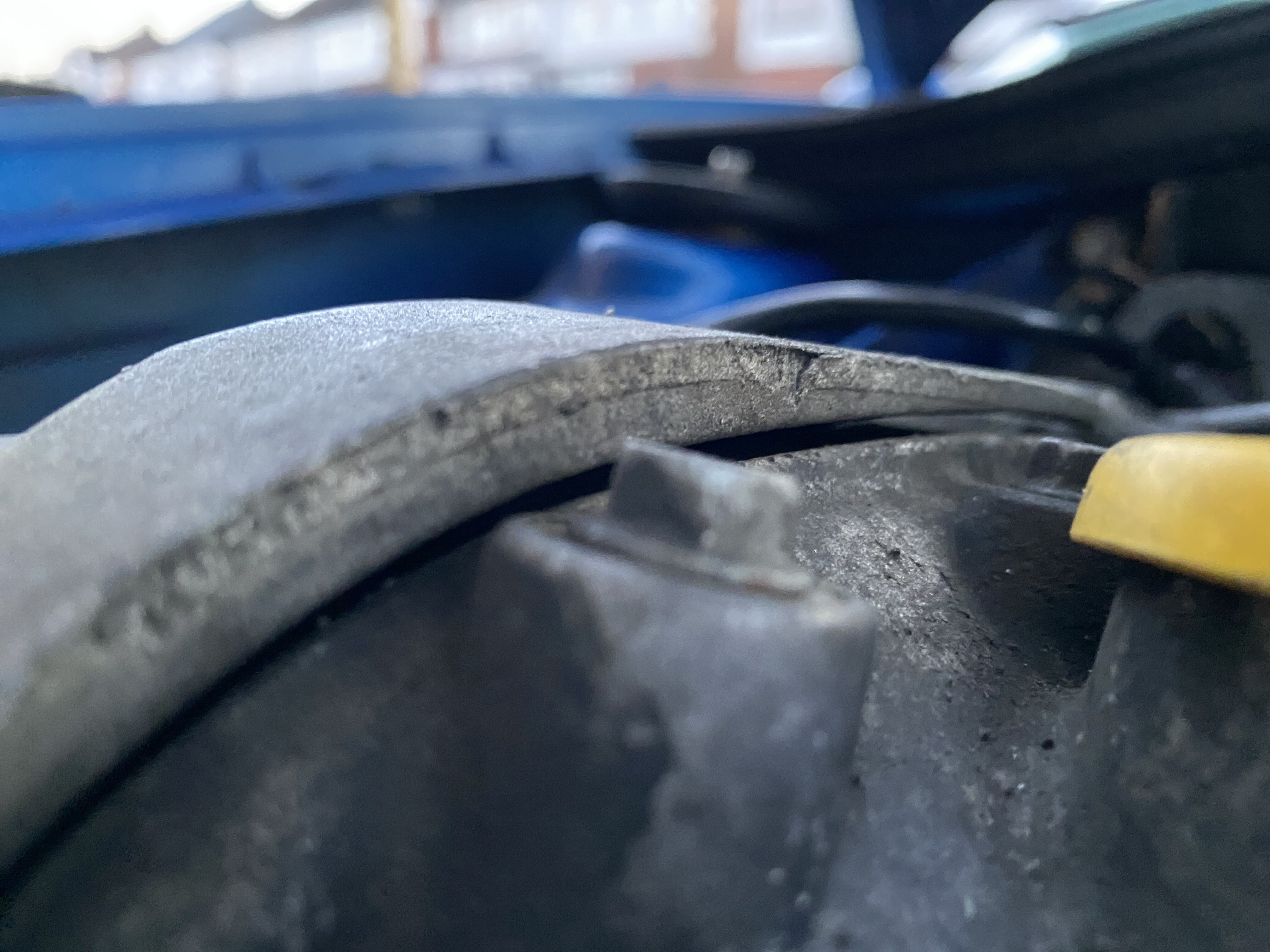

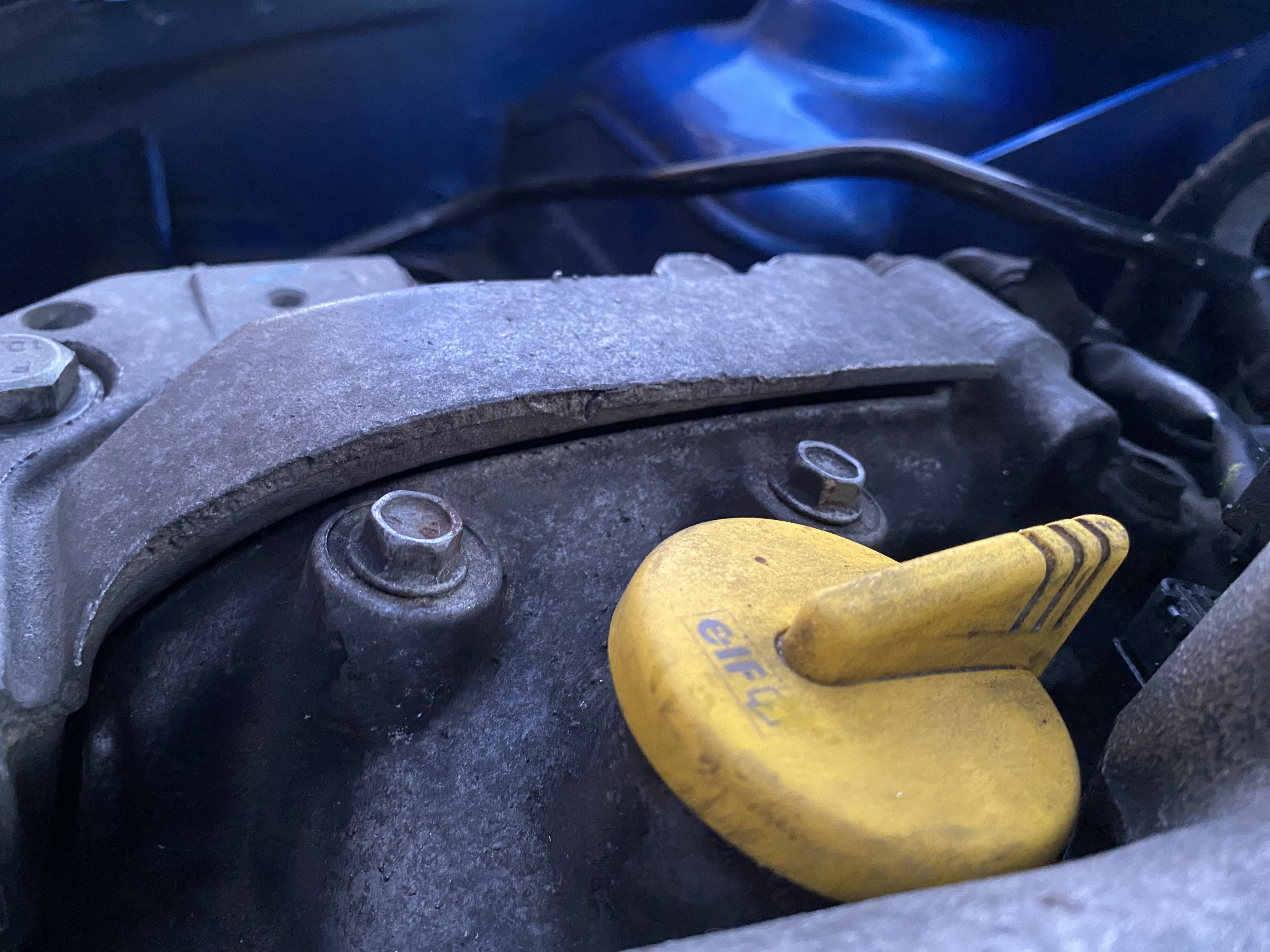

So a very rapid repair has been carried out. I followed the instructions on how to clean up the hole, tap it, and then fit the coil. Everything was going well until I tried to remove the coil insert tool. It was very tight and when I took it out, I could see that the coil had marked it a little. All the swarf and debris was cleaned out from the hole before I started. I made sure that the coil had gone down further enough to connect it to the engine part. When I came to re-insert the bolt, which wasn’t damaged at all, everything was okay and then it started to go very tight. I removed it several times to check that the thread wasn’t damaged on the bolt. I gave it a coating of lubricant and then tried to refit it. It was extremely tight and as I was screwing it down, I checked that the torque was correct and it was already over the recommended amount. But at this point the washer had not sat tight on the top engine mount. It wasn’t getting any harder to screw down but it was difficult. I continued until the washer was compressed on the top engine mount with no loose play Everything is tight now, but if I’m being honest, I don’t feel 100% happy with the way that it went. I’ve not fitted a helicoil before so I’m just wondering if that’s extreme bit of tightness at the end is normal. I know that sometimes if you tighten a bolt and it’s not going into the recess where it should sit, it will actually start to lift the item that you are trying to tighten down. I’ve taken some photos and although everything looks okay. I’d like your opinions on this. I’ll take it out for a short drive later and hopefully I’m not calling the RAC.

That gap is normal

Need top part of mount off to helicoil defo. Its done now so id leave it, get a spare lower cam cover for next time it comes off and change it.
You did drive the helicoil all the way down into the lower bracket, right?

If both are threaded they won’t tighten, right? The bolt has a fitted washer that spins freely meaning that the compression is between the helicoil and the bolt head/washer. This will be why it was so tight. I need to remove the tapped thread in the top bracket.
It’s nearly 1am and my brain just said “Oh, before you sleep let me just say…”
Yes, I checked the other holes once I removed the top bracket. Also, even though the top bit has a thread on it now it’s not big enough to hold the bolt, so the bolt is still loose in the top bracket. I think the problem was definitely the helicoil not fitted correctly. I’m just in the middle of redoing it all now.

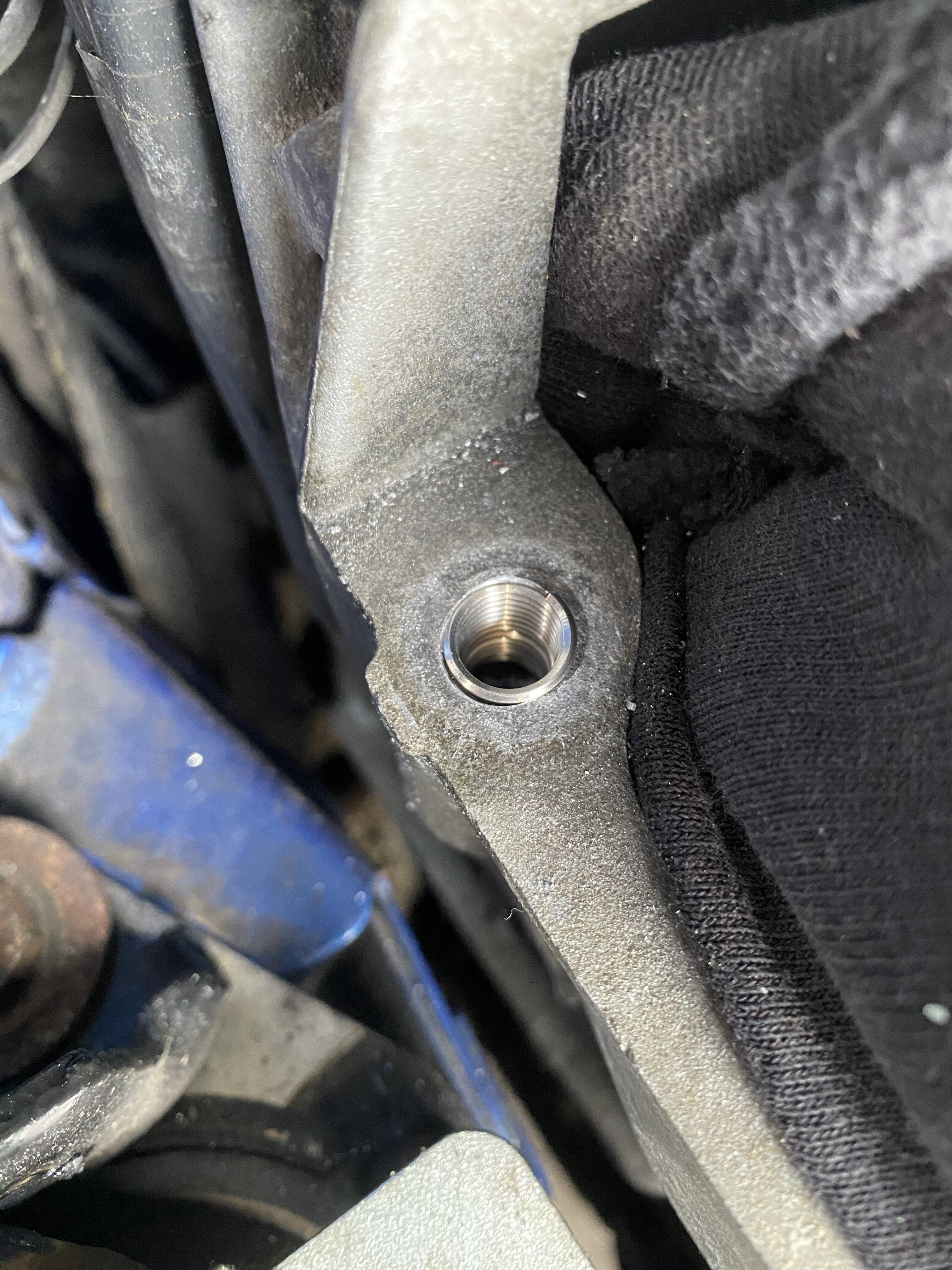

You want it to sit about half a turn/thread below the surface.
Everything is back together now. It took awhile to clean out the debris from the hole and the tap needed to clean up the threads quite a bit, but the heli coil is in position as shown on the photo, but I did give it another couple of turns to sit it a little lower. The tang was knocked off and then everything was put back together. Strangely, when I put the bracket back on it seemed that the engine had settled out of position. I’ve no idea how this happened. What I did was Jack it up a little higher and then as I put the bolts back in I made sure I pulled the engine forward so that I could screw the bolts in with my fingers and not with a ratchet. I did this for all three bolts and the nut. I then torqued everything up to the recommended settings and went for a test drive. There’s no strange noises that I haven’t heard before so I’m guessing that I just discovered this loose bolt even though it wasn’t causing any problems or making any noises. At least it’s a problem solved even if I didn’t know about it before I checked. Maybe the moral of the story is to not look for things.
