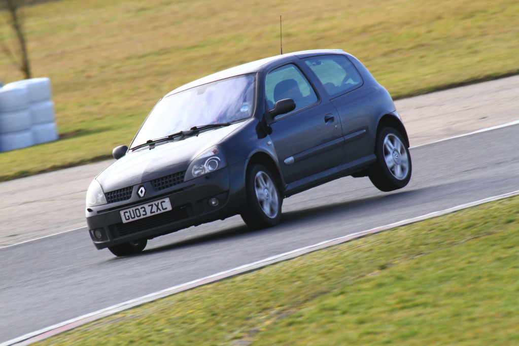

As Tony says above. This was £1400 to buy, then uprated brakes only to get this=job done. All you will need honestly, was keeping up with Caterhams and other far more expensive cars. Thoroughly enjoyed it all day and returned 18mpg on track.
If your going to spend money get a good cage and leave the rest it's a great car untouched.
Imo get a standard 172, buy some uprated pads and maybe some 2nd hand R888's and job done :) go and have fun!
how much for the brakes?
About £250 plus fitting for Brembo discs, Ferodo ds2500 pads, braided lines and dot5.1 fluid.
Toyo R888 track tyres.
