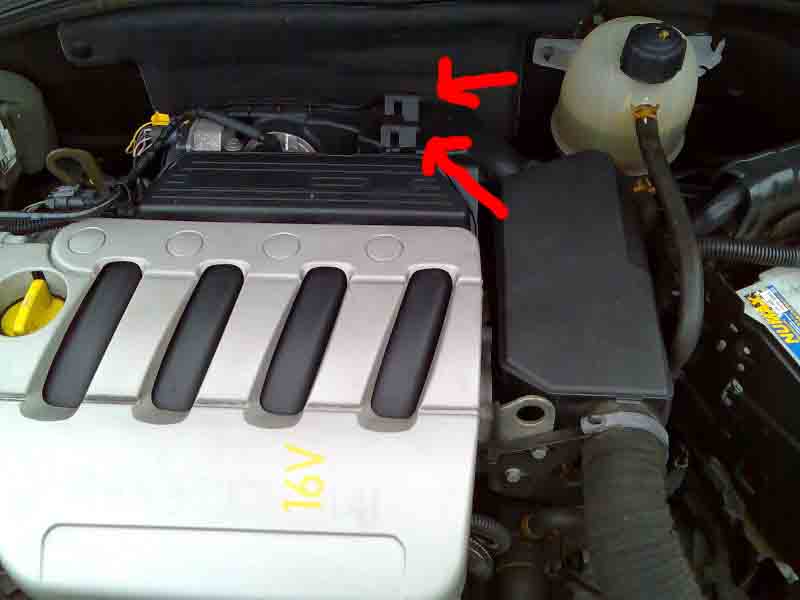

How the hell do I........
Car  Black PH2 172 FF
Open the air box? LOL
Just bought a panel filter to go in.
Is it just meant to prise open?
had the same problem....you have to undo the 2 x torx screws...seee pic.
first pull the "balck Box" off to make space, after the screws are off it "hinges" at the bottom.
