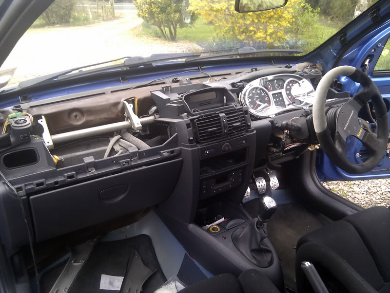

So my cage is on order, and as it's NOT a dash dodger, the dash has to come out.
I'm at this stage so far:
Question is, how to I progress further? How do I remove the main bulky bit with the centre controls and glove box?
Thanks for any help :)

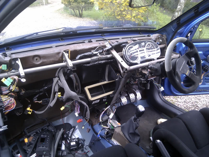

Never mind, an afternoon of persistence got me there!
But now my dials don't work :( Any ideas?
Also, I wouldnt mind removing that metal 'cage' thing. But I notice the steering column looks to be supported by it. Can you take this out without affecting the steering?
  Qashcow
its fun taking stuff apart. sorry i cant be of much more use at the moment Dan. i think that steel bar has to stay im afraid
  BMW M6 & 172 Phase 1
Out of interest, where are you getting your cage from? I'm after a non dash dodging cage myself :)
Bomber...the steel bar thing is out. The steering column is supported by another chunk of metal, so it's ok :)
