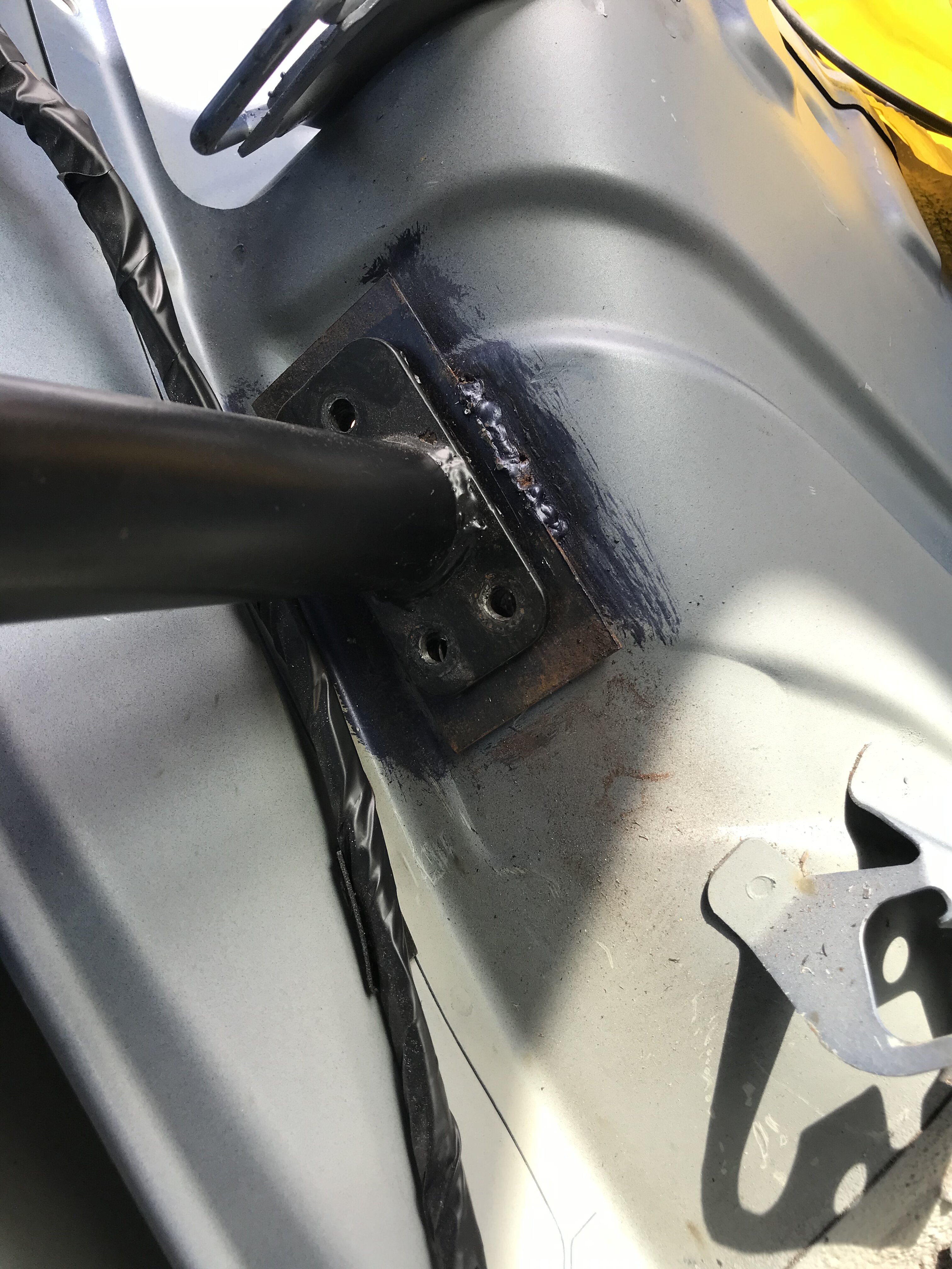

Strengthen poorly executed rear cage mounts.

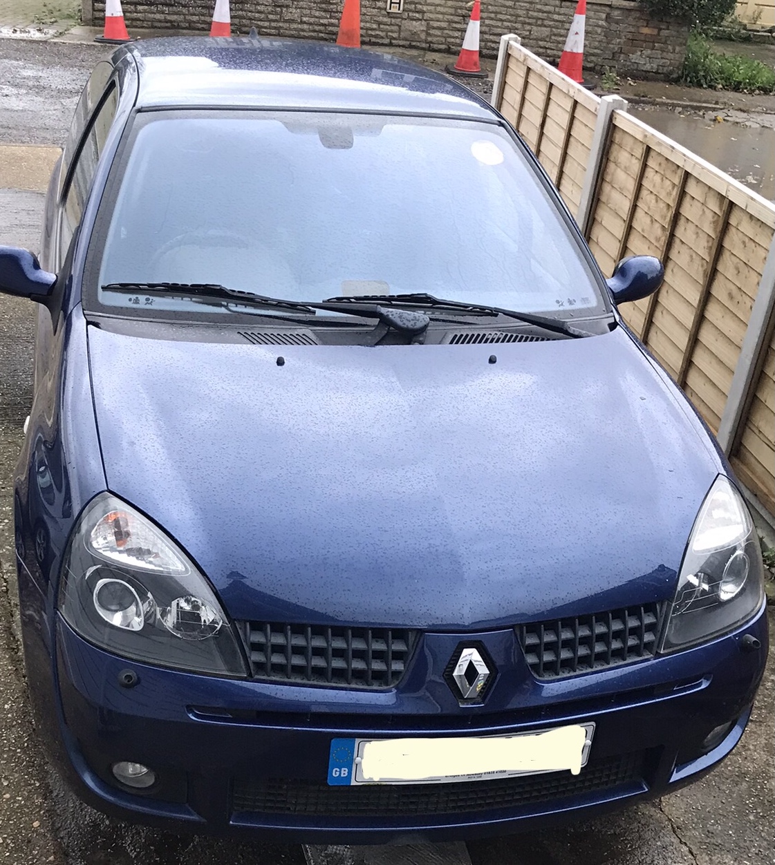

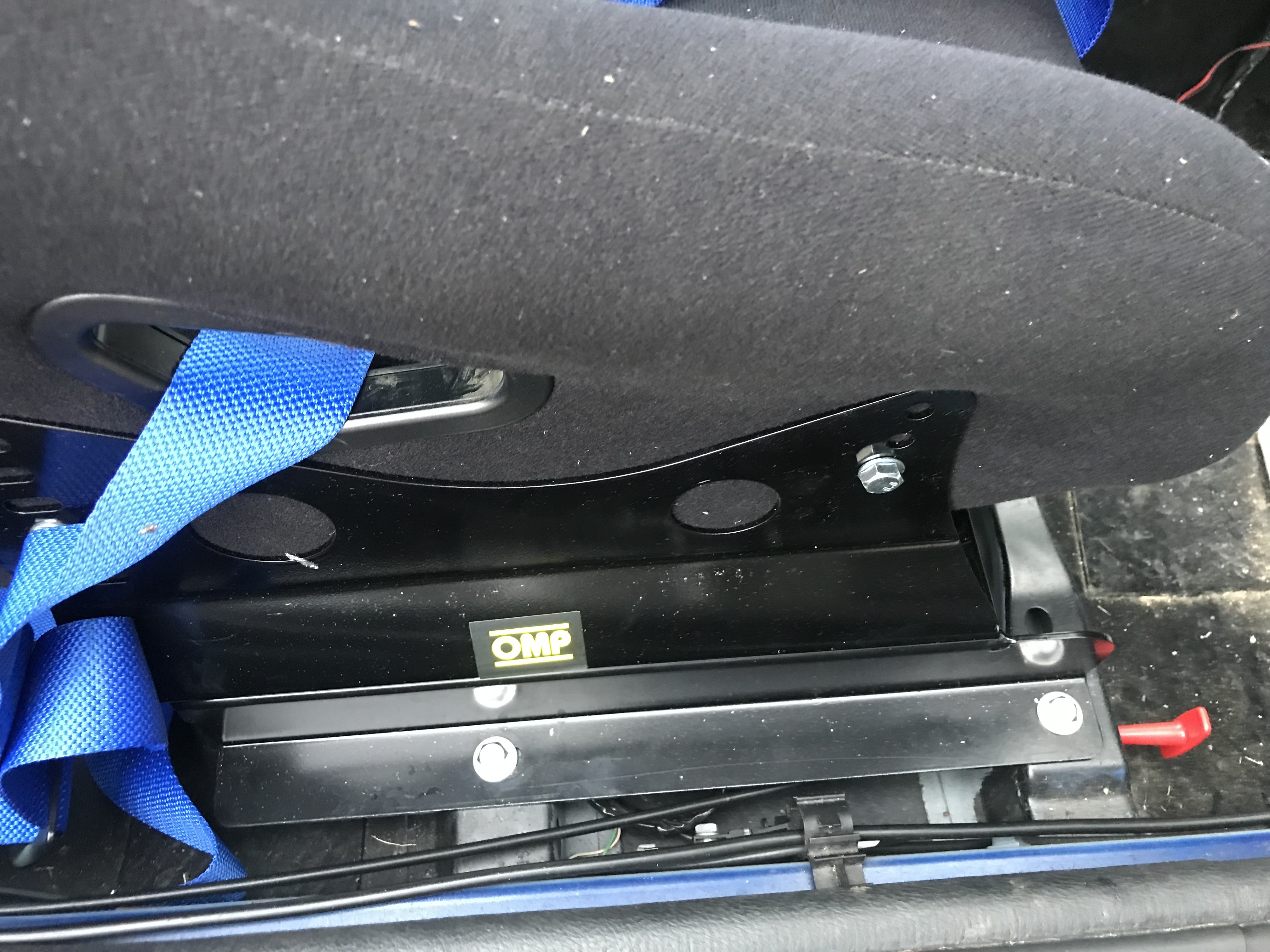

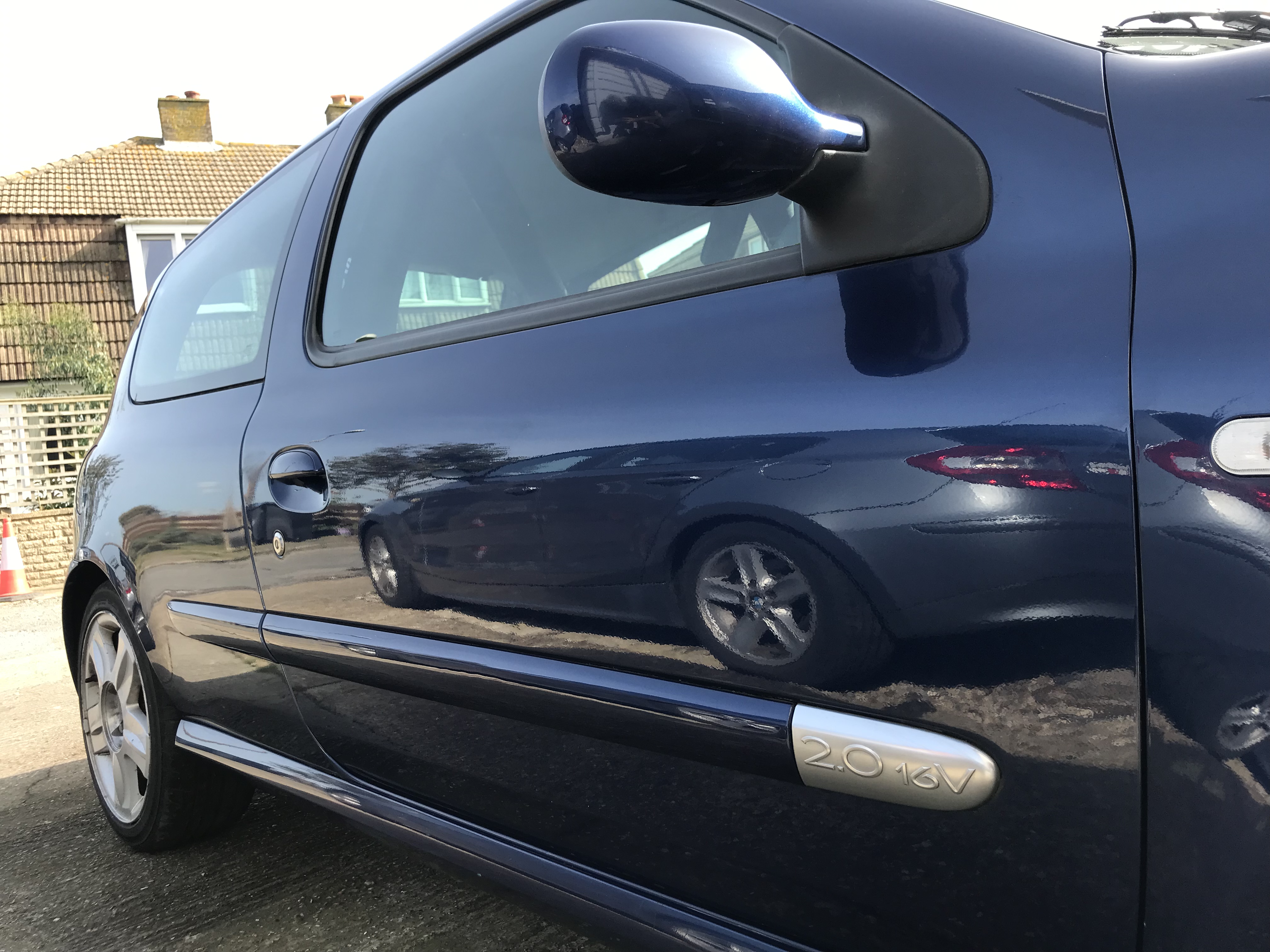

He was living out there due to work and as he was about 1 1/2 hr from the track he’d often be there but it was also his run about road car so nothing too radical done to it.
Mainly was adjustable koni all around, full cage, seats, harnesses and fire system.

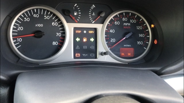

My main things to sort are mostly here…

The cars have a white connector which lives under the fuse box, these often corrode and cause all kinds of fun electrical issues - well worth having it apart and giving it a good clean.
Welcome,
Is the red light on the dash the stop light ??
For the Air bag delete you would either need to do a diode fitment or delete it via Renault Clip.

At the moment I’ve ripped out the alarm that Renault fitted when it was imported. No wonder it was screwed as the batteries in it had rotted and the acid corroded the pcb. Easy enough to get rid of once I’d removed the cage enough to remove the dash top.
Have started to suss out the resistors, airbag light is still on but need to look at a wiring diagram and do more googling.
Not sure about the red light that says stop. Need to look into it.
The serv light I am taking a guess it needs clip or rs tuner to delete that.

The Service light is effectively telling you that your car has a fault and will pop up when there's an underlying fault , I.e Airbag.
Are you air bag deleting due to seats or steering wheel ? if none of these it will more often be the wiring under the seats. There's a few vids on YT but effectively you just do away with the black and grey blocks and solder the correct wires together. Some say you need to put a resistor in , however i didn't have have had no fault since soldering. If you've done away with the pretensioners and Airbag from the steering wheel due to after market wheel. the correct procedure will be to either buy a clip module ( Ive recently had to do this and created a thread for it) or do the resistor mod.
Hazards on perm have a look at the stalk module behind the wheel , these are prone for failing. Tell tail sign is usually that your indicators don't cancel though.

The car was stripped of road seats and associated bits and replaced with track seats a long time ago and driven irrespective of the airbag warning.
I acquired the car as pretty much a stripped out shell but with running gear.
I’ve since got a wiring diagram so will at least be able to identify the respective wires that still exist.
I’ve seen a few videos and guides and read much good stuff as well as contradicting things. Once things get a bit warmer than this weekend ( -4 degrees ) I’ll be back out there.
The hazards on was caused by the alarm. I’ve gutted that out and once I opened that up it was clear why it was fubbared. As all the inbuilt batteries had leaked and rotted other components. Never a fan of alarms so that’s gone in the bin.
With regard the Clio, I’d really like to avoid having to get hold of one as the plan is to try what I can and then once it’s roadworthy then see if I can get someone that knows and has clip to just do the delete for me. If there’s other issues and a diag is needed then I’ll cross that bridge when I get there.
