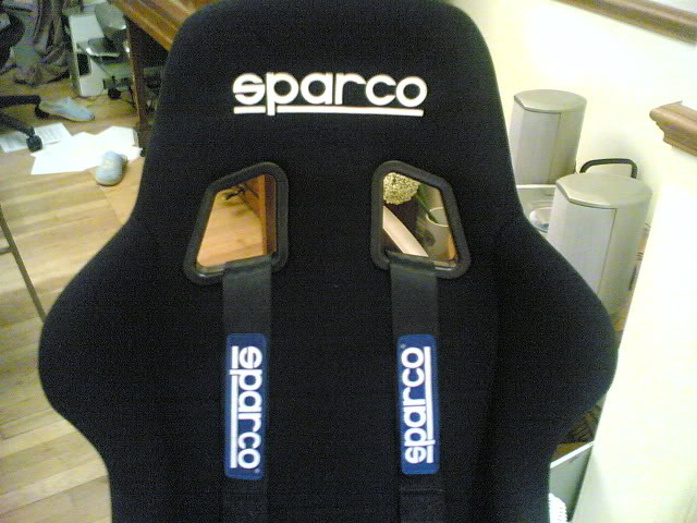

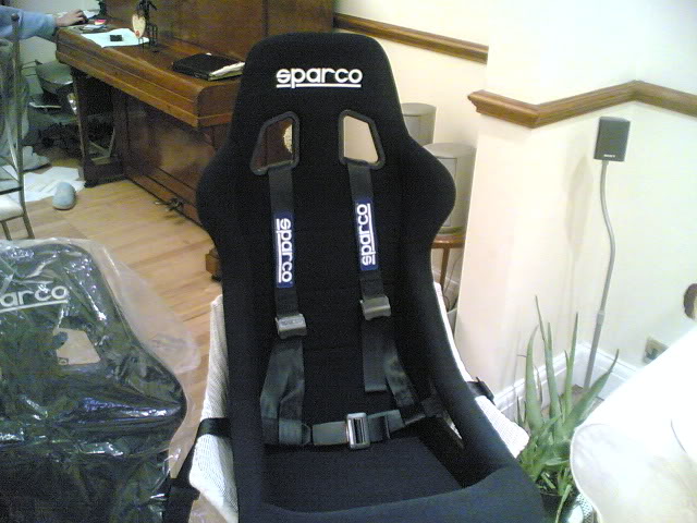

ok my seats came this morning, i cant figure out how to get the old ones out, all i can see is circle black bolts, which means they cant be undone.
  182 and 5 GTT
I think the subframes are done up with 2 bolts on each seat underneith the car buy the heatshield for the exhaust
The seat rails have studs on them that go through the body of the car. You need to put the car on a ramp or axle stands, get under it and undo the nuts holding them on. They have rubber bungs over the holes in the floorpan covering them. Once you look under the car it will be obvious. Also if you havnt already unplugged the wires under the seat for airbag and pretentioners you'll need to disconnect the battery for 30mins then unplug them.
  Merc Coupe V6 AMG
sparco sprint, i cant do it with out a lift, the cars to low.
i like them alot, but im sure some1 will criticise.
