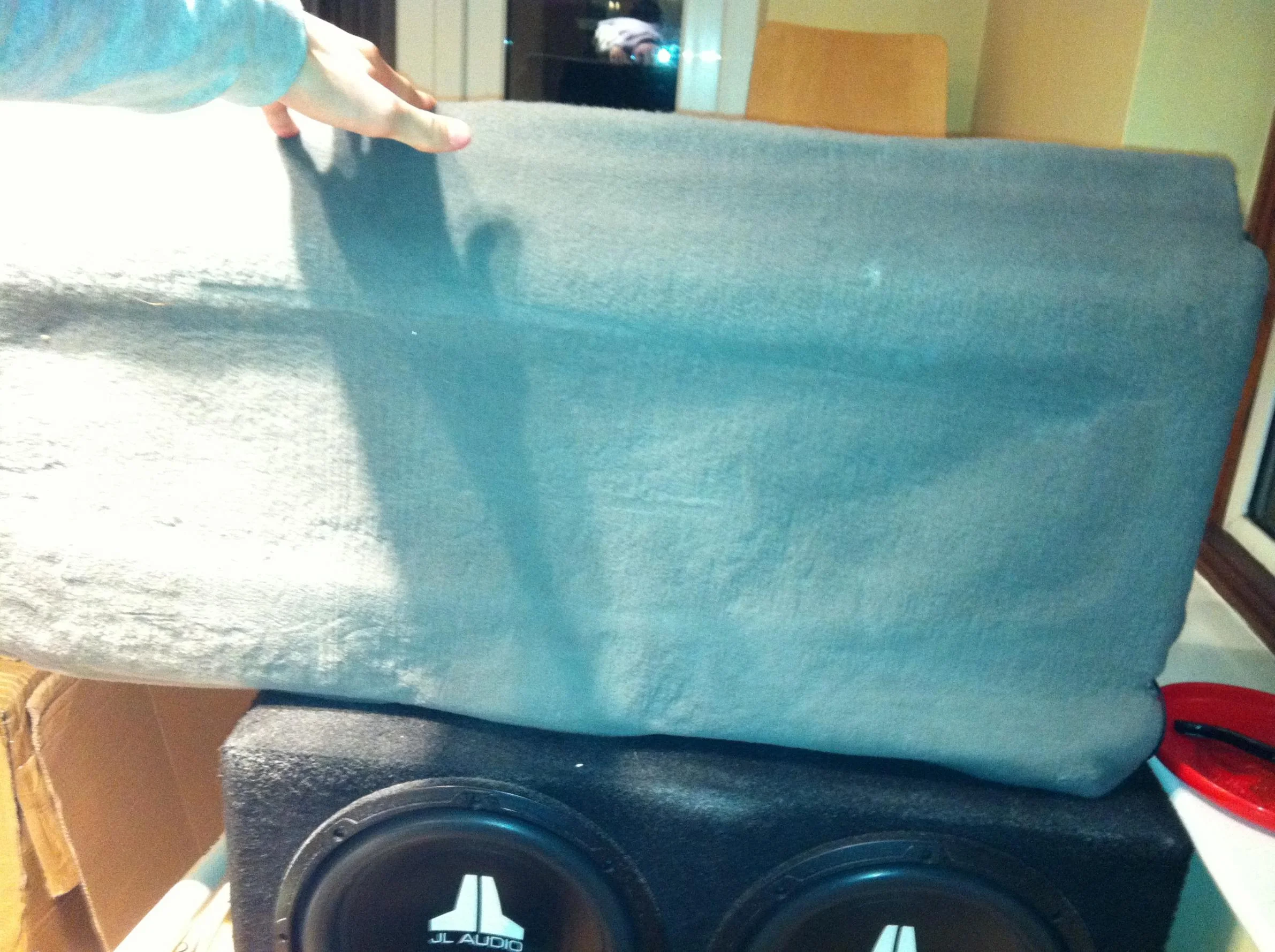

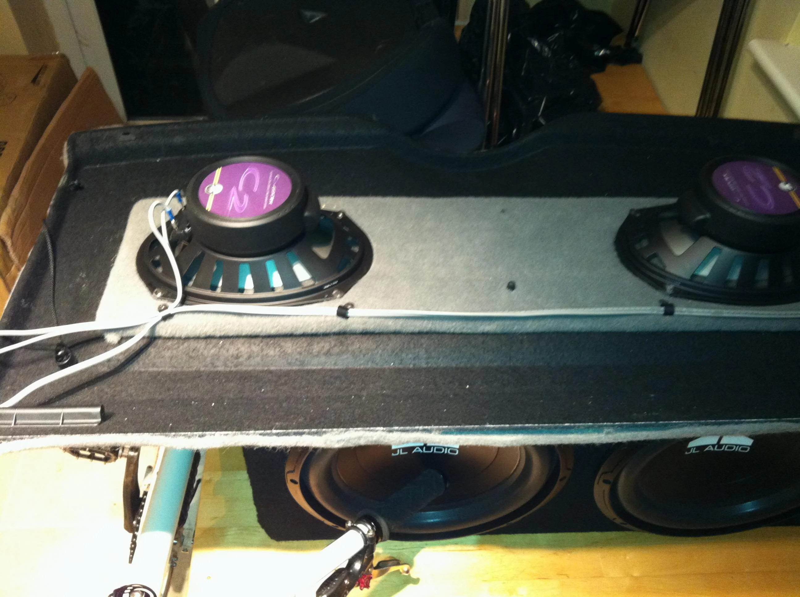

Take the speakers out.
Mount them from underneath instead.
Get some black accoustic carpet and some carpet glue from ebay/halfords/superdrug.
Cover shelf.
Done.

Thats what i have done with mine makes the shelf quite heavy though.
