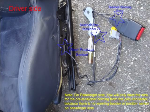

The seatbelt pretensioner/buckle are all in one unit.
So you just bolt that on to the bucket seat subframe. I've use my original belts with my buckets no problem.
(Ignore the labels I nicked this from my airbag wiring guide in the guides section, but shows the hole it bolts onto the seat through)
