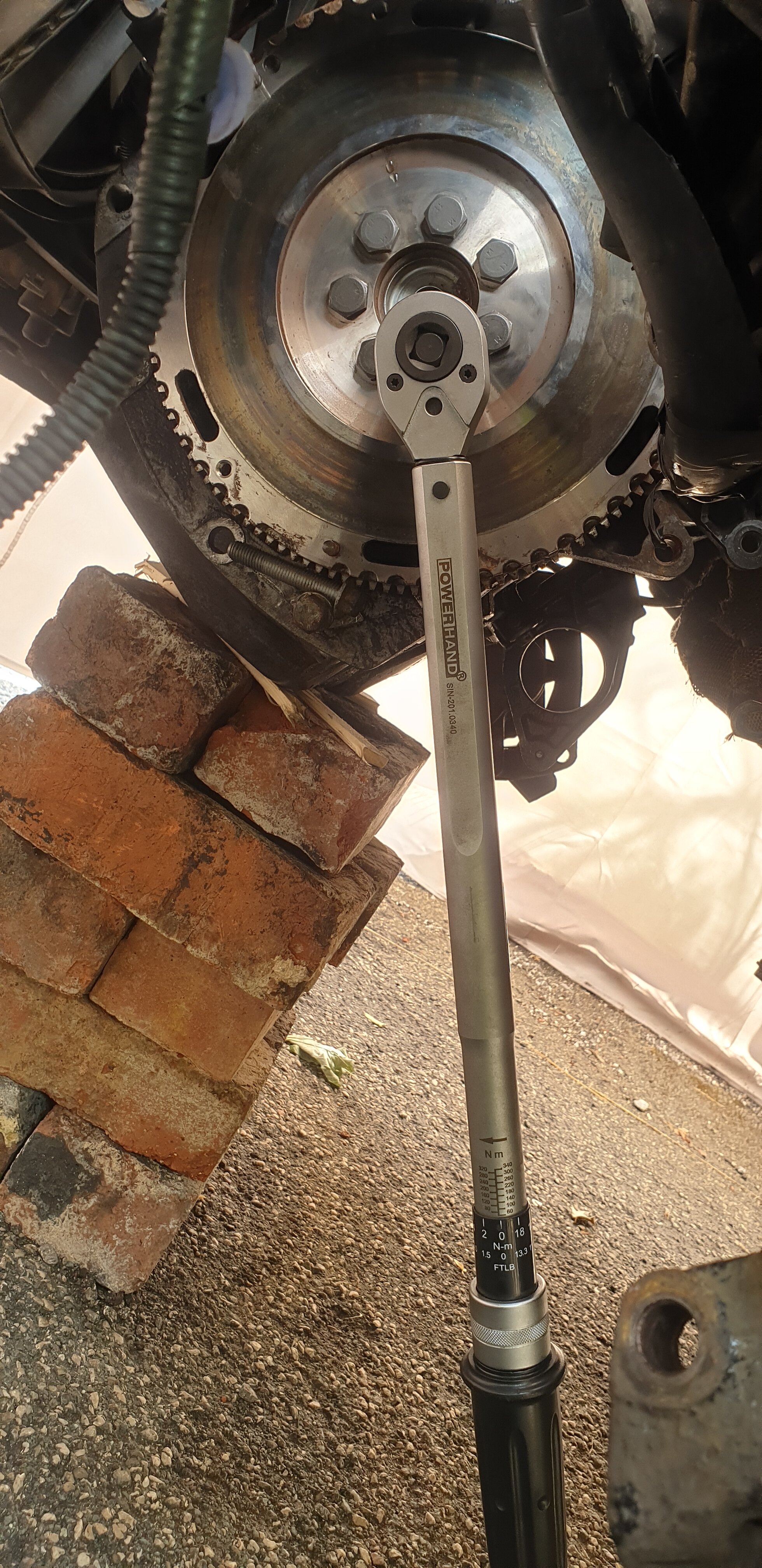

Currently doing the timing belt on my 1.2 16v clio 2 D4F and I’m struggling to find a tutorial online and when I think I find a good one they have different looking parts but apparently are still a “D4F engine” most of them have a way of locking the flywheel but I have no where to!! Can someone provide help? My engine is the D4F with the massive air box on top of it
If you mean lock the flywheel in a way with the box off you can do it using 2 bolts like this
If not bang a drillbit in here
d4f-flywheel-tdc-jpg.19404
