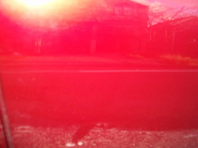

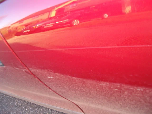

How to remove this scratch?
  Z4
I've had it for a while now, and I didn't know how it happened when it did! I'm guessing some t0sser brushed my it or something.
Anyway, I can't catch my nail on it which is good, but it doesn't want to polish out either. What products can I use?
Obviosly not a clio, but I'd appreciate some feedback as this part of the site is quality!
  Renault Clio S
Failing to catch your nail in it is a good sign and it should polish out with a bit of effort. What polishes do you currently own?
  RenaultSport clio 172 CUP
Looks like a scuff more then a scratch should be pretty easy to remove with a PC and some carlacks 68.
  Z4
I haven't tried any anti scratch products, just literally a hard hand polish with megs etc! But with no results tbh.
I'm not going to touch t cut as it's metalic red and I'm just too scared! I thought about scratch X but it's possibly too mild?
TeZ
  Non RS : (
might need a wetflat
possible.
Tho first try the Link Rich Gave or Meg ScrathX.
if you have no luck after a while and a very dead arm, As FM has said a wet flat may be in order.
It is however hard to say at all from pictures.
  Mito Sportiva 135
My dad had a similar mark up the side of his old car which reduced by using scratch x but was still visible. As I didn't have my PC then I didn't have the Menzerna IP which might have had more effect, he had it mopped in the bodyshop in the end which did the trick nicely.
I had similar scratch, used Meguires (sp?) Clay to clean the length of scratch then Scratch X, took it out nicely with a bit of elbow grease and patience. My car is Silver though so it's possible it's still visible under extreme light but I can't see the scratch anymore.
