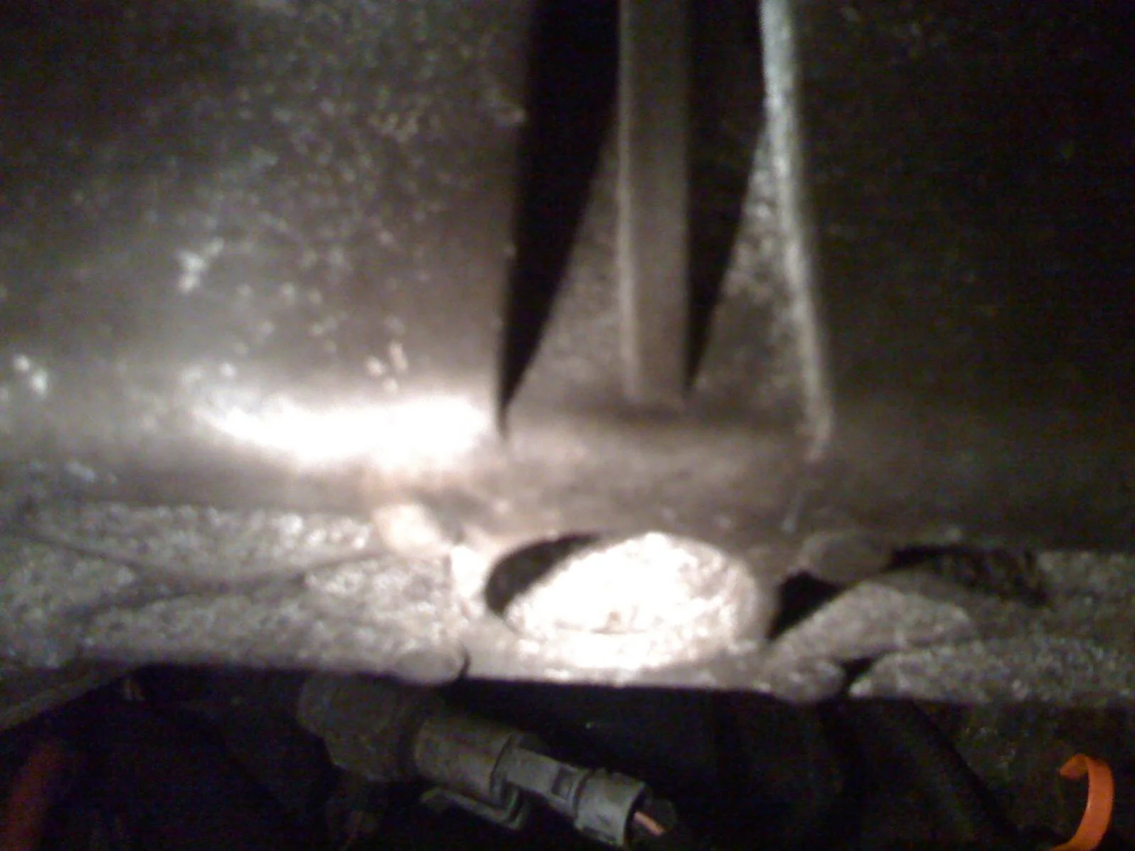

How do you get that metal block off as I can't get a tool in the holes at the front to undo the 3 bolts e.g. this is one of the holes below

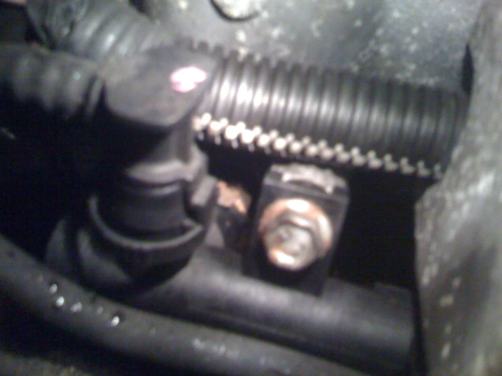

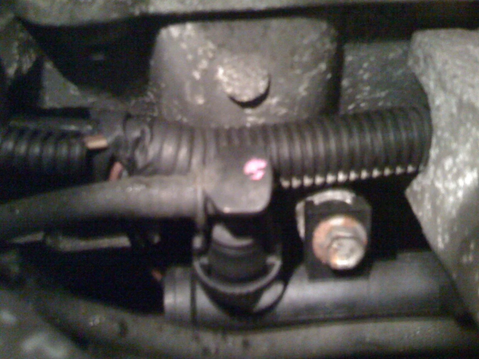

then i take it I have to undo the bolt below and 1 the other end to get the fuel rail off?
Is that a glimpse of the injector I can see just to the left of that bolt (copper shine)?

10 or 13mm socket (i can't remember it varies between rs's and cooking models) on a 3" extension up the two lefthand holes to get the nuts off.
Indeedy
Thats the clip that retains the injector onto the rail but near enough yes. Its a steel clip its just rusted.
