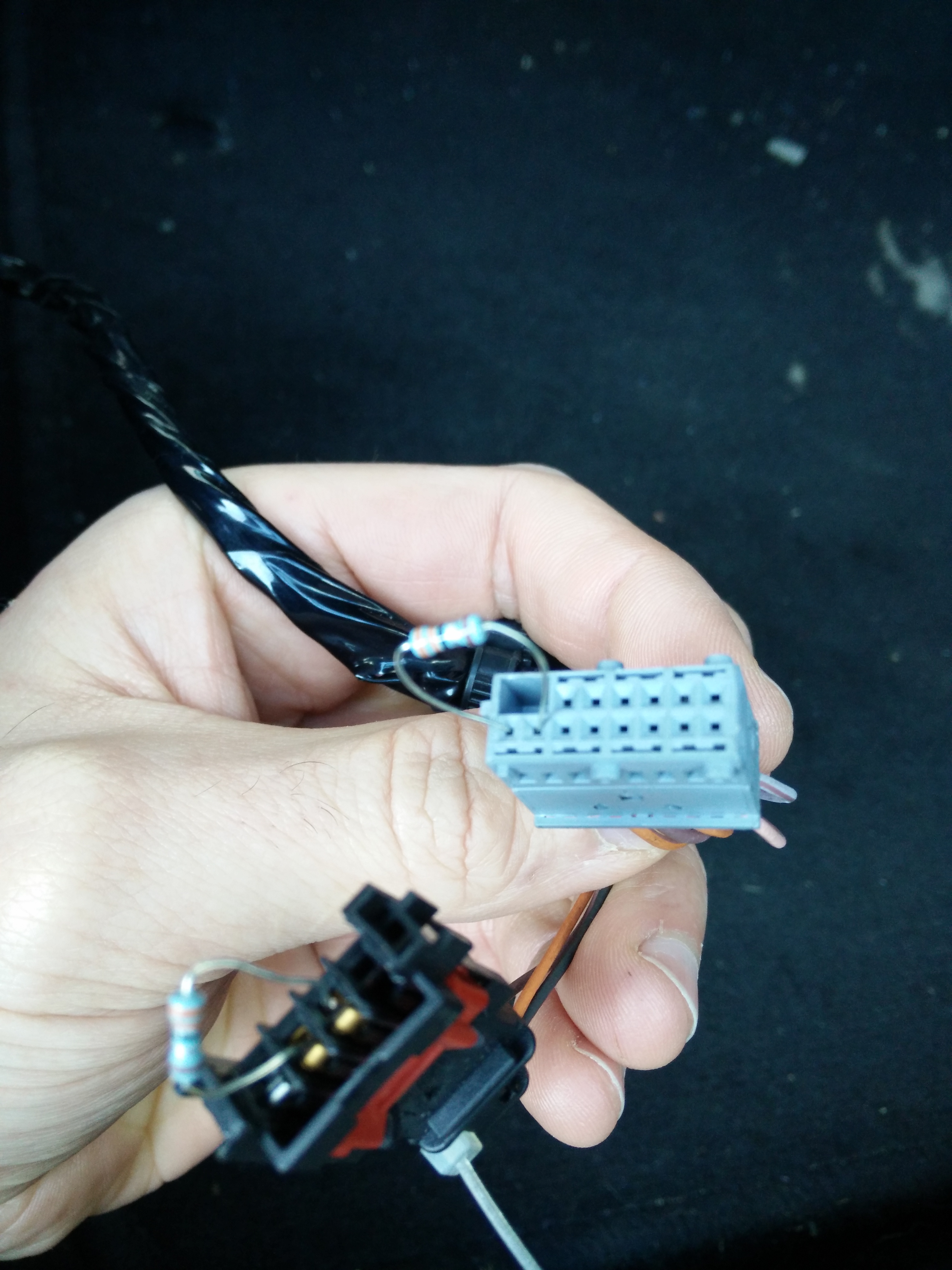

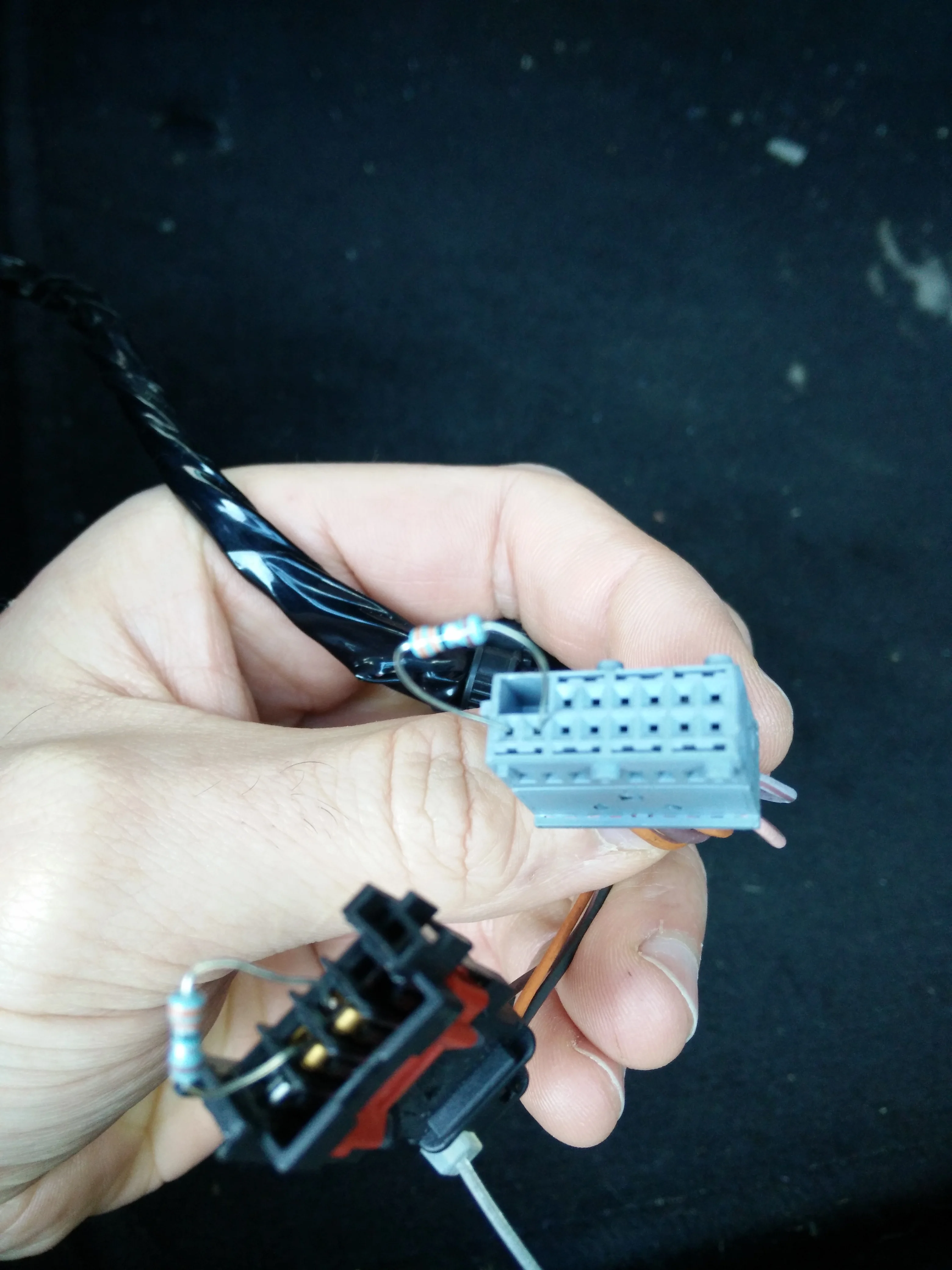

Recently installed Recaros in my 182 and subsequently had the airbag warning light on, cleared it by fitting 3.3 ohm resistors from Maplins.
