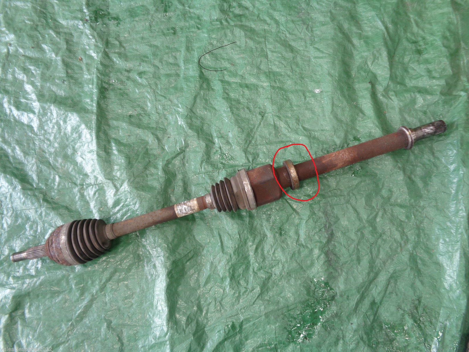

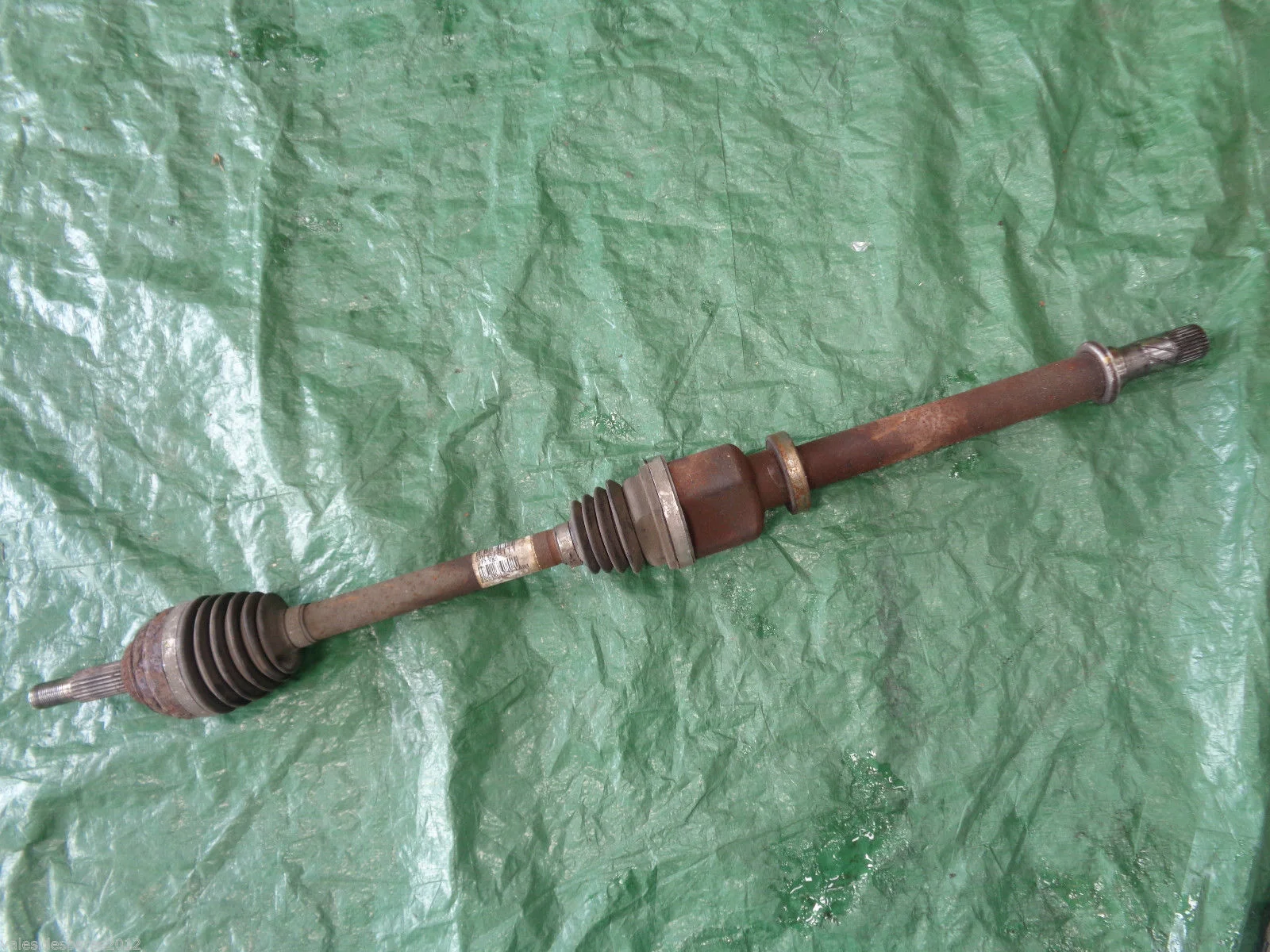

im not sure what u mean theevilgiraffe but at a guess, I replaced the drivers side driveshaft, the end of the shaft at teeth that slotted into the box/engine.
  172 cup
like my picture posted below ( is what I ended up replacing to get the car running ). I went to Renault and got a drivers side but didn't fit. im not clued up on cars but I could be wrong
I think he's saying the engine doesn't matter it's the gearbox and suspension that does.
  PH2 172
That's not a 172 Cup shaft, which would have no support bearing on the UK drivers side.

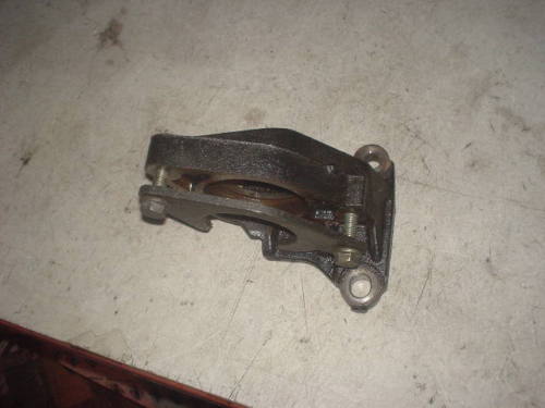

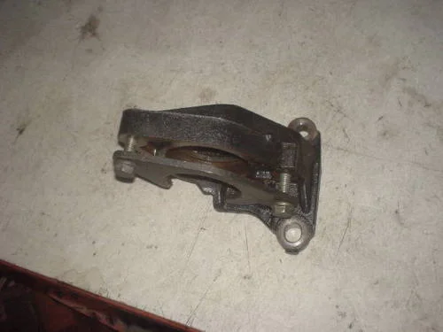

  PH2 172
If you have one of these bolted to the rear of the engine block, its had an engine/box swap.
  172 cup
thanks for the help I really appreciate it , the picture above is what my cup has on it so im guessing at some stage it has had something changed!
