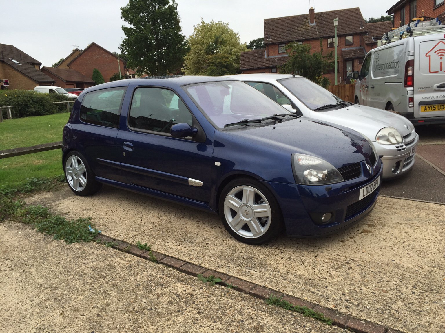

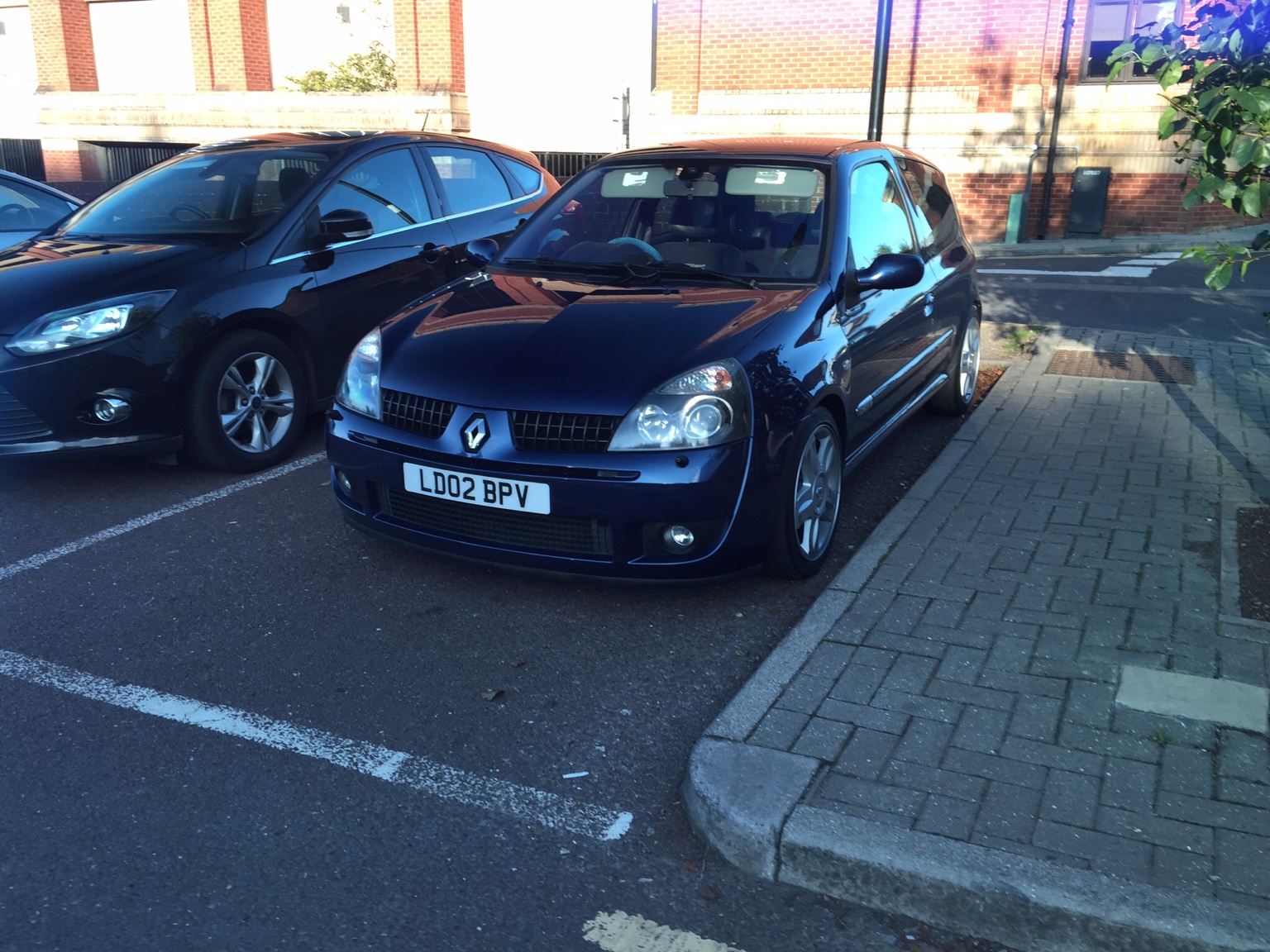

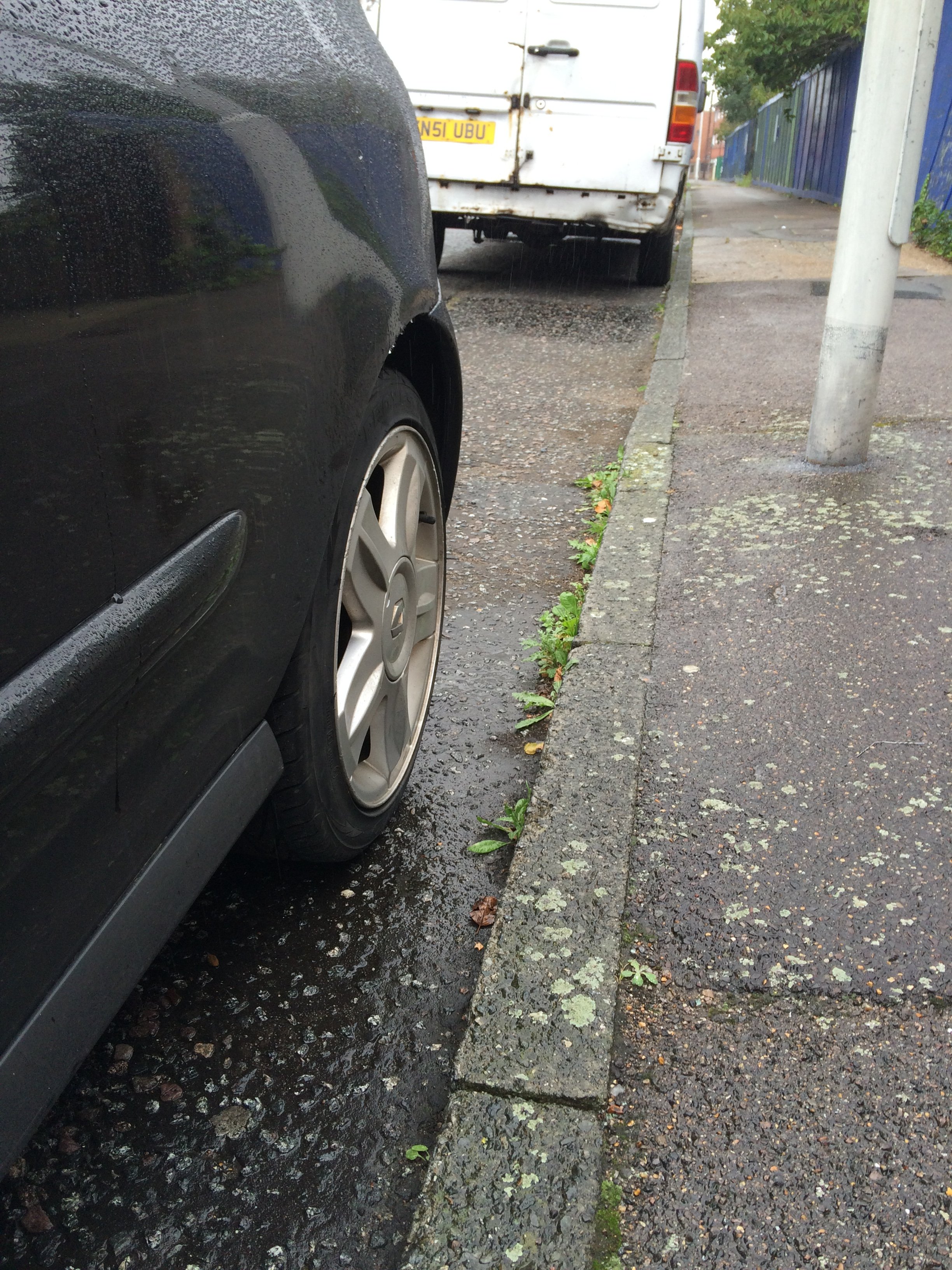

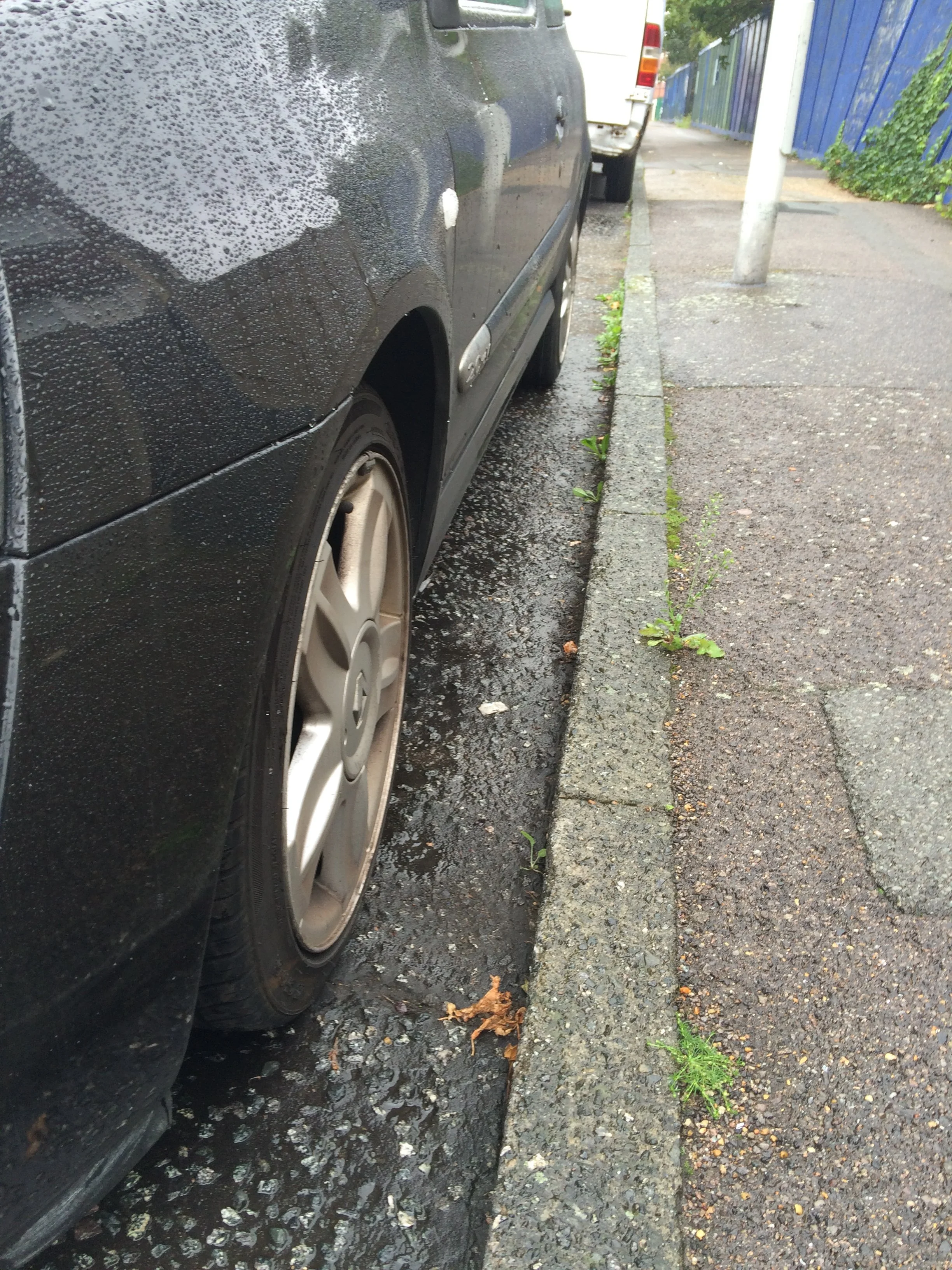

How wide looks right?
  PB 172 phase 2
I want to fill the arches out a little more. What size spacers for front and back so that it sits flush or just inside the wheel arch?

  Clio 2.0 16v 182
25mm for standard et
30mm won't poke out but will spray ground water all over the side of your car
  PB 172 phase 2
For the oem look I'd be going 20mm fronts,10mm rears.
Wheel spacers for the fronts, hub spacers fro the rears.
25mm looks too much in my opinion where as 20mm has a small tuck giving it the oem look.
Nice1. That's what I was thinking but needed an experienced opinion.

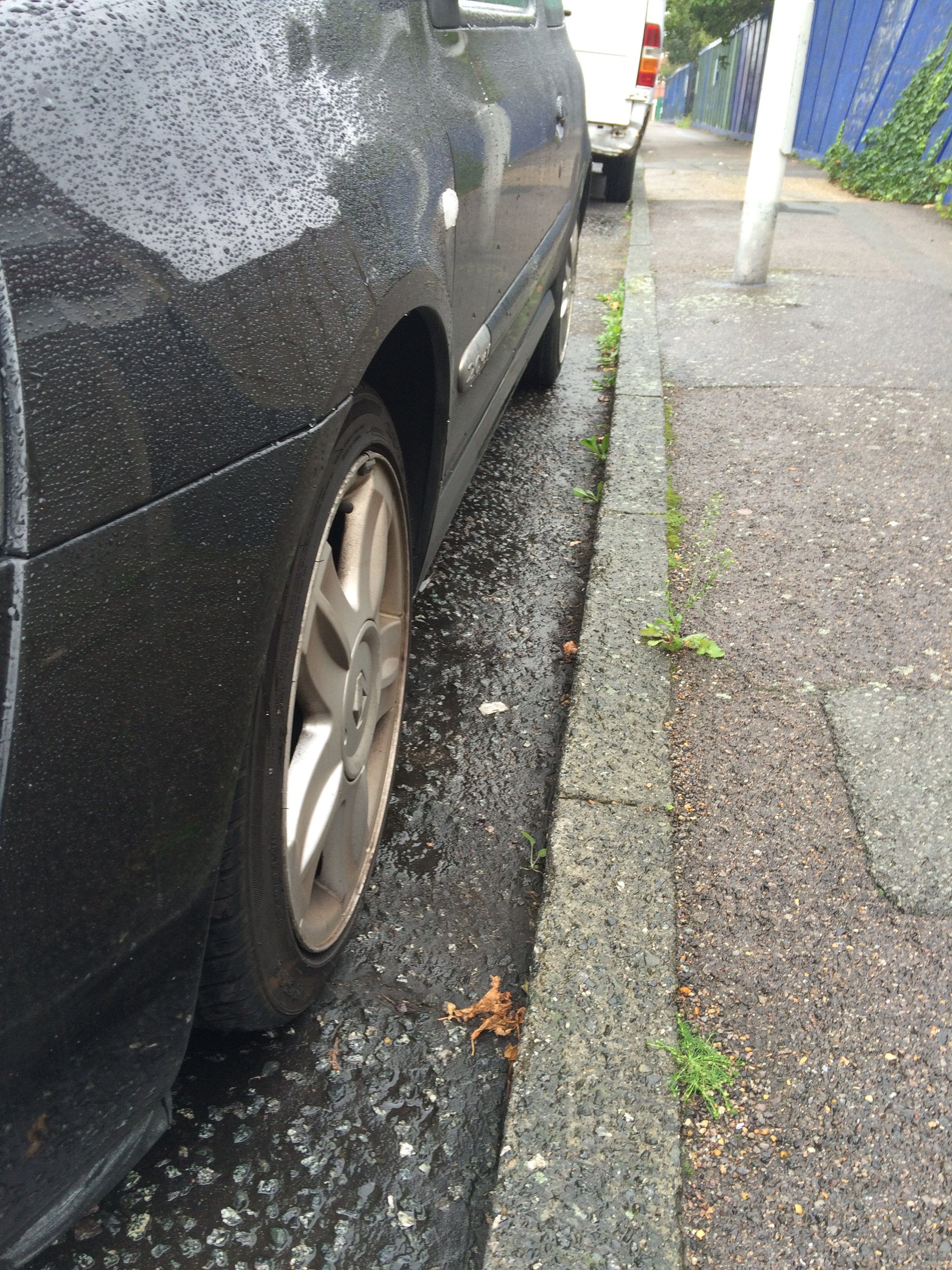

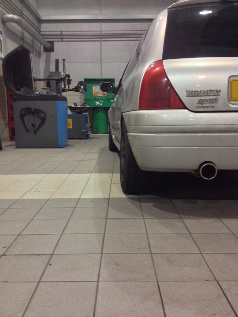

This is mine with same wheels as yours
Fronts - 25mm hub centric spacers with -1degree camber
Rears - 15mm hub spacers
Nice. Do you get any rubbing when turning? has it been lowered or is that the factorynsuspension? I read that theres -1 camber on the rear wheels already.
You said hub spacer for back wheels is that different to a hubcentric spacer? How long have you had them all on for? had any problems like bearings wearing out quicker or like I said before -any rubbing?
  182, SQ7, Trafic
No rubbing when turning.
It's lowered on Cooksport springs, so about 30mm.
There is about -1 as standard on rear

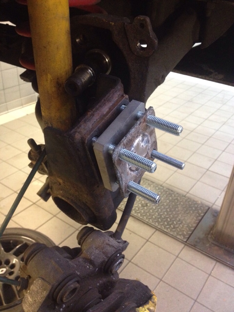

Hub spacer goes behind the hub onto the rear beam, much safer than wheel spacers.
I've ran 25mm spacers on the front on all of my Clios for the last 6/7 years, never been a problem. Rear hub spacers cannot effect anything as the same load is still on the bearing.

It's actually got 10mm rear hub spacers from a lad on here and some 5mm wheel spacers I had laying around.
Fronts are Delta Mics, they're steel so a little heavier but fine for all kinds of use.

10mm rear axle spacers are going on tomorrow. Will see how that looks on mine before purchasing a 5mm spacer like DannyR suggested.

I recently found out I actually have 15mm spacers with 5mm wheels spacers on the rear so 20mm total rear!
