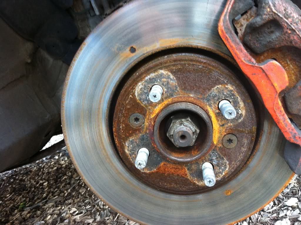

Cheers Tony. You guys have a stud conversion right? How do they bolt to the hub. My hub looks like this
Would you not just remove those studs bolt the hubcentric spacer on then screw the studs into the spacer or am i talking sh1t?
I'm not sure it's that simple. I may take the hub assembly apart tomorrow to see what's what. Woulda thought someone on here woulda known.

I'm not sure, I bought the car with the conversion fitted. I have to change the front disks soon so I'll have a good look when I do. Thanks for your help
You remove the studs from the disc,bolt the spacer to the disc with the bolts provided,then put your original studs(I would suggest getting new ones) into the spacer with a dab of locktite.

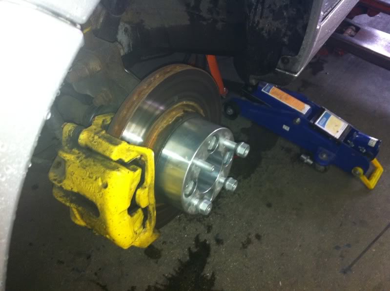

Iv been over 120mph with no shakes? proper spacers made well and torqued correctly = no problems ! (apart from bearings not lasting as long)
Really?? Do you use the plastic locating rings or anything? Must be a company who does actually make some accurate engineering for once ;)
Tbh I brought them second hand but can tell they are decent products not cheaap metals ect.... And no I don't have any locating rings I just run them as they are in the picture iv don't about 500 miles on them and they have been fine, all the bolts are still torqued correctly!
