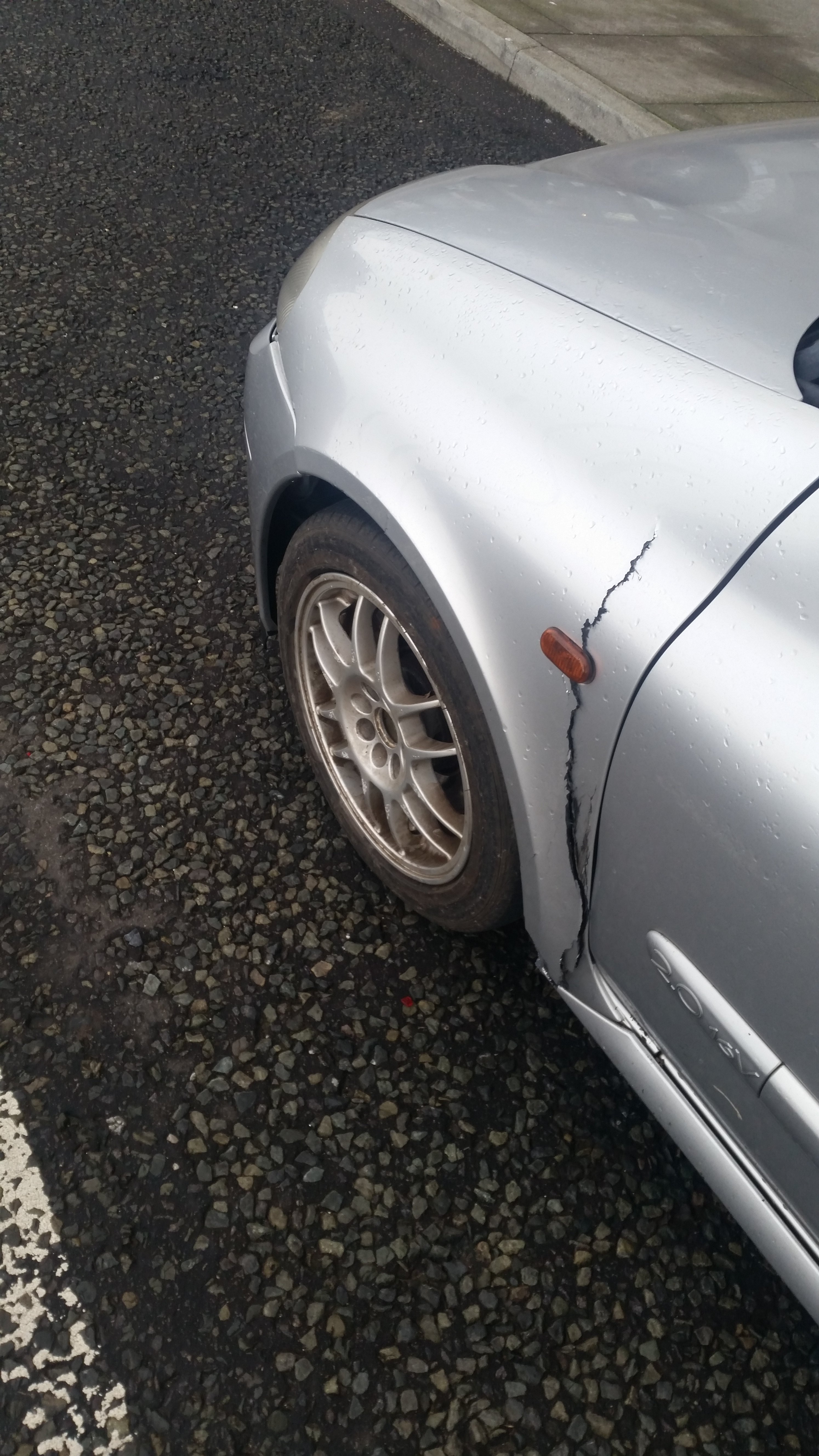

Ive had 2 pairs of 'high quality' (Eibach & FK) bolt to hub style fail on me now! the last set that failed the wheel actually came off and ripped my wing to shreds!
fortunately i wasnt going too quickly and there was no traffic about otherwise could have been a whole lot worse!
I dont trust spacers at all now but if i really had to for caliper clearance i'd get the ones like @barnesautos mentions.
Just to add to what i put above the FK ones cross threaded as the alloy was too soft (tbf could have been my own fault) the Eibach ones shredded 2 wheel bolts and the other 2 came lose hence the wheel coming off.

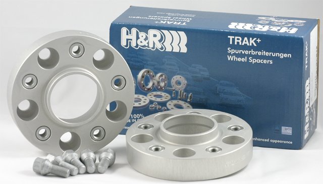

I've got a pair of brand new H&R Trak 20mm hubcentric spacers for sale. These require longer studs, which make it so much easier to change wheels.
Drop me a message if you're interested. Cheers.

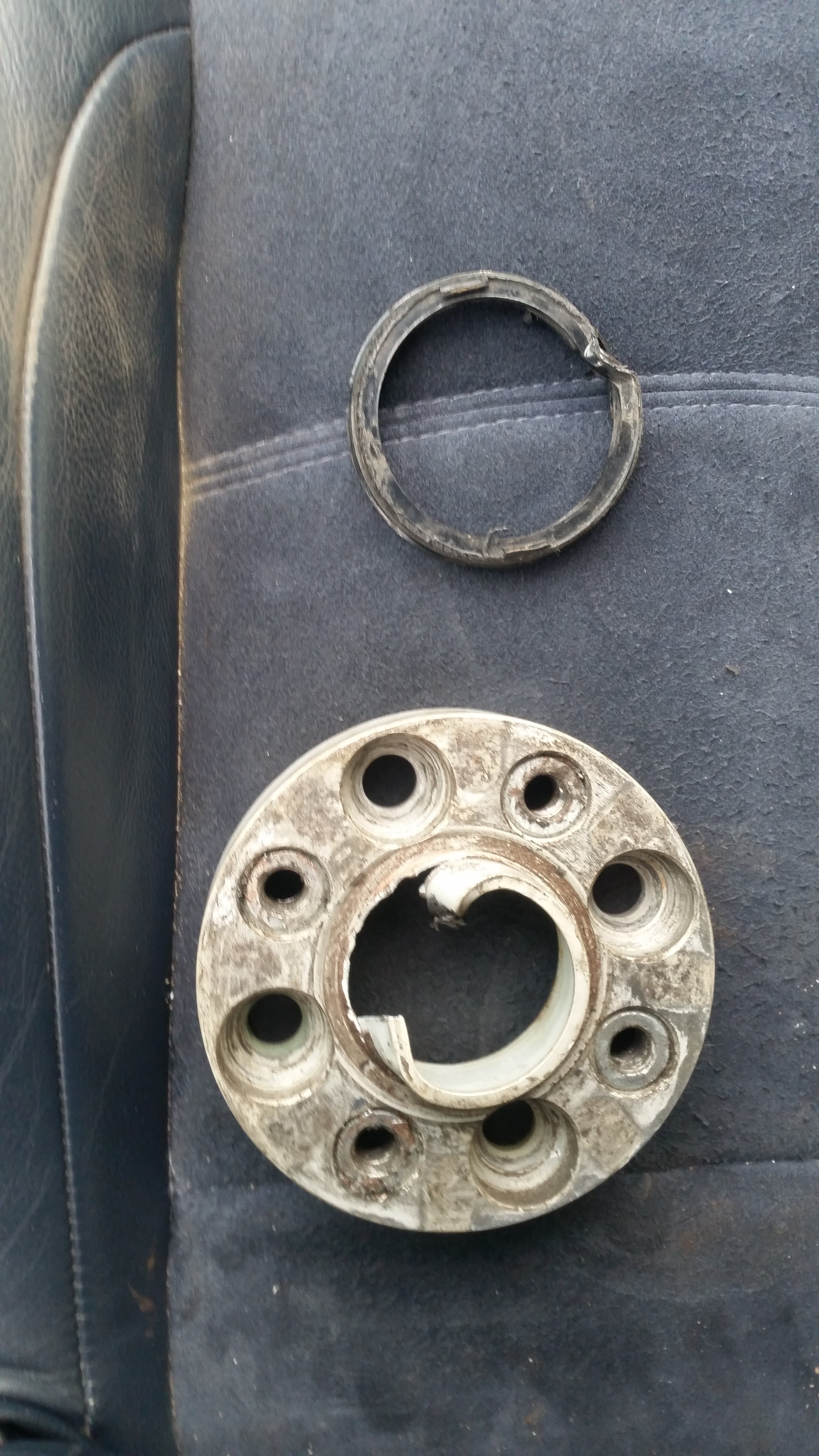

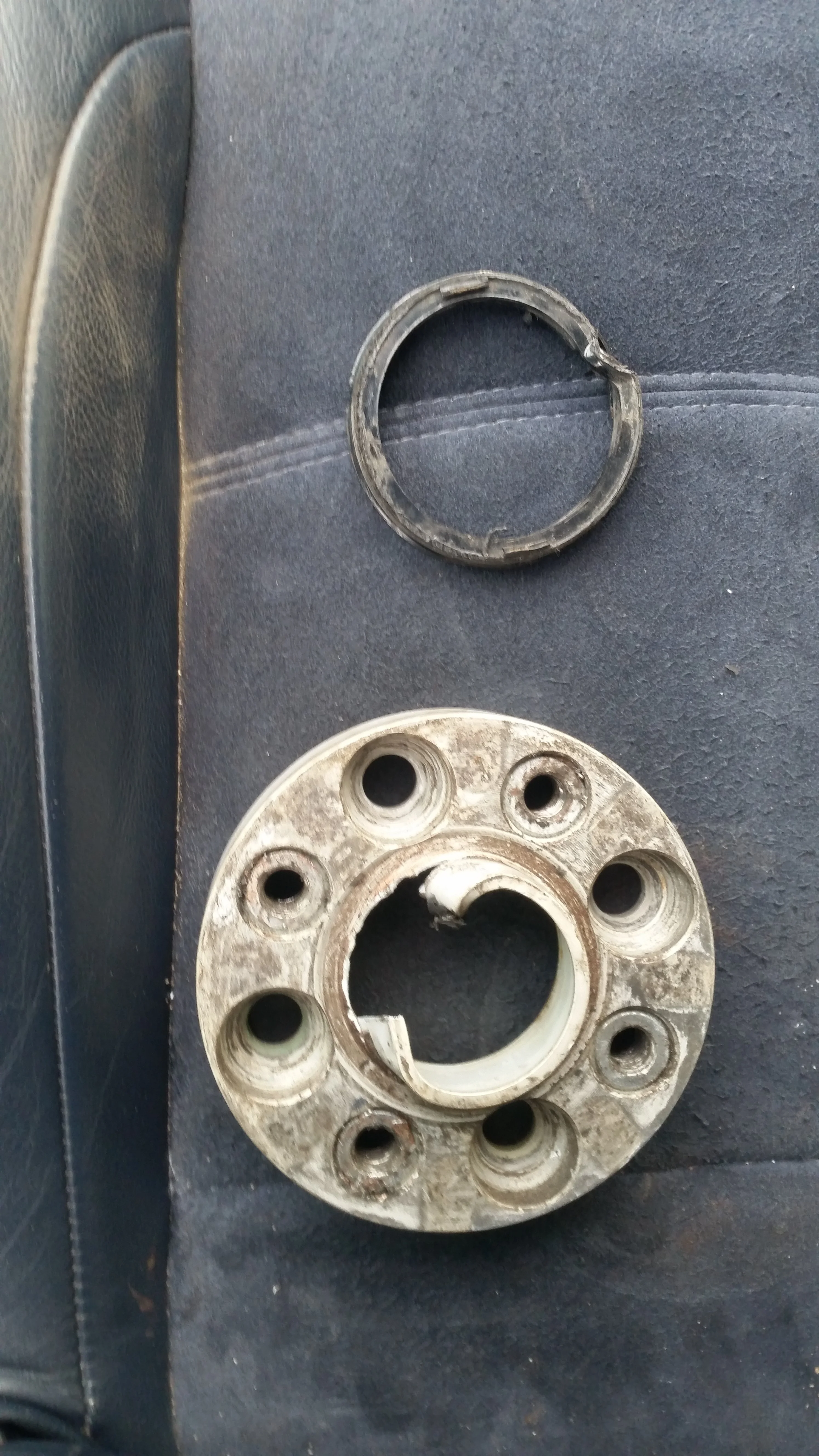

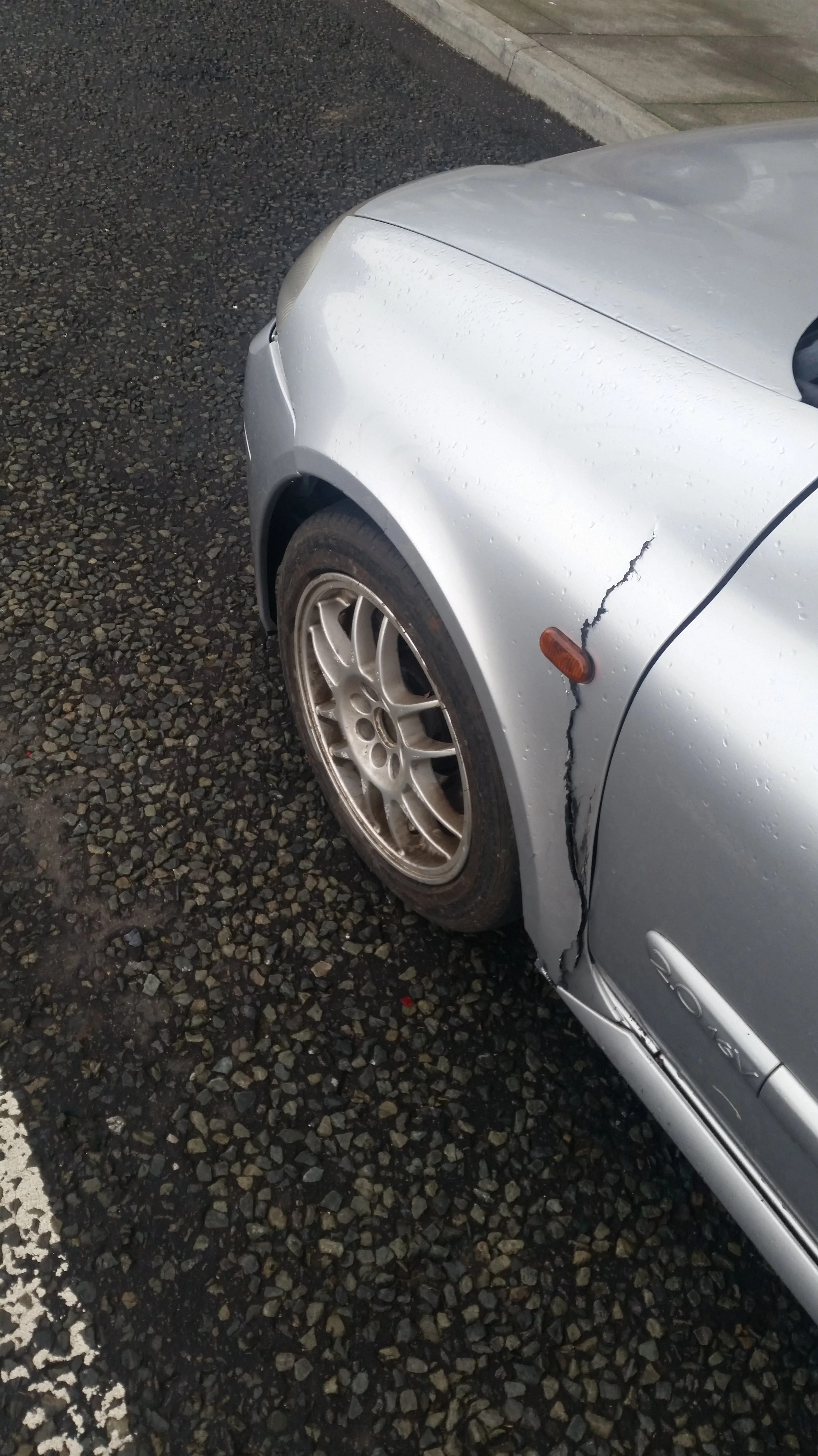

You raise a good point but strange enough the eibach ones with steel inserts ended up being the ones to strip threads on the bolts and ended up like this
How the f**k did you manage that?!
Genuinely what happened lol? Did not expect to see that!
And if they stripped the threads on the steel inserts, how were you tightening them and what steel is it do you know?
No idea buddy! Torqued them up to the correct setting and the same with the wheel bolts, not over tightened or anything.

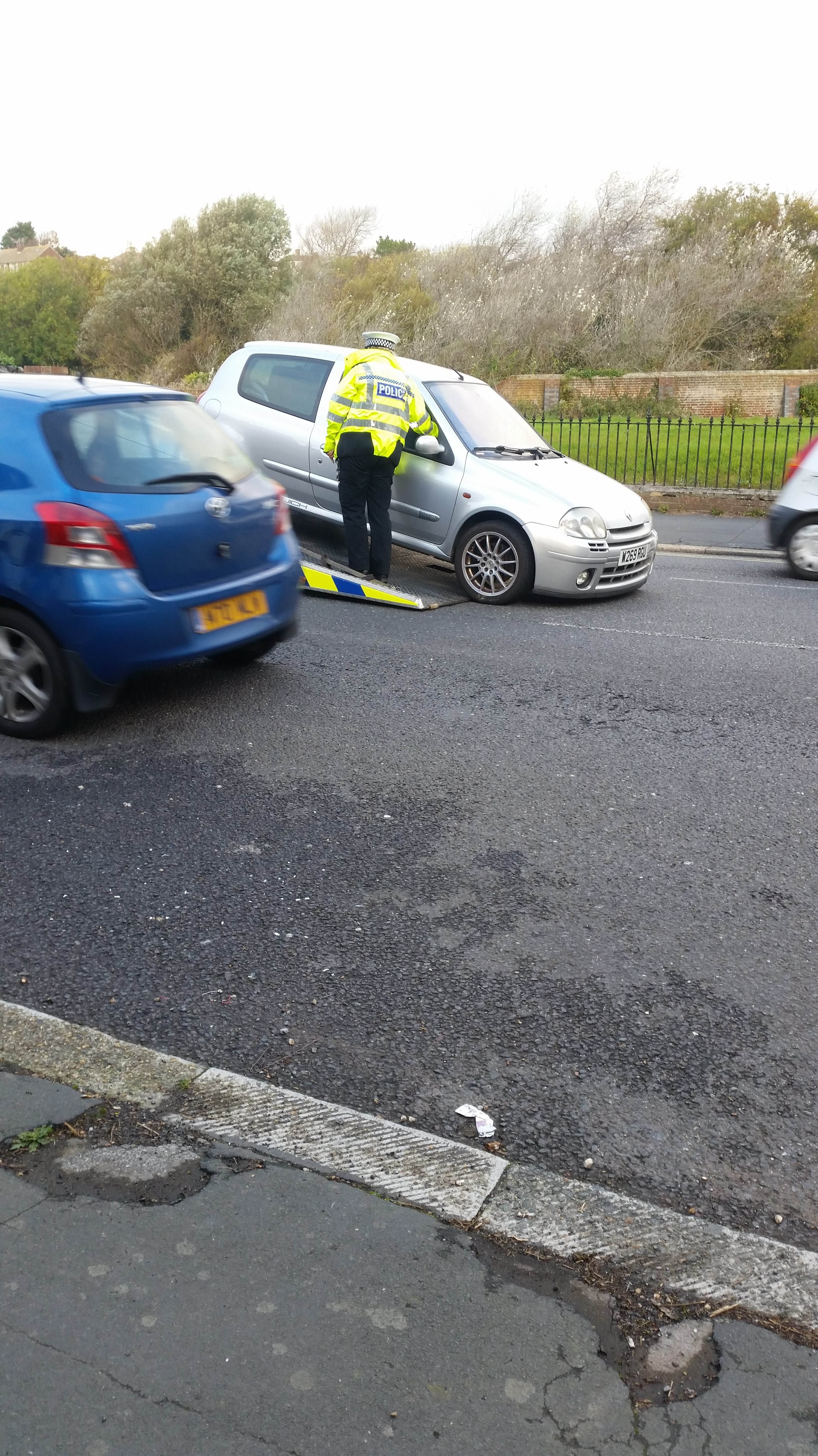

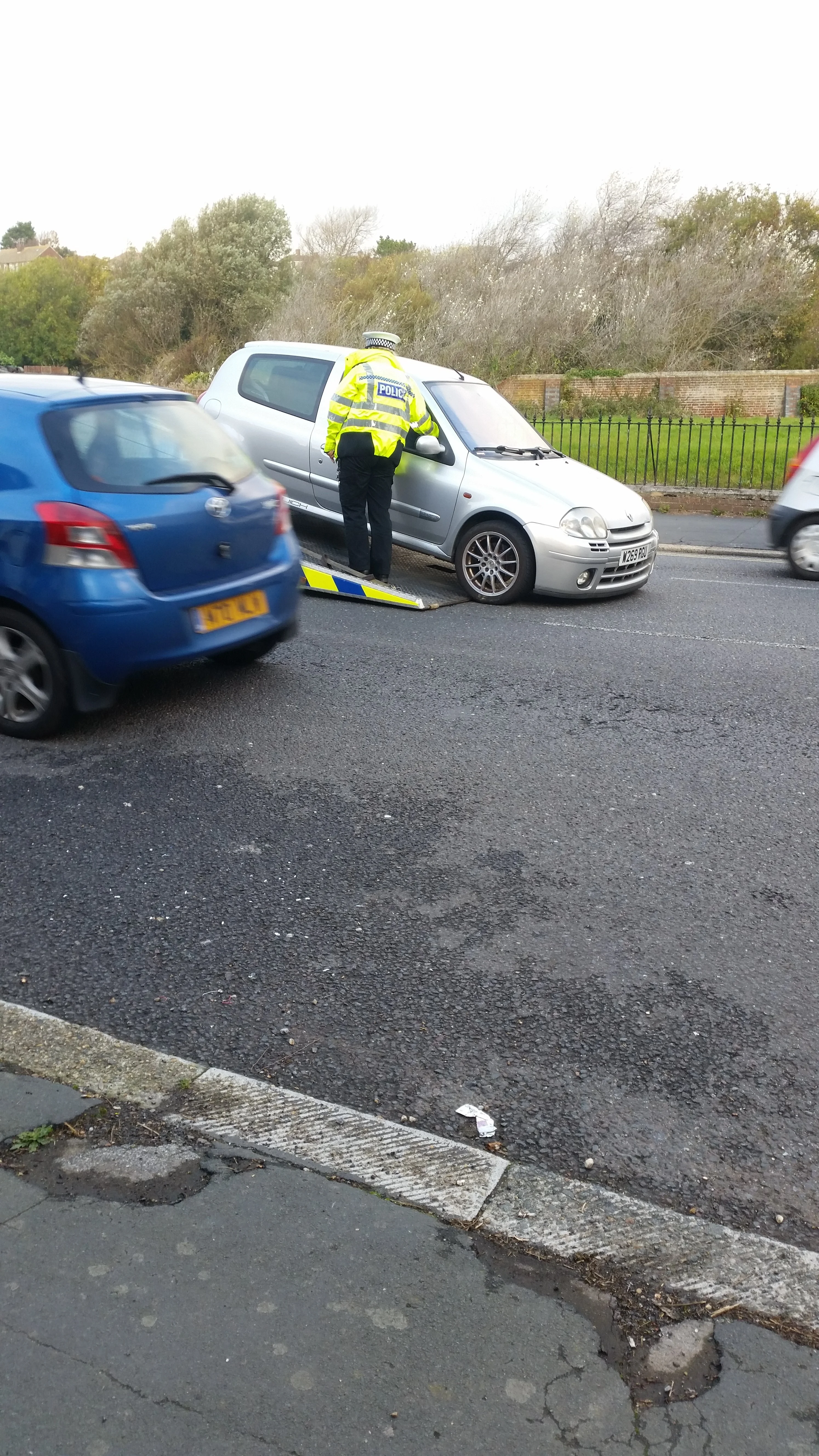

One day on way home from work I heard a knocking, thought my drive shaft had started knocking as couldn't see any issues in the dark.
Next morning I tried to drive it to my mechanics to swap over to a spare driveshaft I had waiting to go on then bang wheel came off and left me stranded in the middle of the a259
This was the result...

Wow! I think I'm going keep mine standard, even one instance of a failure is enough to put me off to be honest!! Thanks for sharing that info @Timmsy

Was it the bolts holding the spacer to the hub that failed or the bolts holding the wheel to the spacer?
It looks like the latter going by the pic
My purpose would be purely visual as mine is just a daily driver/occasional thrasher, but I've been put off now.. The 182 has a pretty good stance anyway on lowering springs, but spacers do look really good, however all 4 wheels staying on my car is also good!! :smile::up:
Bolts holding to the spacer. Original Renault bolts too. What I don't get is that they were fine for about 3000 miles of being on with the usual 1000 mile after fitting check too
I'm still baffled as to how it happened tbh
Hopefully you were just unlucky enough to get a s**t spacer. Did you buy them new?
Looks like the spacer wasn't made correctly I would have a serious work with whoever you got them off they owe you at least a new wing
