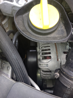

Hi, Thanks very much for the reply I'll have a check tonight after work I did take a picture of the area where the noise was coming from, it sounds like what you described, I'll have to see if I can upload it... I know its a horrible question to answer because of all the variables but if it is that do you have any idea of what its likely to cost at a garage?
Here's a pic of the area it was coming from in the vicinity of the black belt, sorry for the crappy out of focus photo, my iphone focused on everything bar the thing I was trying to get a pic of! :( .

That's a pic of the auxiliary belt, it could be one of the tensioners / idlers humming.

As a quick update I've just dropped it in the local garage the first thing he said was something to do with 'tensioner' alternator bearings and pulleys? But he said to give him a couple of hours and he'll button down the issue and give me a quote :) hopefully it won't be too costly

You sir are in fact a genius!! You were absolutely right :D
I've just literally got back from garage now, in case anyone's interested it turned out to be an issue with the tensioner pulley bearings which had damaged the auxiliary belt according to the garage, so they replaced both and it now runs like a dream
