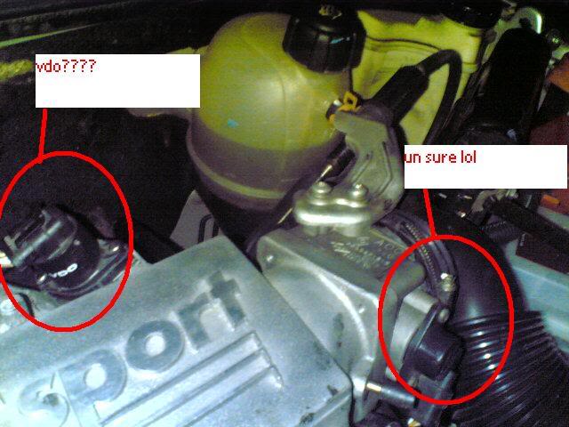

Heres the Idle control valve and think thats the fuel tank breather in front of it. The pipe on the ISCV leads to the induction hose. The oil breather pipe is connected under the throttle body.
Manifold pressure sensor is in place.
Temperature sensor is also in place.
Everythings where it should be, everythings sealed, bolted, tightened.

Ive also got two errors logged on my dials, T & J if you do the diagnostic thing.
mmmm i havent got these. wierd. its pissing me off! just donr want it to be the map sensor, wonder how much they are!? did you clean you t/b ? i did this when it was off?
wondered what the lil black sensor does on the front of the t/b too?ill get a pic
Yeah I cleaned it too had a fair amount of deposits on it.
The throttle position sensor, when the throttle opens it turns a little wedge thing which moves the sensor. Checked that too! Turns ok :/
I dont see how its not like I was rogering it open or anything just gave it a quick wipe...
No tps is nothing to do with the air it just tells the ecu the position of the throttle plate thingy.
kkk, all im wondering is if the tps is damaged and its telling the ecu a funny reading and the vdo is trying to correct it with the air flow change
but, if t/b is closed and vdo is sealed with ur finger? and it still idles a lil over then it MUST be getting air from somewhere
