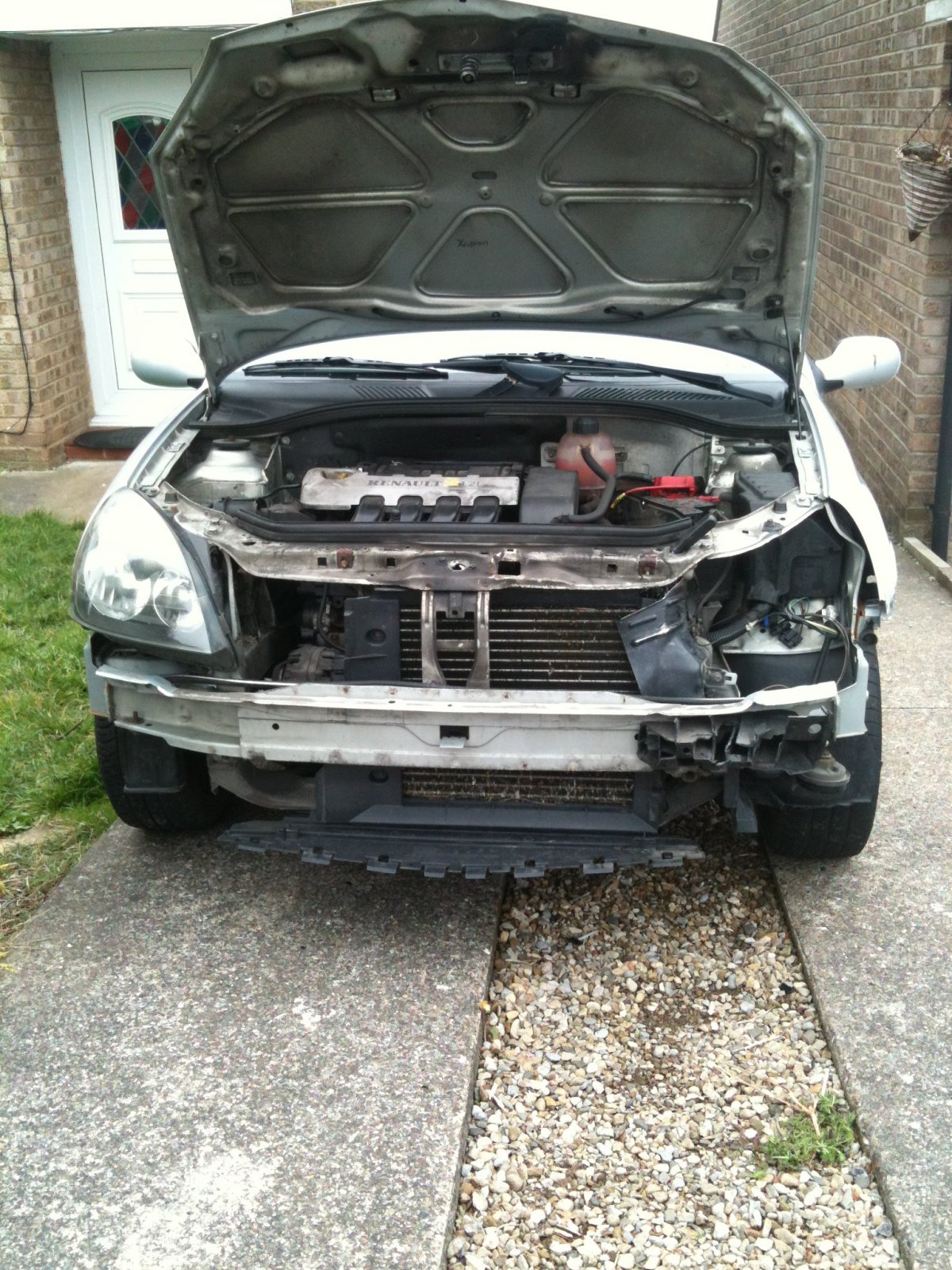

A few months back I had a (I would class it as serious) bump with the barrier. I had nearly bald tires on (I was waiting to be paid from work before I get new ones, 3 days away) and I was going round a right hand bend on a road (it was pouring down with rain, and I think I hit a patch of oil on the road) when my clio started to drift to the left. Panicking I tried to turn my wheel the oppisite way to correct the drift, which did not work... Anyway.. I ended up hitting the barrier at around 30mph and smashing the left hand side light in, denting the bonnet and completely destroying the front bumper. The front crumple bar (I think that's what it's called) was pushed in a little. It ended up costing me £450 for everything to be repaired! Metal pulled straight, new bumper (colour coded), new bonnet and a new headlight. All looks good as new, as if nothing ever happend, not a trace! BUT..

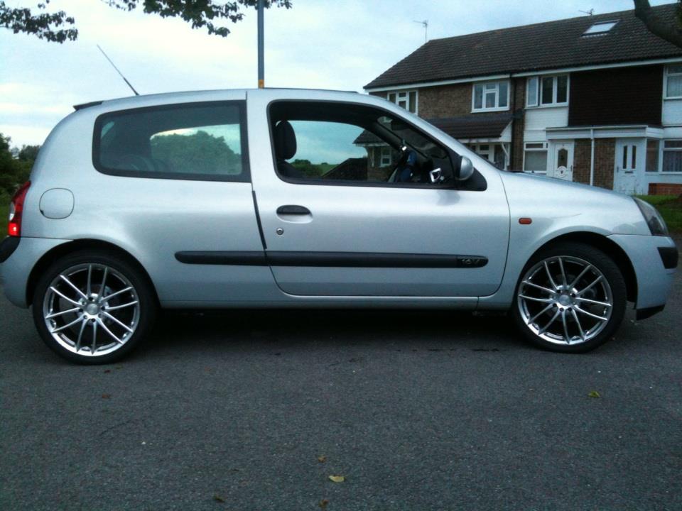

The car now feels diffrent... Since then I have changed my alloys, I have a set of 17" low profile BSA Arrakis on (http://www.kentcustoms.co.uk/acatalog/4x_17_Inch_BSA_Arrakis_High_Gloss_Alloy_Wheels_With_Tyres.php) and every time I go around a corner it feels like the car is "snaking" or "drifting" or wanting to drift. I can't describe the exact feeling but it does not feel like it used to. My tracking is also slightly out (tracking has NOT been done since changing my alloys from the standard ones, I have no idea if this could be it?). Also a few days ago I found the nut on my front suspension to be lose (under the bonnet) I tightened that and it feels a little better but still not the same.

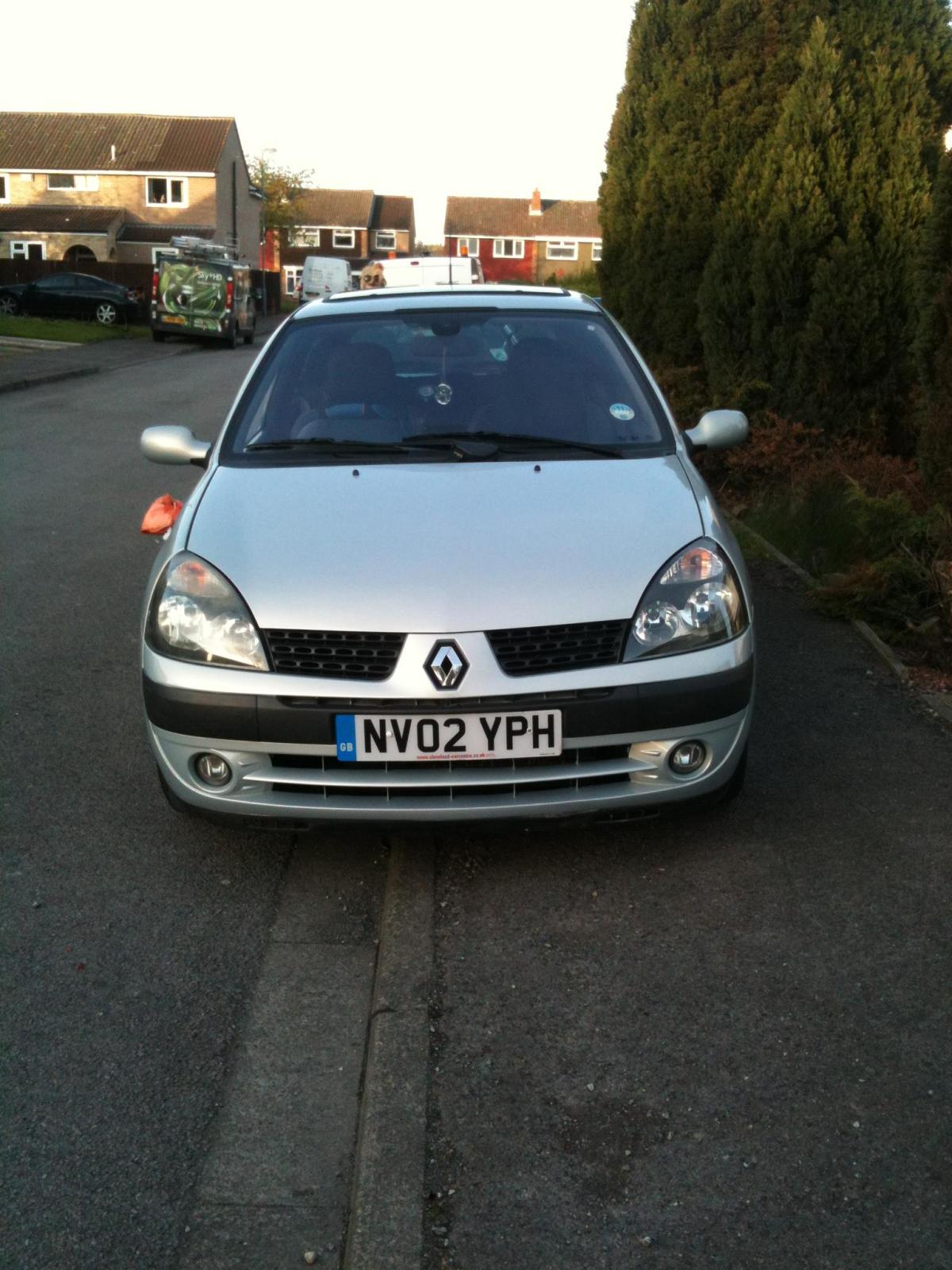

My car after the crash:
My car after its repair:
My car with its larger alloys:

I assume the suspension is standard by the height in the pictures. Excessive body roll will make the car feel "light" and wobbly through the bends and even more so the bigger wheels have given the car a higher center of gravity which is also adding to your problem.
I would make sure all the shocks are in full working order and fit some decent lowing springs. I bet this sorts your problem. ;-)
