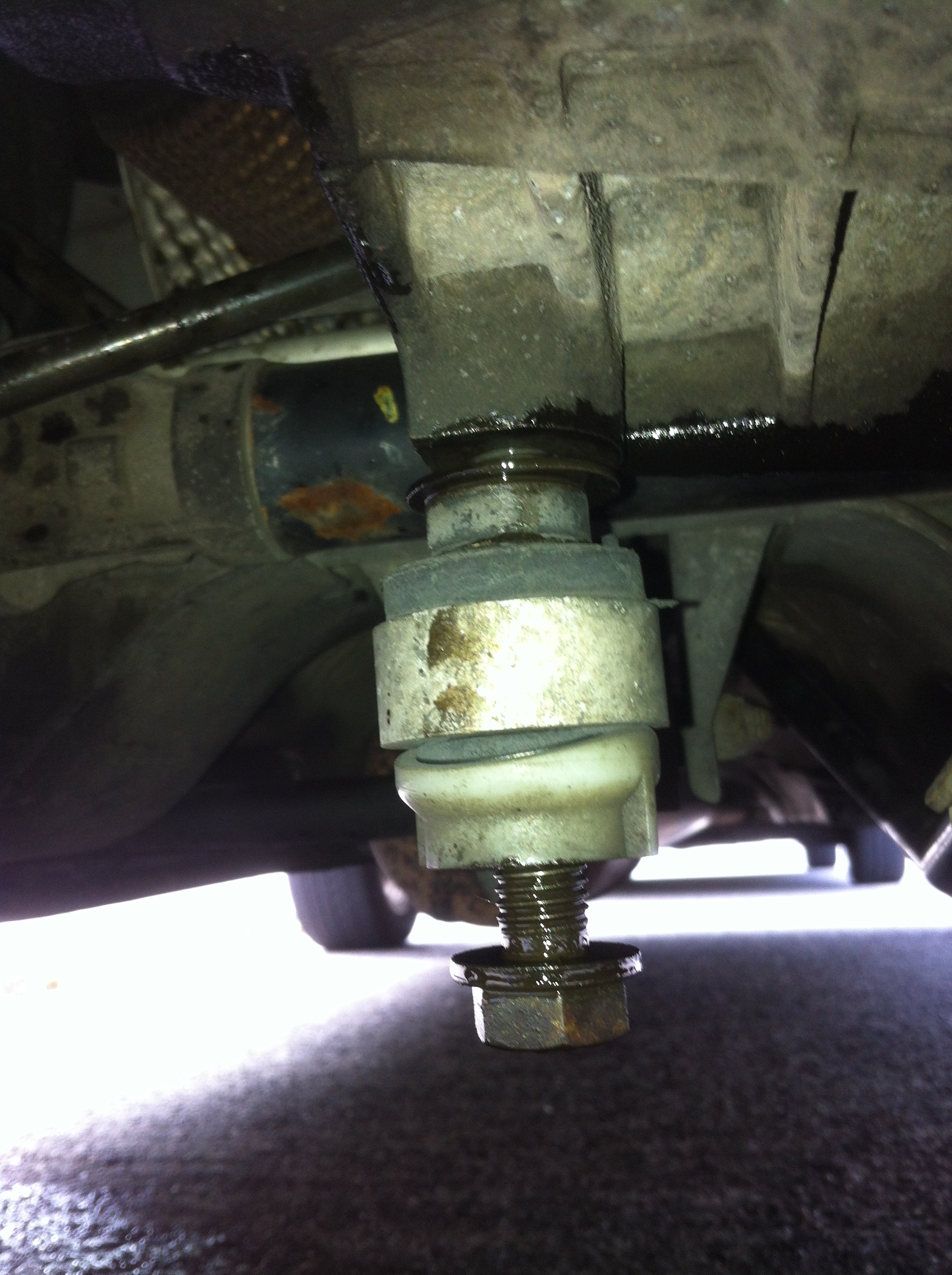

I thought my gearstick was a bit wobbly.

(By the way, that's not oil, it's water from the screenwash bottle!)
Had this happen to me too haha, thought it was a little more jerky than usual (after having the dogbone replaced!), happened to be at the ramps, stuck it up and viola, loose dogbone bolt, bit of loctite-red sorted that right out!
