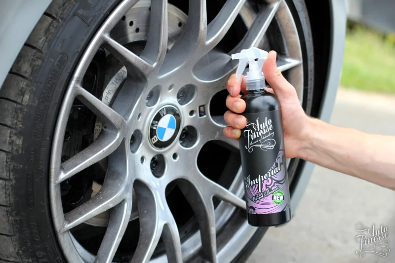

Spray and rinse:
With the new and improved Imperial formula we have developed its ability to cling to dirt for longer. This means that for those weekly washes where your wheels aren't too dirty you can perform a touch-less wash.
As soon as you spray the improved Imperial formula onto your wheel you will see Imperial start to separate the contamination that is sitting on the surface, this will also show off its abilities to cling for longer. This longer cling time will intern mean the cleaning and degreasing surfactants in Imperial are held in contact with the dirt & brake dust longer, making them more effective.
Once you have allowed the product to dwell on your wheels it’s time to rinse away the dirt and contaminates that were on them. Simply grab a pressure washer or garden hose with a spray attachment and rinse away the dirt. Dependant on how dirty your wheels are this could be the last stage on your wheels. The improved cleaning power and clinging abilities are what makes Imperial perfect for those quick and simple weekly washes.

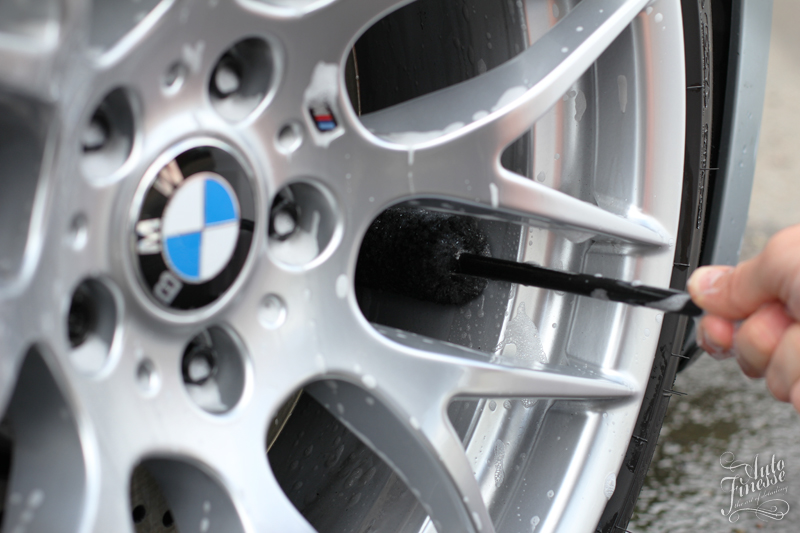

Agitation:

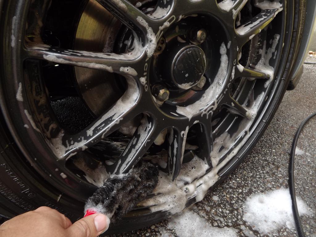

If your wheel needs a little more attention or your car is under going a full detail it may be time to grab your Hog Hair Detailing Brushes to agitate any last grime and dirt away from your wheel.
Here you will see Imperials next improvement, its higher foaming rate.
After much feedback we found that you wanted to see a higher foaming rate from Imperial, and in this new improved formula we believe we have achieved just that. Even after a long dwell time where most wheel cleaners would go flat Imperial will still easily foam up and carry away any dirt or contaminates from your wheels surface.
At this point we used our Hog Hair Brushes and a medium sized wheel woolie to agitate any baked on grime. The Hog Hairs longer bristles came into play, allowing us to access the tighter areas on this particular wheel design.

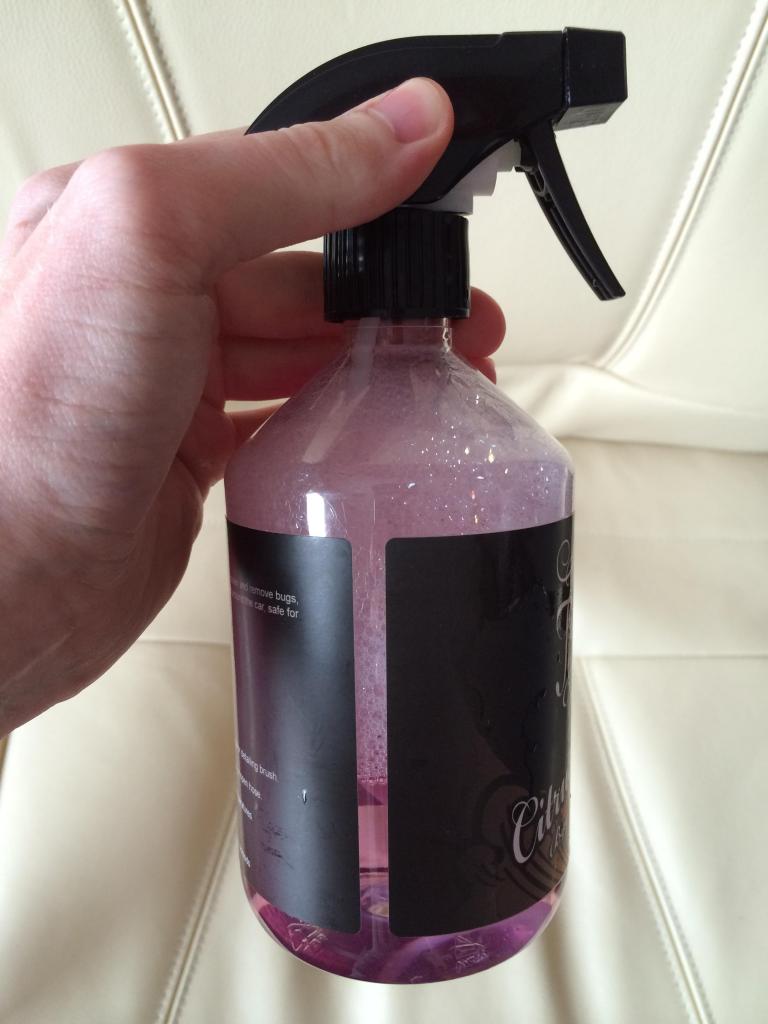

So was given a bottle of the newly improved Imperial the instructions stated you can dilute with water to suit. As the wheels was fairly riffy after a month of not being cleaned, thought i would knock up imo a fairly mildish mix.
When imperial was poured into the spray bottle it was pretty thick and had a weird smell that i can't put my finger on.
This is how much neat product i put in, just under the label on an old CP bottle.
Diluted it down to near on 500ml

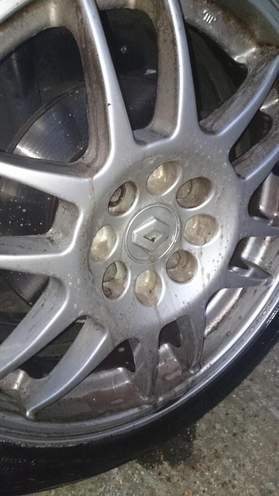

Filth i was up against
Jet washed loose dirt.
gave a decent spray of imperial all over the wheel and left to soak for a minute
Agitated with a stiff brush which helped froff up the solution
Went over with a smaller brush to get in the nooks and crannies
Left it to dwell
After 5 mins of sitting Imperial held its own and stayed pretty froffy and clingy (well impressed)
Rinsed it all off and gave a shampoo and another rinse, there was no dirt left to shampoo of tbh.

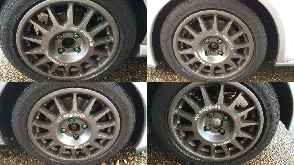

Quick 3 pictures here all done within a couple of minutes.
Dry dirt
Spray imperial and agitate
Rinse and 1 months worth of brake dust and dirt gone

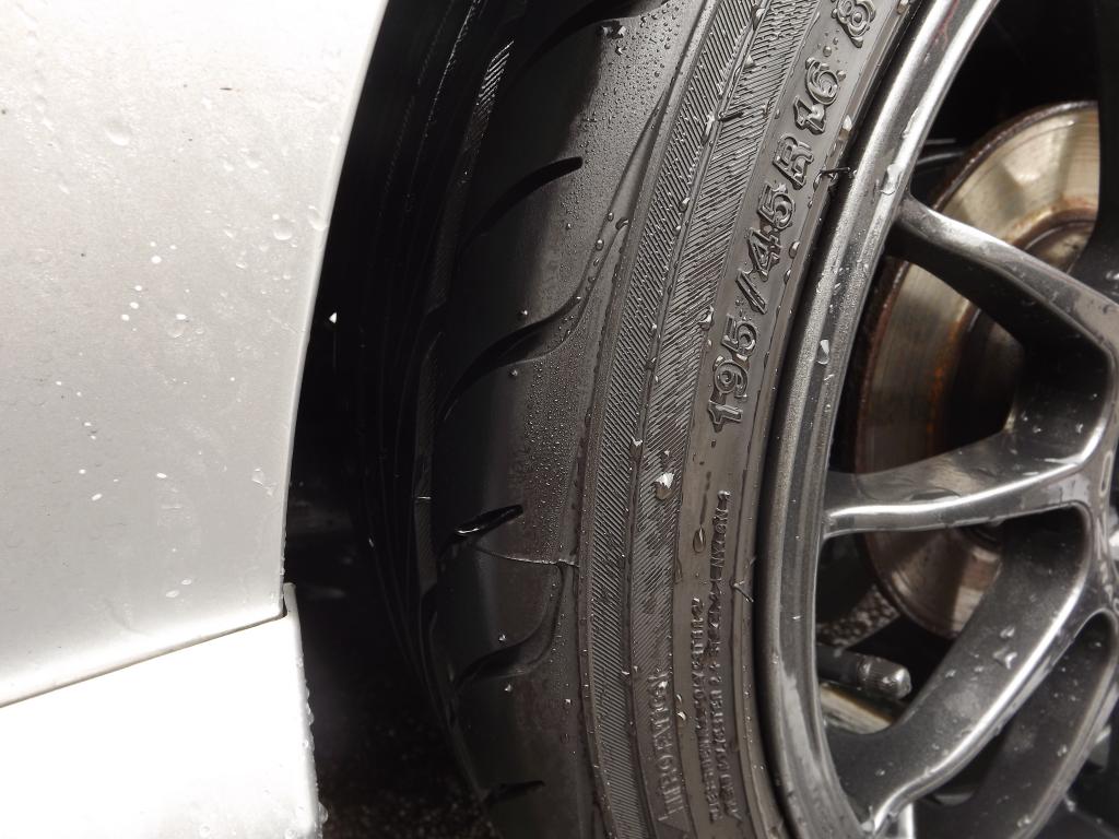

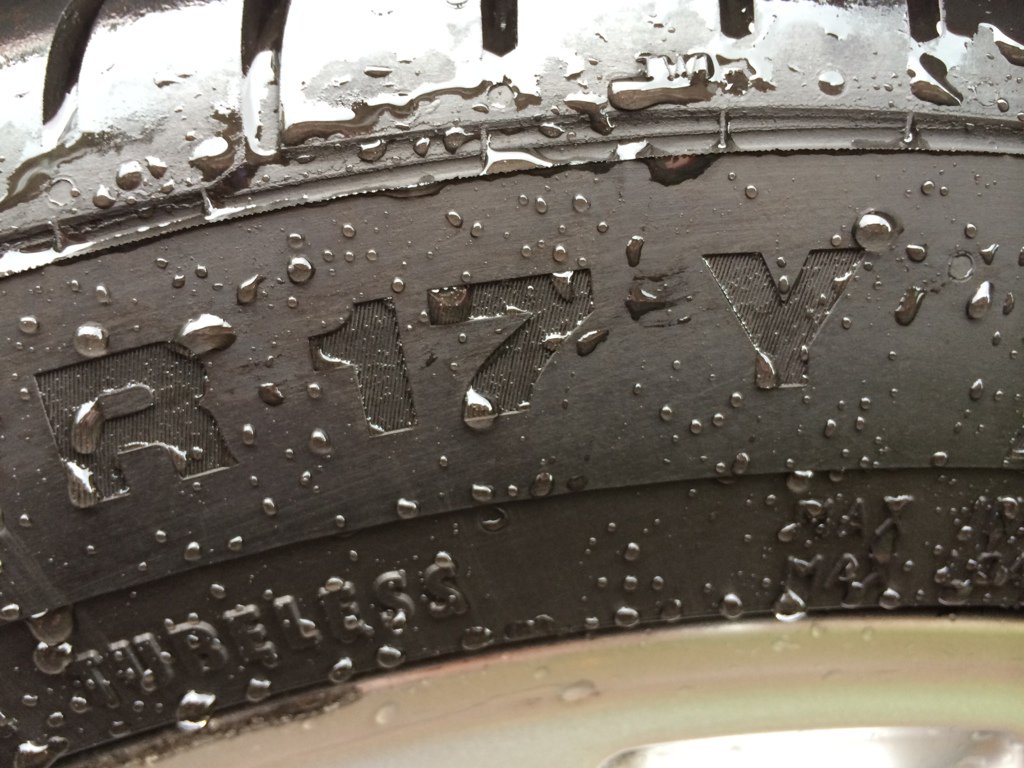

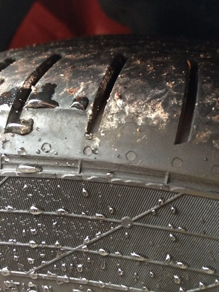

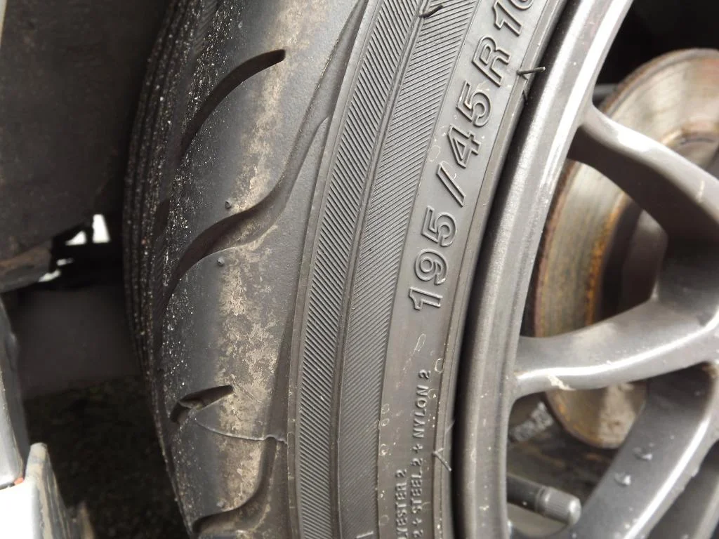

Onto the Tyres which i have had a nightmare with this brown edge of dirt and dust that won't shift.
Again sprayed and agitated imperial and left to soak for a couple of minutes
Rinsed off and the brown mark round the tyre wall has gone.
Quick wipe over to remove excess water and they have come up like new :D
Applied a thin coat of megs tyre gel then wiped away any overspill. to then be left with very fresh looking tyres and wheels.

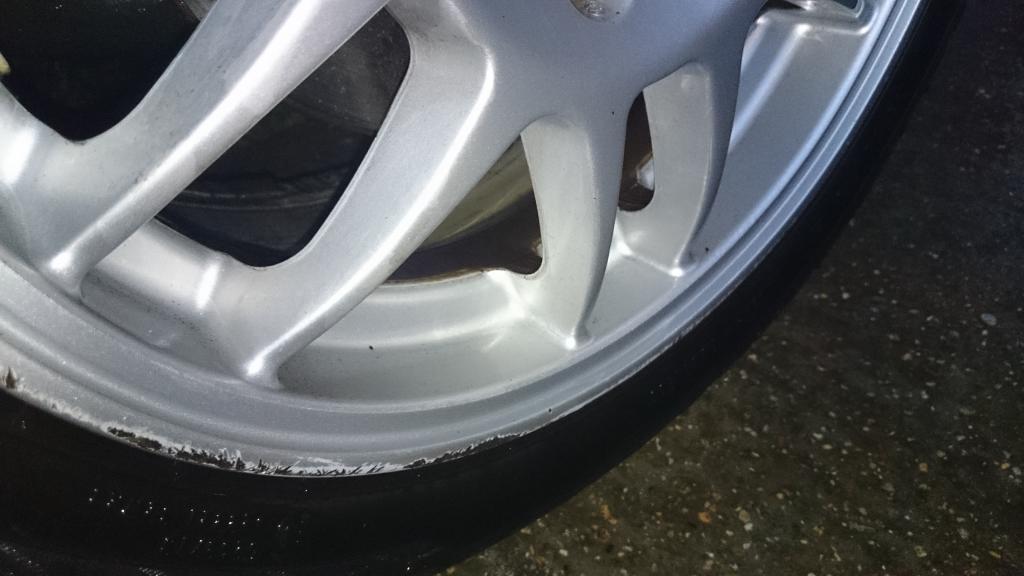

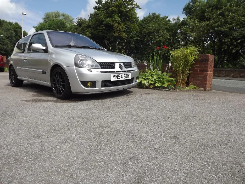

Few finished shots(excuse the discs lol) also still wearing the coat of illusion from the previous test.
All in all im over the moon with how imperial works really really impressed, i even reckon i could use a weaker solution and would still do a great job.
This is something i shall be getting in the near future to have in my collection and can see a bottle lasting a very long time, One thing i would like to know is it sealant safe? as i plan on tough coating my wheels at some point.

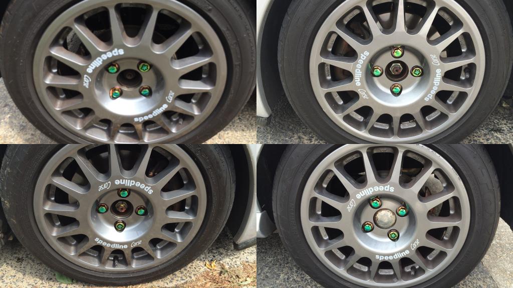

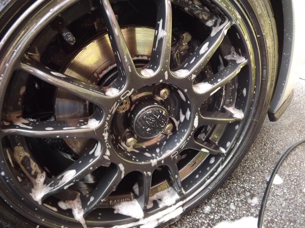

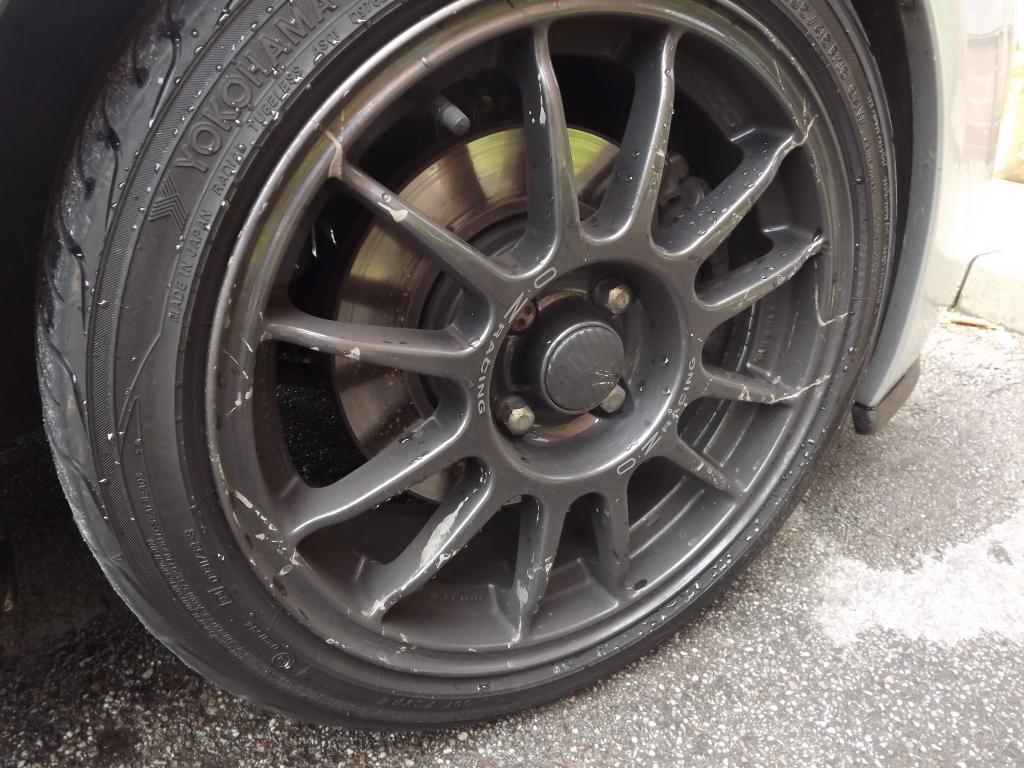

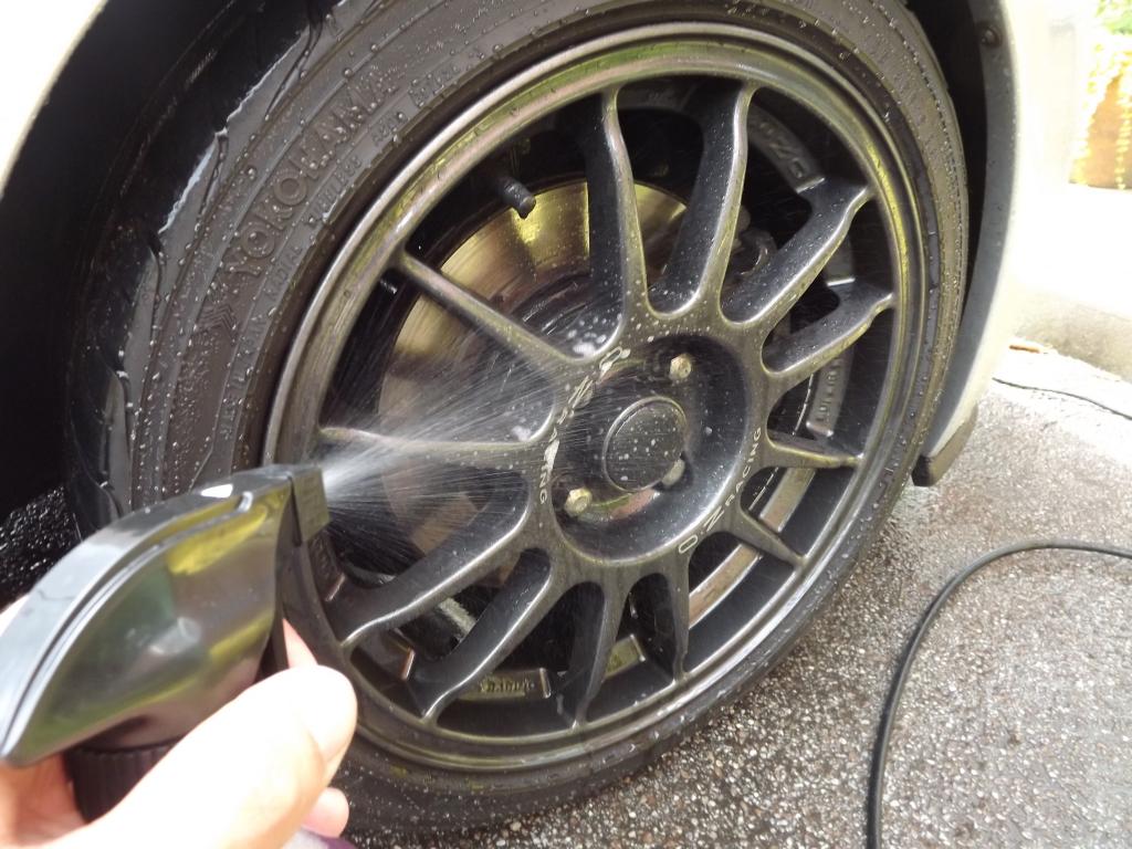

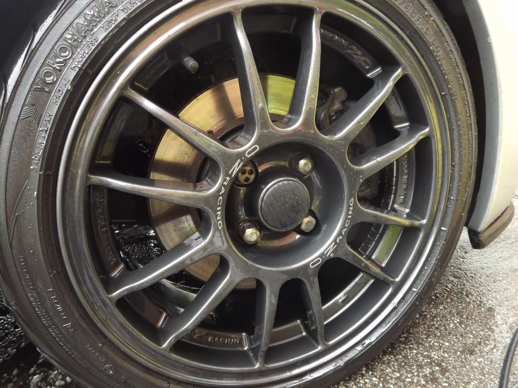

Wheels, pretty much my favourite thing about my car! Got quite a few spokes on the 2118's but I still enjoy cleaning them as they look great when polished up. Usually I just jet wash the dirt off, whack some Iron-X on and polish them up. I basically sought to replace my Iron-X stage with Imperial. Not because they're particularly similar products, but just to see what I could shift from Auto Finesse's finest on it's own. I only had a slither of Citrus left so finished that off and had an empty bottle to play with...
My car actually hadn't moved in over two weeks as I've been getting the bus to work whilst recovering from an eye operation, so they were quite nice and mucky! On the paperwork it said you can vary how much you water this one down. I decided to go somewhere in the middle (1:5) as although the car hadn't moved, they weren't that bad before it got parked up! Anyway, this was my starting point including a few lovely cobwebs...
I drove off to the jet wash and sprayed most of the s**te off, then applied a thick layer of Imperial to soak in whilst I attacked the bodywork...
Gave them a going over with a big brush, although I definitely need to invest in a smaller one to get into those nooks and crannies...
I worked my way round polishing the bodywork before going back to the wheels...
There was still some muck on them so decided to give them another smaller going over with Imperial...
There wasn't much left over the second dosage. I slapped on some polish to finish them off and this is the final result! Quite pleased tbh...
Although my normal method for wheel cleaning is quite simple, Imperial seemed to do a great job and it's just so simple to use I can see it easily working it's way into my cleaning rota! Good job Auto Finesse, and thank you for another brilliant tester :)

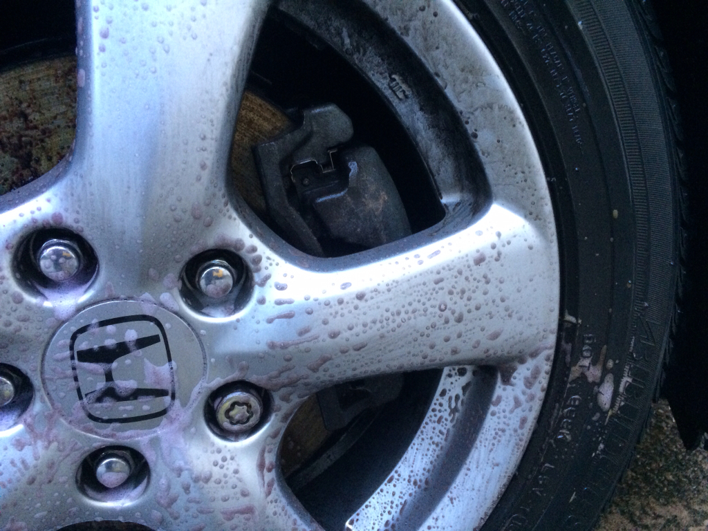

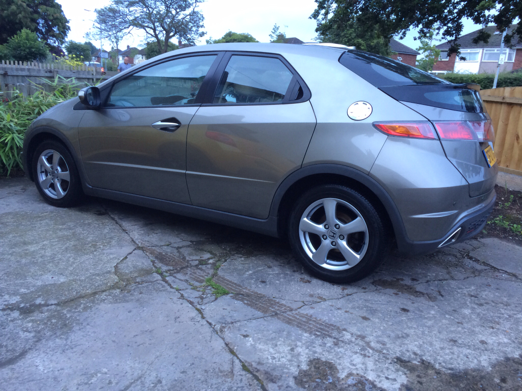

Auto finesse imperial

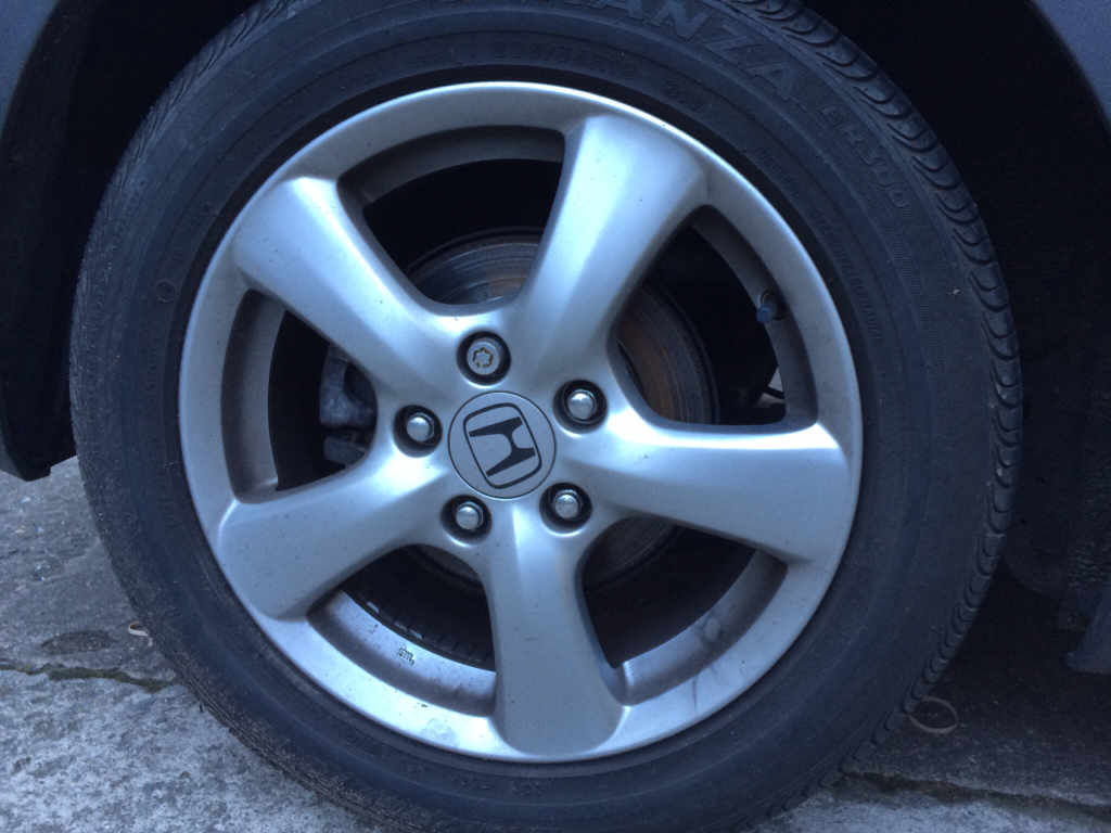

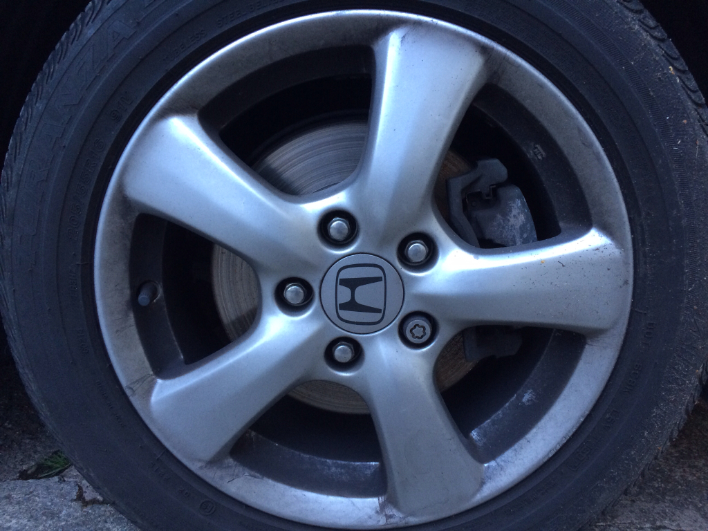

I tested this against my current favourite wheel cleaner Wonder Wheels Hot Wheels.
Dirty civic wheels
The rears weren't that bad
The pressure washer took the majority of the muck off, the odd application of tough cost does these a world of good.
Stubborn bits on either side, perfect to test imperial against wwhw

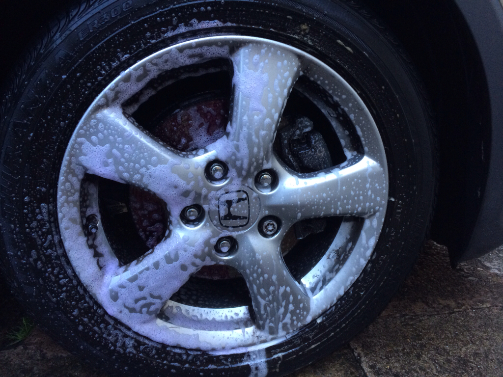

Imperial diluted 1:3 (imperial:water) which I thought was an adequately strong dilution
Imperial on the right side, took a few pumps to get it to foam up
Hot wheels on the left side
The first thing you notice is how thick and clingy the hot wheels foam is against imperial
The passenger side was purely imperial
Agitated
Hot wheels still clinging a little better/remaining thicker
The purely imperial side
And pressure washed off
Little bits of tar/brake dust remaining
Overall though, they both cleaned equally well
Although I preferred the consistency of hot wheels, they both cleaned as well as each other. Which makes me consider price for the first time in a review.
Hot wheels was £5 for 750ml iirc
Imperial is £8.95(500ml) or £12.95 (1l)
Making hot wheels £6.66 for a litre and imperial £9.72 for 750ml (based on the litre price)
If my maths is correct (correct it if it's wrong!), I think wonder wheels has the edge over imperial. For me anyway.

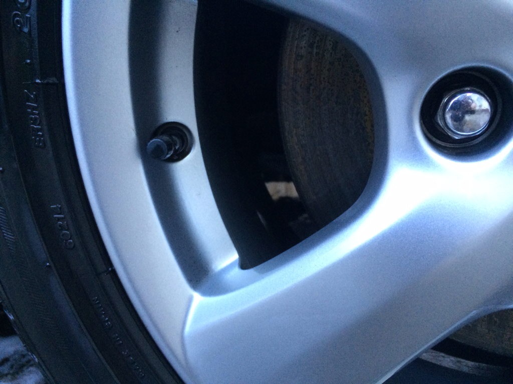

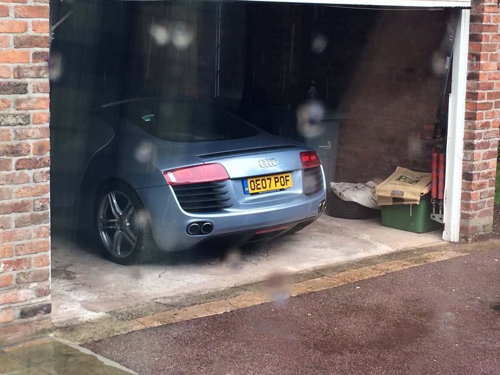

Hi guys,
Thanks again to Auto Finesse for the delivery and chance to test the new formula Imperial acid free intensive alloy wheel cleaner.
I've tried the previous incarnation before, when it was included in my waxybox a good few months back. I remember being impressed at the time as my wheels needed cutting back through the grime to seal back up again. Although in a poor state of repair, my wheels are rarely without protection.
On to the trial and 400 miles of B road blasts and motorway grime from the trip back up North on Thursday night - christening this weekend so prime one to get her cleaned up.
Three tests here as I've found different dilutions work in different conditions.
1:10 for cleaning heavily soiled wheels
1:20 for cleaning light soiling
1:2 for calipers, tyres and it works jolly well on exhausts too!!
Very versatile product which is always useful, and means you don't have to reach for too many bottles or make up too many solutions.
Sprayed on (in the rain, standard NW weather);
Agitated with my two go to accomplices;
Yet to try the Auto Finesse hog hair brushes so would be great if they were included at some point ;) (don't ask don't get!!!).
Calipers, tyres, tyre valve, back and front of wheels all agitated at various angles. The other nice thing about this product is that I've used it in hot conditions and it doesn't appear to dry that quickly. Having tested it in wet conditions, it also appears to cling well in 1:10 and 1:2 dilutions. 1:20 not so much but to be expected as it's near as dammit water!!
Jet washed clean;
So all in all, as blasé as this is, it does what it says on the tin. To be expected from an AF product but not always the case with competitor products. Glad to have a decent supply of it as the v1 was used up on other cars pretty quickly! This one I'll be keeping for myself.
Next test once the weather bucks up next week, the new Essence wax and AF Glaze to be tested on this;

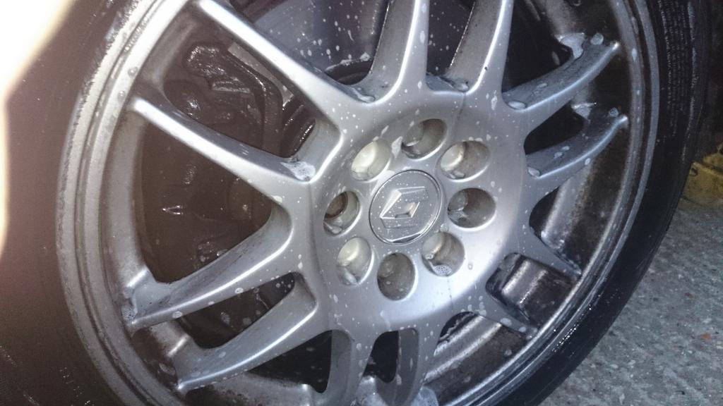

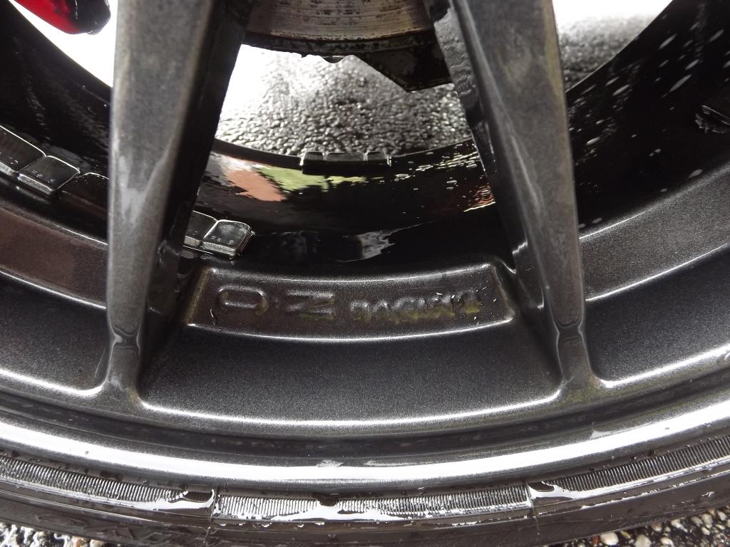

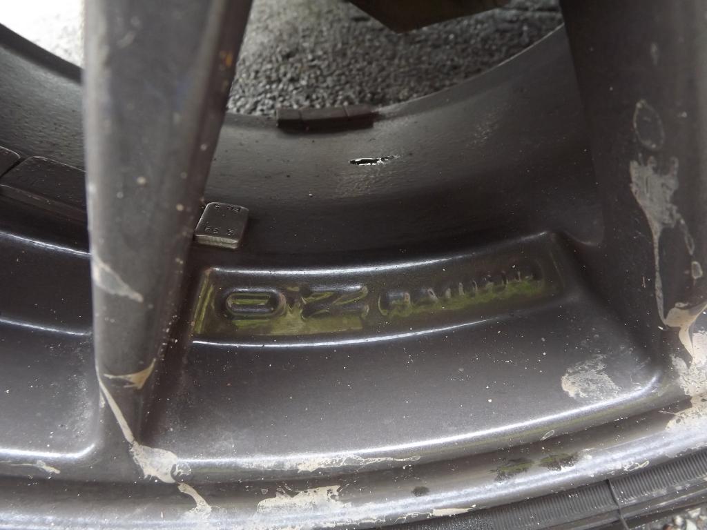

firstly a big thank you to Auto Finesse for another months test, my regulsr wheel cleaner is the tried and tested Bilberry, so the revised formula Imperial was recieved with interest.
i had hoped to use my dads new volvo as the test bed this month, but couldnt get the car, time and dirty wheels at the same time, so the Clios F1's it is. Appologises for the poor condition they are definately in need of a refurb!!
The car has been a little neglected recently so started with a tough test.
I diluted this approx 1:8-9 and gave the wheels a liberal covering.
Leaving the Imperial to dwell and get to work, as many others have said this clings well to the wheels and doesnt run straight off, i think a stronger dilution rate would have lead to even more clinging.
After a few minutes i gave the wheels an a good aggitating scrub and rinsed clean.
Given the heavy brake dust and road grime on the wheels at the start and without the pressure washer the test was a tough one and pleased to say the wheels came up surprisingly well. As stated the wheels are far from their best condition, the 'grime' in teh after pictures is the wheel and no poor reflection of the product.
il upload a further few images from another car also, but time was against me this month.
overall very pleased with the outcome and Imperial will be on my shopping list for sure.
