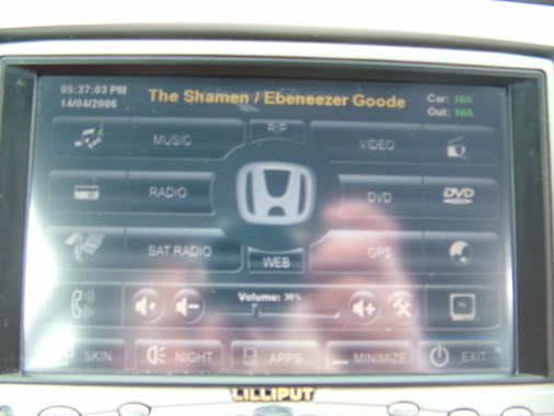

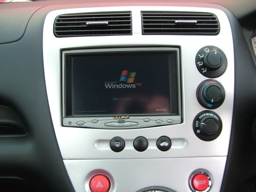

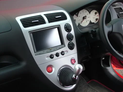

this was my old civic type r I used fibre glass and filler then sprayer the panel
I know you wanted to see it in a clio but had to show off a bit
i moulded a bracket into the panel so the screen popped into the bracket
it wasn't easy but i had a lot of time on my hands then
i still have the 12volt switching relay that switches the computer on when you turn the key it you are after one

the bracket came with the touch screen so it could be mounted in a head rest
I think i cut a hole into the panel slighty larger than the screen.
then covered the screen in masking tape and then greased the tape so it wouldn't stick to the filler and set it into the hole where i wanted it.
then mixed both fibre glass and filler together and used this to fill the gap around the front of the screen . I found it easier to sand when both were mixed and a very strong job.
remove screen from back of panel and sand the front until it looks the part :)
then mount the head rest bracket that came with my screen with more fibreglass to the back of the panel so the screen has a base to click into
