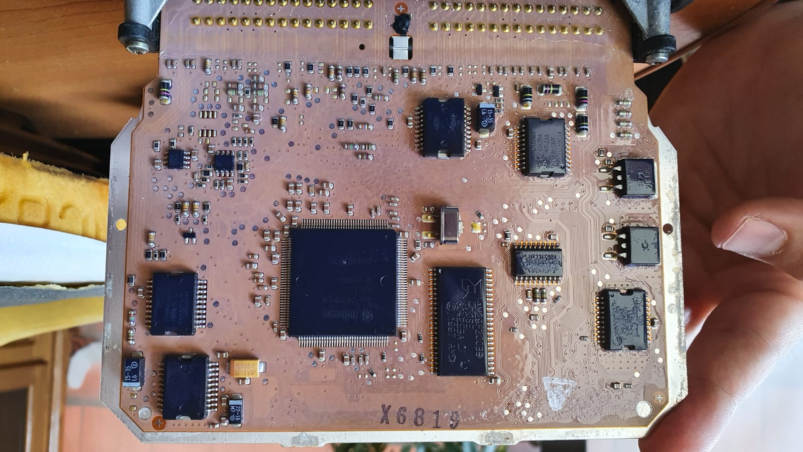

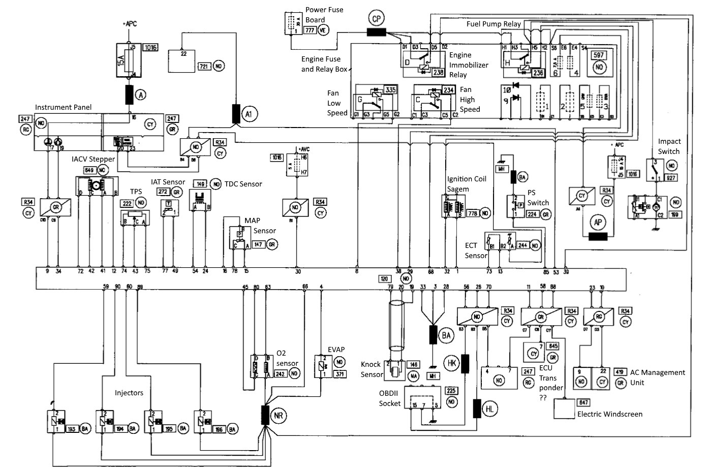

Hi all. I bought a clio 182 phase 2 that has a cable throttlebody with a changed ecu, which i think is from a clio 172 phase 1. I’m struggling to find a correct loom diagram because my obd port is dead. Currently the loom for the obd data are on pins 56 and 26. Unfortunately, i can’t identify the exact ecu computer because the case is from another car (daewoo matiz). I opened it up, and the pcb has an “x6819” code on it.
Any ideas?
