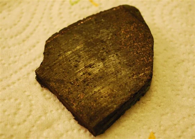

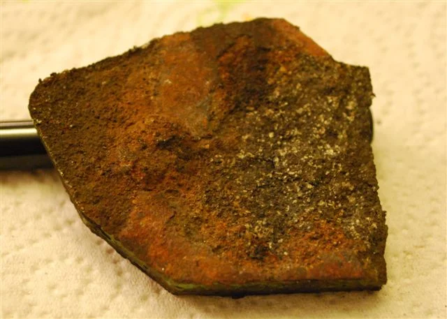

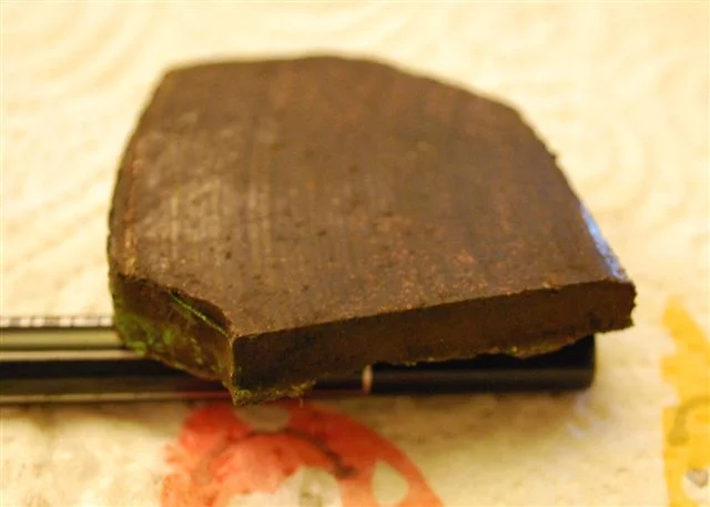

Stripped the 'offending' caliper down (after buying some tools, and using the Renault scissors Jack from the Boot Kit.. on a bit of a slope at the time too!).. and found one of my Greenstuff Pads had basically disintegrated!.
Might have been due to binding onto the Brake Disc causing the pad to overheat and crack.. OR it might have been the Pad cracking that was causing the binding in the first place!..
That looks nasty! Did you check the caliper to make sure the piston move freely? The ferrodo pads are good, but are more for track use than normal driving. I set of standard ferrodo pads from a local motorfactors will be great for normal driving, and should be overly expensive!
The Piston actually tracked back into the Caliper quite well, I only had a limited amount of tools, so only really cleaned up the Caliper as much as I could to get everything 'moving' again so I could get back up North on Monday..
The Pads seemed to be stuck hard against the thin Shim Plates at the Top & Bottom edges of the Pad / Caliper, so I took them out for the time being, gave everything a good clean and grease-up, and I'll venture back in there again this weekend to have a PROPER go at everything!.. New Cat-Back Exhaust System last week, Front Discs and Pads this week.. it is going to be a VERY tight month!.
