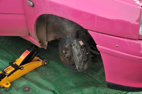

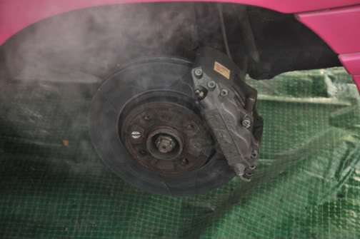

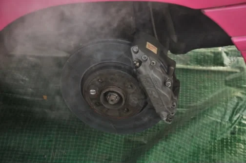

Pink clio rallycar Full report to come, were fighting for a class position and having the bleed the Alcons every 2 stages as the fluid was boiled dry after comming into the service area (flames were wisping off the pagid blue pads now pagid browns) and heat soaking them but wire on the throttle pot connector came loose and we went OTL so out the event with only 2 stages in the dark left to run :(

This was after the flames went out.....

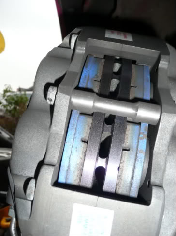

From new pagid blues to worn out browns in one event.!
