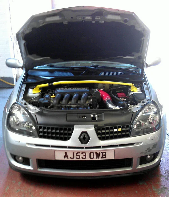

90 deg bend (beaded) is what you want, 63mm I think. 'AST silicone hoses' on ebay sell em £20. You don't really need a feed.
Dead easy - as long as you have the correct size battery.

Oh god now you're asking. I THINK it's 063 you should have. I had an 065 which was a bit too big. Best off doing a search to be sure though.
Pretty sure the KTEC ones use a ramair style foam filter so you're 2/3's of the way there!
