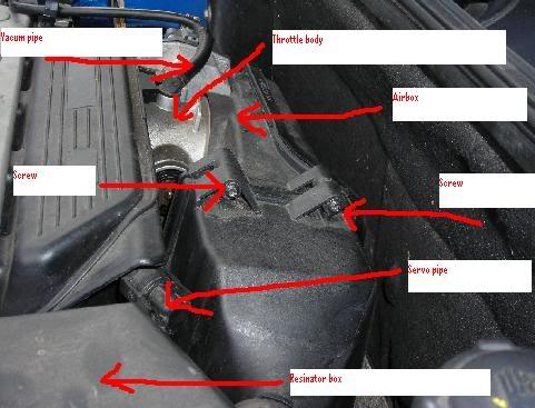

The peice your on about isnt the air box as such, its the filter housing. The airbox is the peice that is on the throtle body as seen in this picture.
Your induction kit should clamp directly onto the throttle body.
