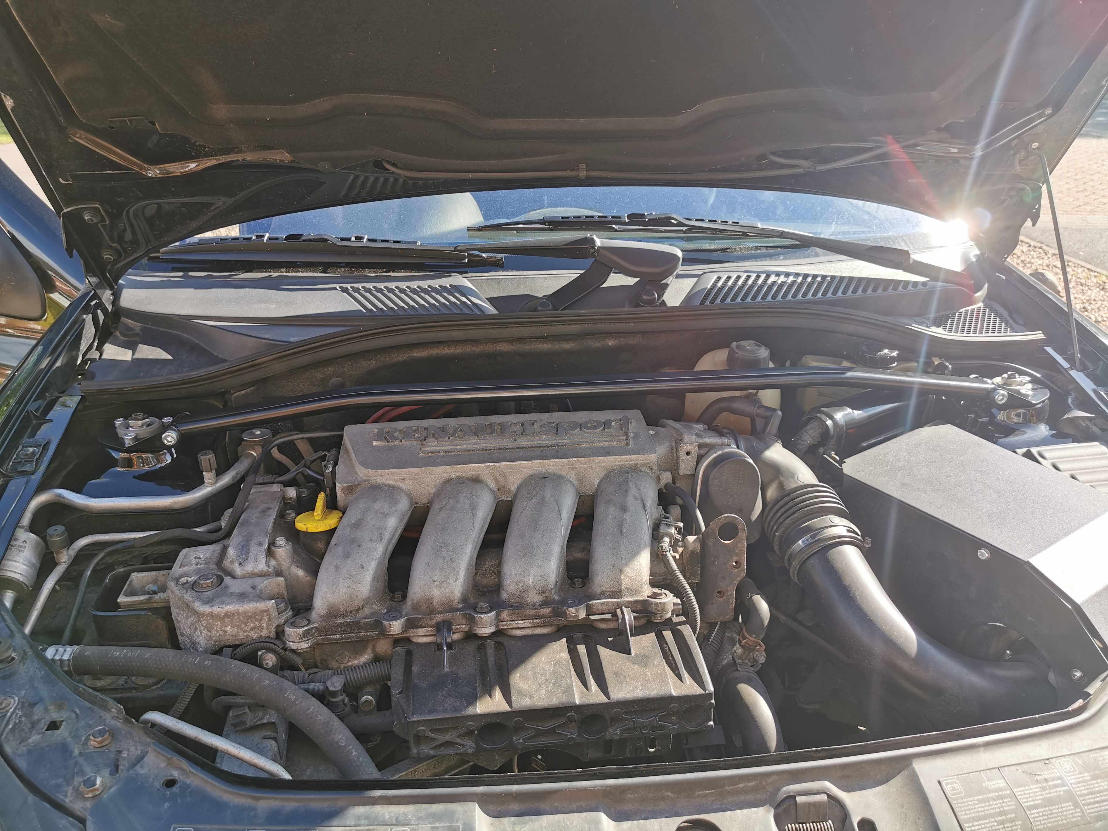

The fatty induction setup is great and way cheaper than any off the shelf set up. It'll not make it go any faster but it will make it feel faster with the amazing noise it makes. I painted the elbow black and with a battery cover it looked nicely oem.
Looks good. I took a quick look at the Fatty thread but unfortunately all the images and links are gone - I guess it's 10 years old so maybe they've been pulled down since.
