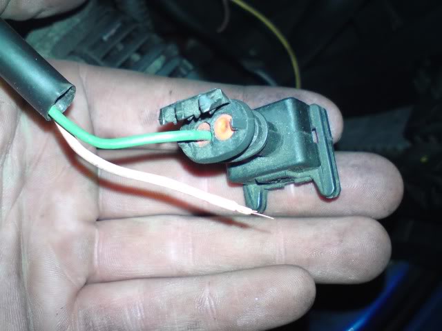

Does anyone know how i can re-attach this wire to the terminal that sits on top of the injector? Any help or ideas would be appreciated, here is a pic also :)

You would be better off going to a scap yard and snipping an injector conector off another car and soldering it on yours.
Solder has no place on a car unless its on a PCB!!
The connectors are called junior timers. You need a 2 Pin female JT connector.
The pins can be crimped with a standard timer/amp crimping tool or worst case a pair of pliers if you are very careful - note the pliered crimp won't be anywhere near as strong as a proper crimp. The outer should be properly retained in the rear of the crimp as well.
