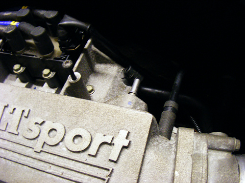

Basically i have carried out alot of work on my car over the last few months and eventually got it fired up tonight :cool: problem is im missing a couple of pipes that run off the inlet and it running like sh*t obviously!
so if someone with more brains than me can tell me what these 2 outlets should be joined to it would be very much appreciated!
i think this is from the old carbon canister so just needs blocked up?

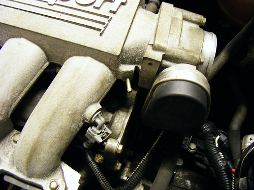

and this one i cant think for the life of me what it was :rolleyes:

second pic/ inlet pipe thingy, thats to your acoustic valve, just blank it off, it does absolutly naff all.
yep block both up, first one is carbon cannister, second is for the acoustic valve.
